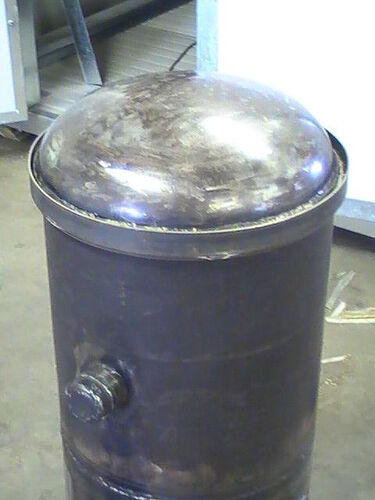

making lid rings by hand… I really need to get a ring roller… and a slip roller… and… and … and… and…
Maybe not as fast as with a roller but it looks really good Arvid!
AWESOME!
thanks guys…
The rollers make it easy but man, that looks great!

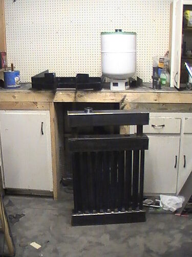

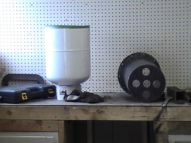

cooler sitting upside down… mount plate with cooler condensate tank resting on it… it will be connected via 2 1 1/2" pipes on unions. the modded propane tank on the counter is gonna be my final filter… once it’s done that is… the existing valve will be replaced with a quarter turn valve… can’t have too many places to collect and dump condensates from.
I hear that Arvid. Finding out from experience that you can’t have too many moisture dumps. Coming right along. Dan

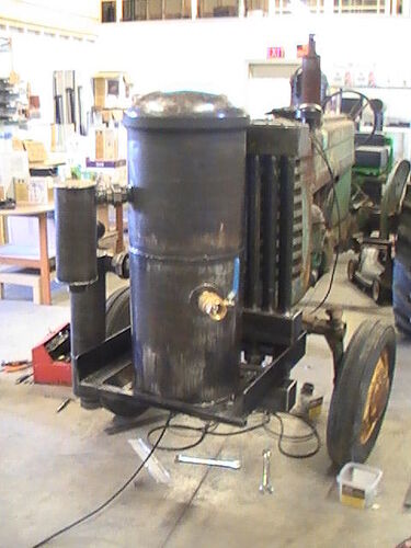

family portrait
Looks like a very nice unit Arvid, is the filter shown?
No Herb, it’s mia… still on the work bench… hoping to have it done tonight… yeah, I don’t take weekends off… or holidays it seems… Monday is a holiday here… maybe if I get enough done today I’ll reward myself.

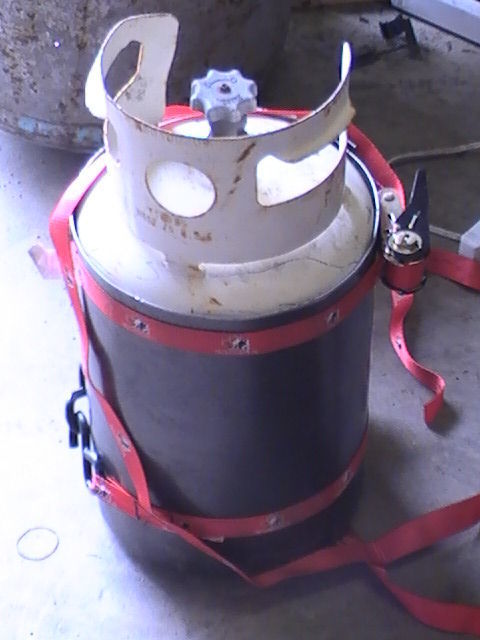

working on the filter… rolling a cylinder when you don’t have a slip roller… what a pain… slowly it’s coming together…
Gas will enter on the side near the top, tangentially, swirl around to the bottom and then come up through the filter media and exit out the top… or, at least that is the plan. I’ll have a 1/4 turn valve at the bottom so I can drain any condensate.
