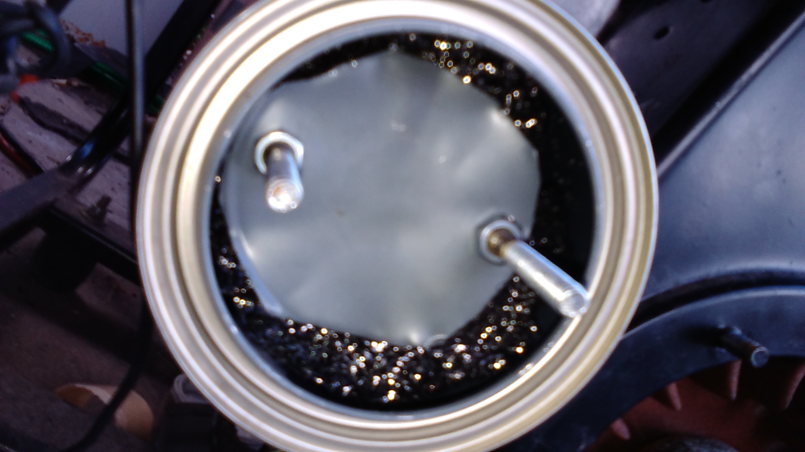

Just some notes… On my air intake I found that adding a extension to the freash air evened out the fuel supply pulsations cause by a one lung engine. Additionally I added a baffle in my pint paint can and put a screen on the carb connection side and filled the can with steel wool.

On the intake I used a quart metal paint can as my manafold but the metal was too thin and would not support the leverage applied by the metal fittings at the end. The stainless shaker was thick enough and looks cool too…

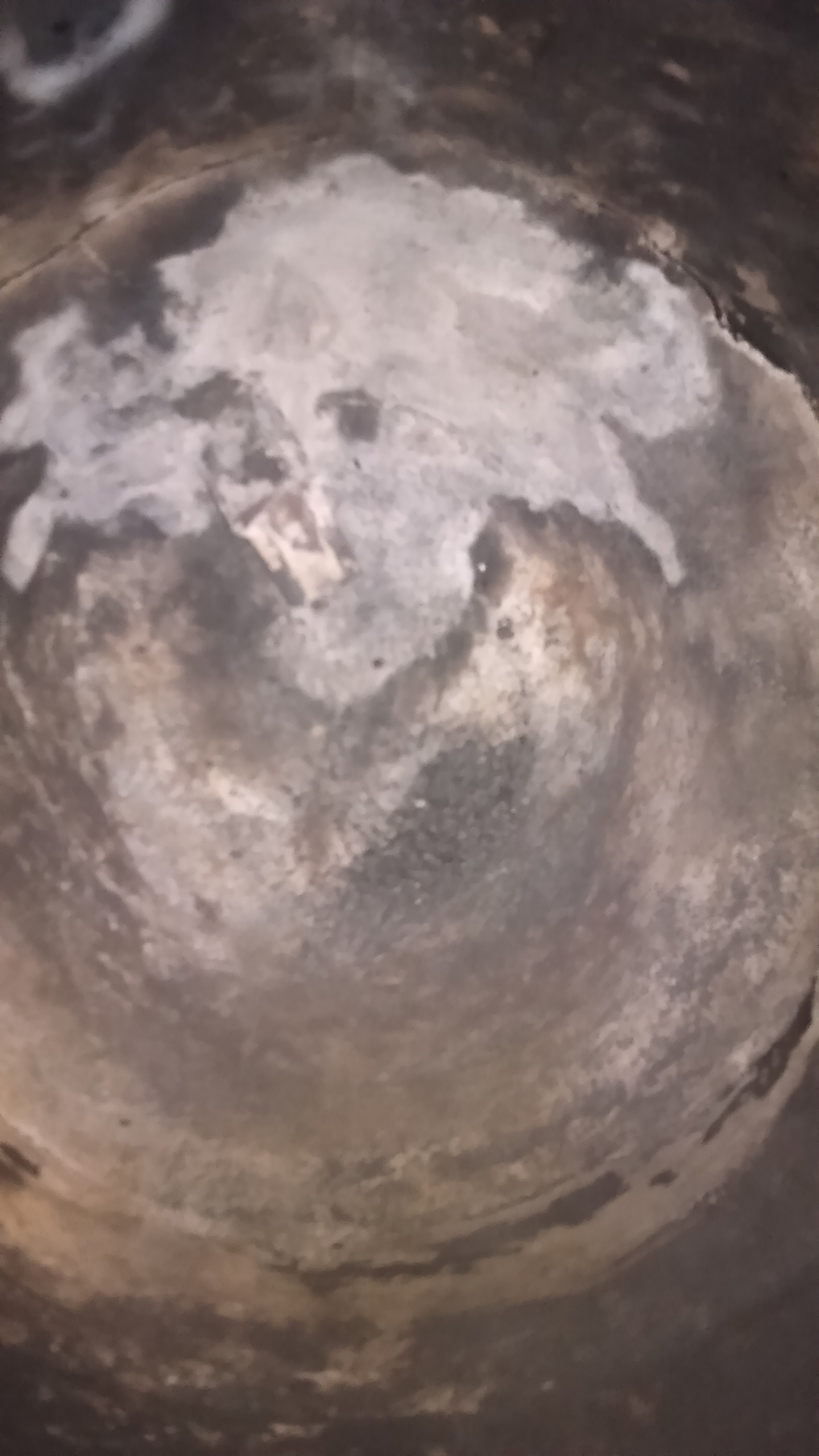

Sorry Tom I had to go back and reread my post to figure out the intake reference.. I didn’t like the way my intake looked because the tars, this was my first attempt at making charcoal and obviously I did not let it cook long enough to vaporize all the nastys out of the wood.
Because the design of the gasifier is updraft you have to ensure you have absolutely pure Carbon. I didn’t mainly due to feedstock issues of southern pine being the only wood I could get a hold of. Southern pine is full of SAP…
It killed me to see all that good useable fuel going up and to waste in the charcoal production as well, all of it would have broken down and made good useable fuel if it was pulled through a reduction zone.
