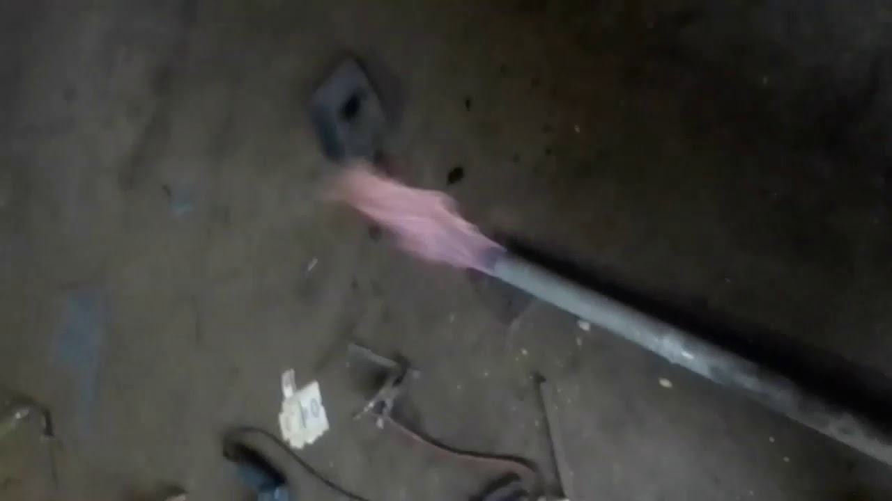

this gasifier is designed for an engine of 100-500 cubic centimeters, works on wood chips and sawdust. This is my work and it is built according to the old documents of the engineer Rybnikov and it works wel
Joni,
This is good work. Gas is mostly purple. Good.

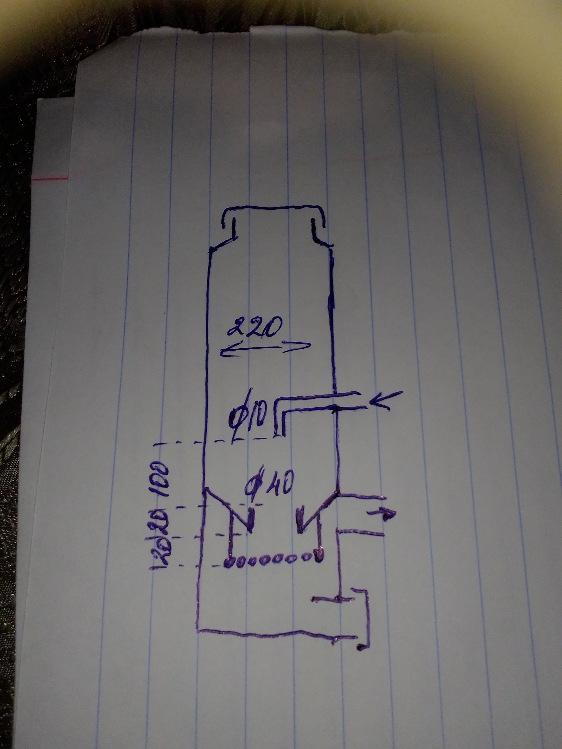

it is a gasgene with one air nozzle. in the video he has no filters at all. Guys, this is my video and I swear I myself was shocked by the color of the flame! Besides, such a system has a lot of advantages; it starts up in a couple of tens of seconds, runs on anything, gives a very high-calorie gas … I have the same only big one - for a car there.
Dualfuel,
A drawing of a gazgen with a video, do you want to see it ?!:woozy_face:
We all would like to see it please!
Yes sir.

This was the same design as Joni’s picture. Center feed tuyere, I routed the tuyere intake air through the ash box, under the grate. This chilled the gas coming off the grate, and preheated the incoming air.
Conclusion, Bridge City!!! It is better to have a ring of little tuyeres around the perimeter.
Hmmm. You might rethink this BruceJ.
While like you I like perimeter air jets best too . . . . I have seen in-real-metal; down center and up from bottom center work too.
How. Center feed but to the Sides out jetting. Not just a single straight down single big.
And one center up system the center up air feed rotated with the grate. With the side out drill openings rotating through the fuel stack. No channeling or void burning on that one.
Like all the actually gas demanded loading with it’s resultant heats-made always seem to be the best cure-all.
Fuel chunks bridging in your Tall . . . .
Lots of other reasons with solutions.

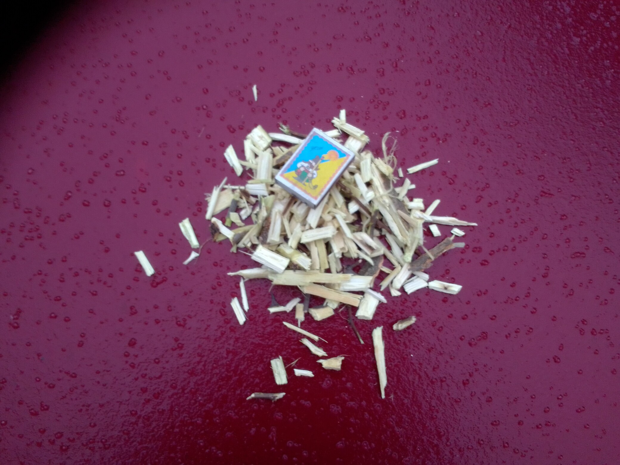

Please show us a picture of a fuel sample with a ruler in the picture.
