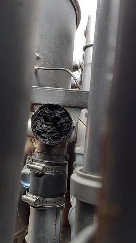

Coming home and shutting down yesterday I reached under the truck to give an annoying exhaust rattle plate a good beating. Doing so I grabbed one of the pipes going from the cyclone outlet towards the rear tank. Just as I grabbed it, it hit me - maybe I shouldn’t - could be hot. But it wasn’t - it was dead cold ??? Hm, plugged. I touched the other one and it was hot of course.
Being hot and dry I have never flushed these two pipes - in over 3 years and 16,000 miles. But I actually suspected something like this was going on because I lost my rail temp reading about a week ago. Plugged pipe below.

That plugged pipe looks like it could be a problem, LOL.
