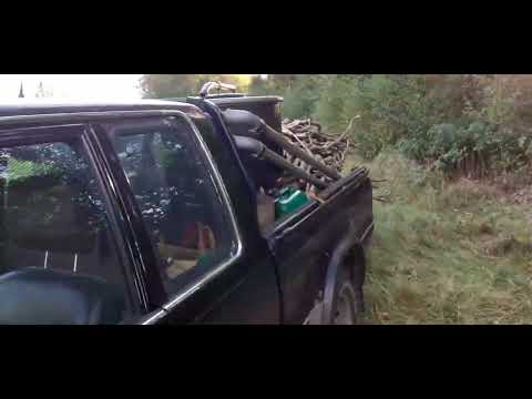

That hole is where I placed fuel cutoff solenoid switch ![]()
Also, how exactly is your cooling rail flowing on this truck? Is it forcing the gas to go through one pipe at a time or is it a sort of split flow?
Edit: it’s been a while since I’ve read through this but did you leave the gasifier as grateless or did you add a grate later on?
Cody, on the Mazda pickup two pipes feed the rear tank and the gas climbs from there in 4 rails in parallell, drops behind the cab and enter the hayfilter bottom. I wanted the rear tank to be somewhat heated for winter temps.
The gasifier is still grateless. Everything is exactly the way I built it in 2017-18, except a larger choke and a fresh inner hopper/funnel.
I shut the gasifier down an hour ago after delivering a trailer of firewood to my fathers place ![]()
So that’s one reason why your pipes have a more drastic angle, to promote it to fall back into the tank.
So in a way your condensate tank is like a drop box after your cyclone? Very interesting.
That’s right. It catches quite a lot of soot, which the cooling rails don’t need to deal with.
