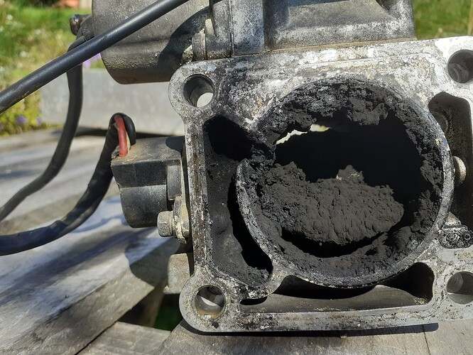

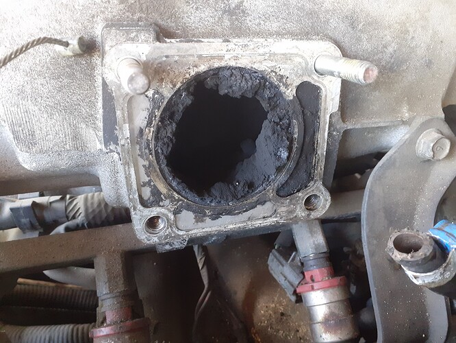

Well, this post would fit in the what not to do category - lack of maintence.
Lately I’ve had several intake events happening. Sudden blue smoke in the rear view mirror accompanied by severe valve noice for a while - lumps of soot letting go - and this is a 3 valve per cylinder interference engine.
It’s been probably since fall when I last removed the throttlebody. Stupidity.
This is what the downstream side of the tb looked like. Also, the intake needs vacuuming.
