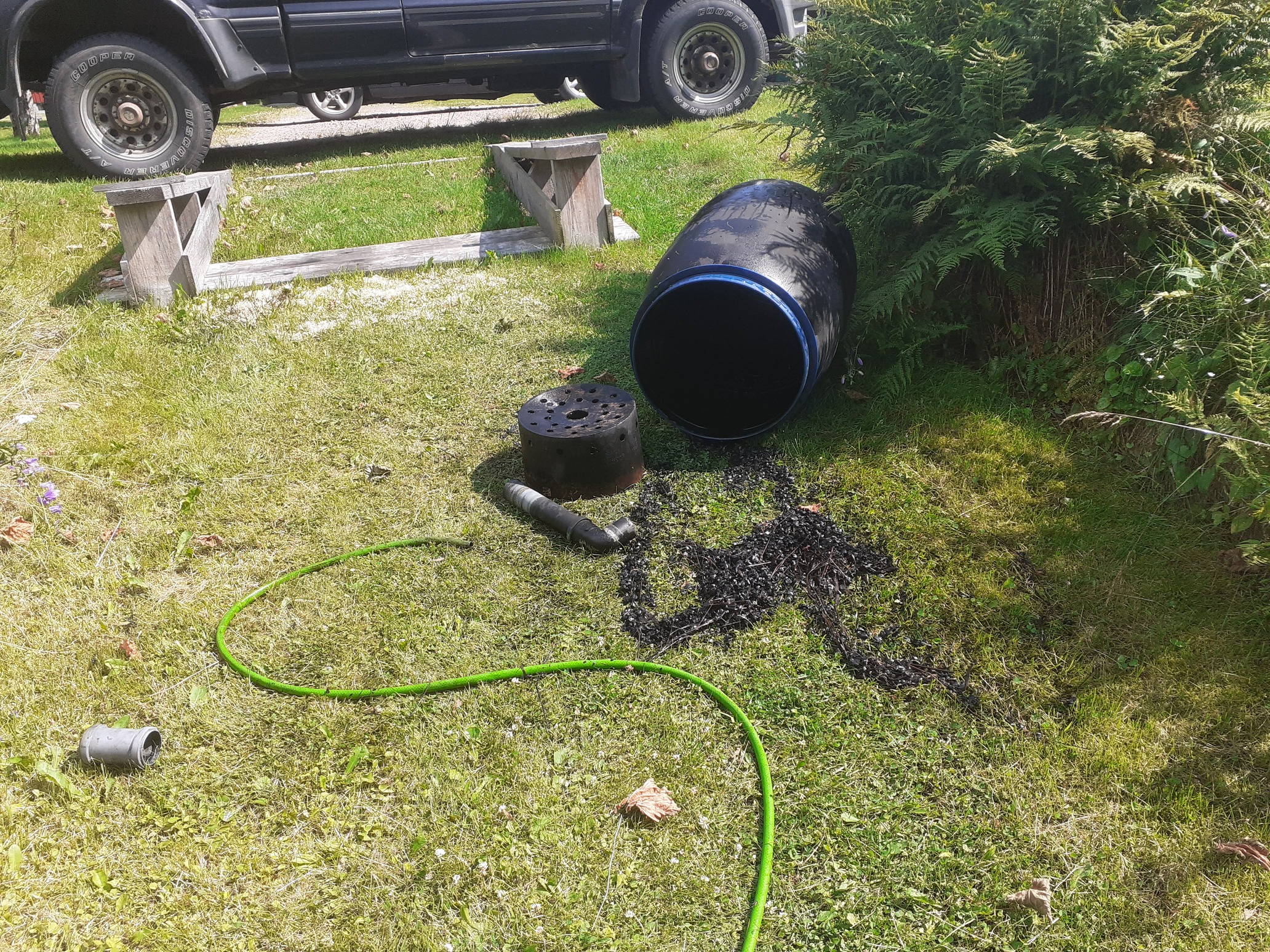

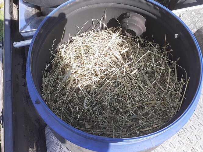

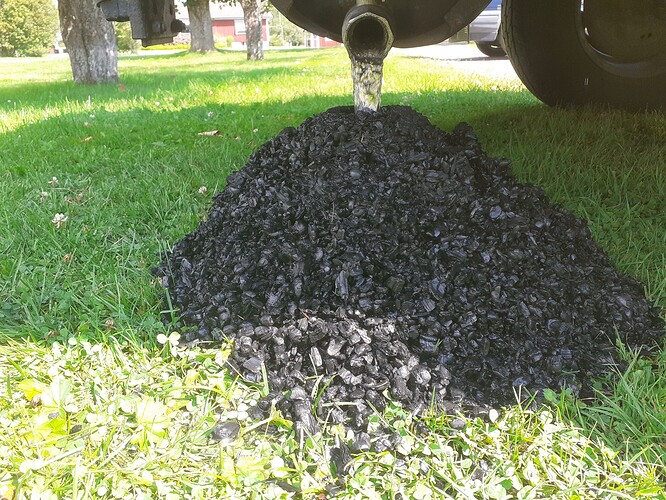

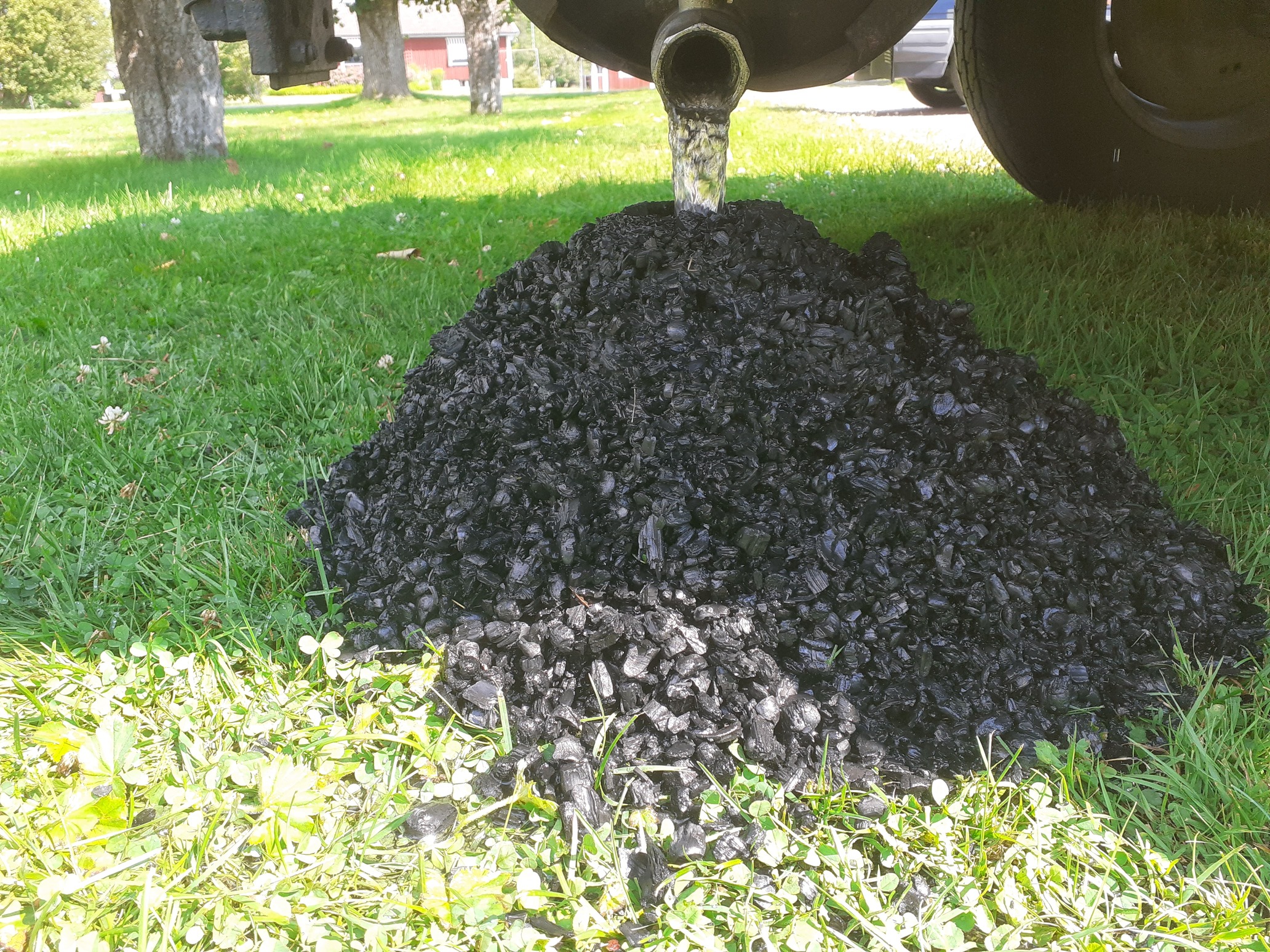

While messing with the intake soot I took the oppertunity to do some additional maintence - flushing all the pipes and some fresh hay. The cyclone has apparently been running full resently. Found a lot of char in both rear tank and the bottom of the hay filter. Fun, fun.
JO, no summer swimming in the lake with a hay filter this year? :smiley:
Tone, I’ve been swimming but without the filter barrel :smile:
Wow, that’s what I call a flush and charcoal cleanout.
