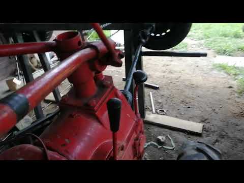

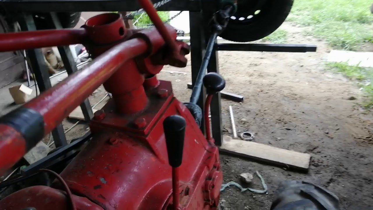

Here she goes! Just a test run, no sawing. It seems to do just fine. I did however notice both wheels wobled some. Possibly weld distortion on the axis. Took me about half a hour, a 10 pound hammer and some Serbian language but l got them straight prety good. Now it runs even smoother, much less vibration too.

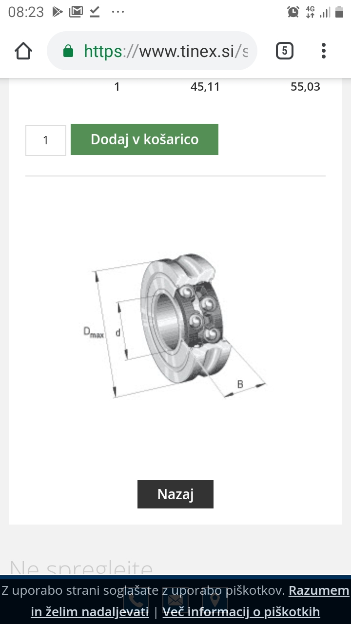

I found the perfect thing.
But the price!! 55âŹ!! Thats insane for a simple 2" bearing with a groove.
Plan B. I will put on normal bearings and 2 on each side of the track to prevent the cart derailing.
One angle iron and one flat?
Angle with point up keeps track. Need two bearings. Flat just one
