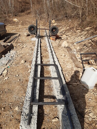

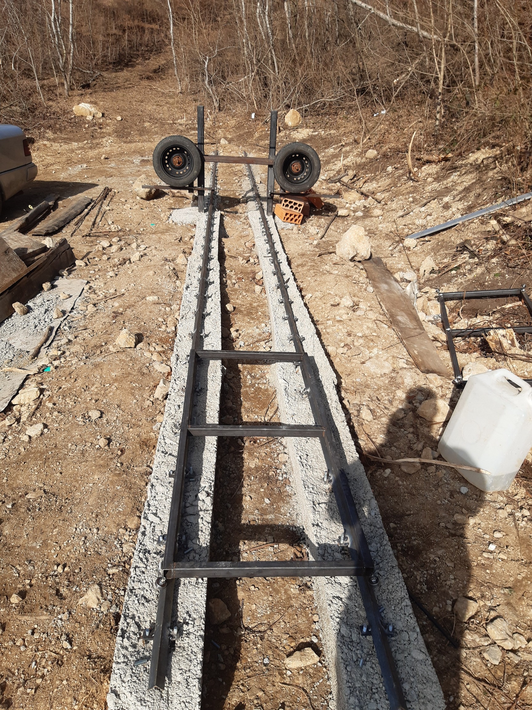

Here is a look at my junkyard saw mill .
Hard for me to believe it has been going for 21 years .

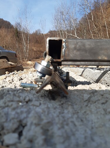

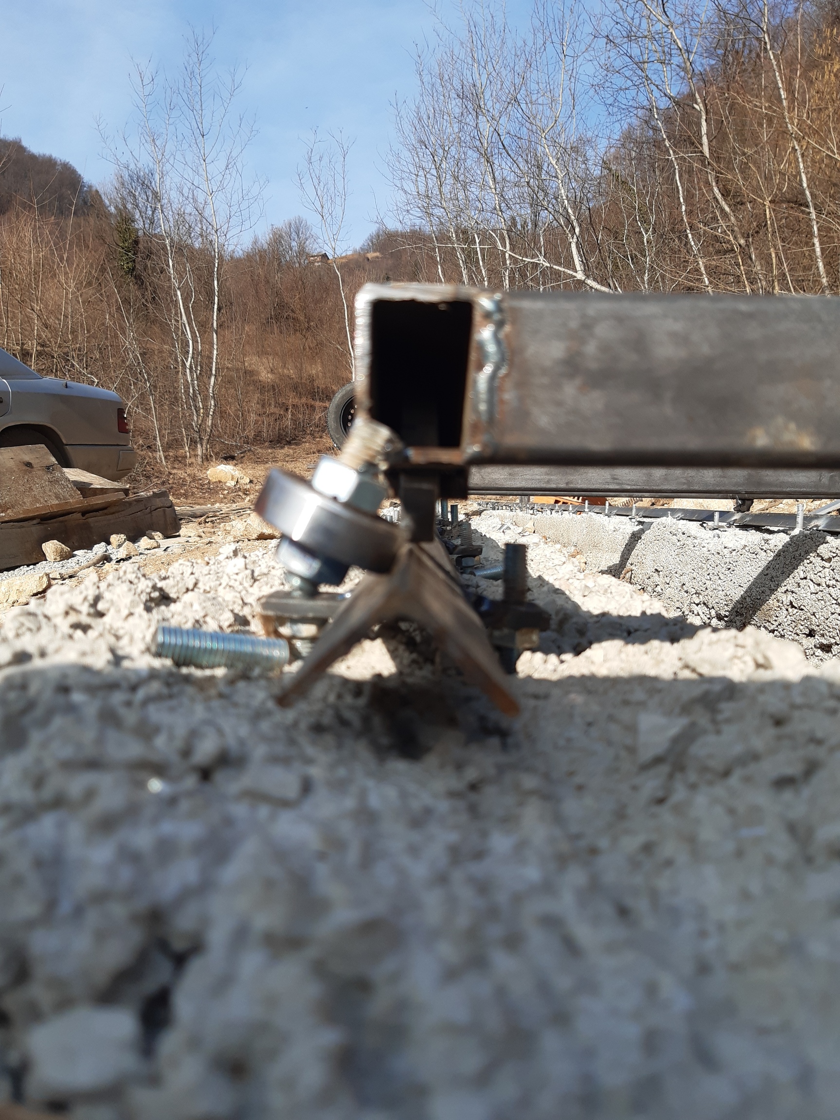

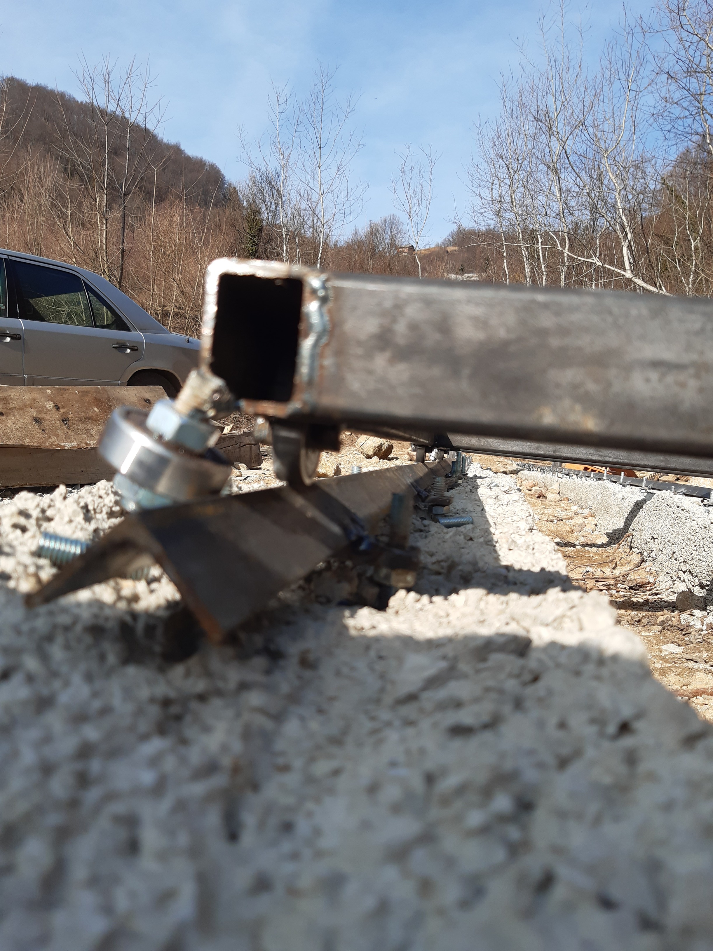

Might have to access a lathe, and turn some wheels to match an angle iron, push fit on a standard bearing.
Sawdust can build up on wheels and track, plastic scrapers on the carriage can help clear the track, possibly small grooves in rollers could help, maybe not as necessary though, close set plastic scrapers should keep things rolling smoothly for the most part.
Maybe something like garage door pulley:
Seems to work very well, how have you done to raise and lower the saw?

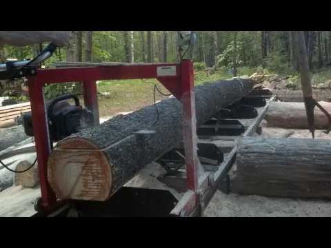

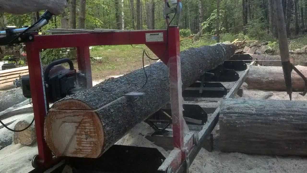

Jan, do have a picture of your chainsaw mill?
It looks like this, though I have one with an electric motor.

The saw head is raised and lowered by small roller chain and sprockets . The truck steering wheel that I am turning does this .

This is how l made the wheels
If l wuld buy original wheels, it wuld set me back 400$. This solution cost me 25$. Hope it works.
