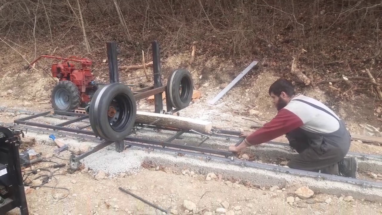

This is the first plank l ever sawed! Its a thin cottonwood log but a proof of concept nevertheless. The mill nor the tracks are not yet 100% adjusted and there are still some things to be modifyed/added but it seems it will work fine.
Not gonna lie, l am not esyaly scared but this thing is scary. I definitly need protection over the wheels and pto.
The wind was out of this world today. Look at the leaves that fly like bullets. But that culdnt stop some testing!

On my mill I have a rule that me or anyone else are in front of the blade while it is in operation . I am always on the back side of the blade .
If the blade happens to jump off the tires it could be bad .

What kind of a life expectancy can l expect from blades? Its a woodmizer blade. How long between sharpenings?
Hello Kristijan
The amount of wood you saw before sharpening will depend on some factor but mostly how clean the logs are .
If I am sawing clean pine logs I would expect to saw about a thousand board feet of wood before the first very light sharpening. I usually sharpen 3-4 times and then discard.
A sharp blade is very important . My rule of thumbs if I can change the blade out without bleeding it is too dull :grinning:
Makes sence.
Do you sharpen them your self?
Ha, l remember you mentioning that :smile: the blade l have is new but personaly it doesent seem sharp at all. But ĂŹt does seem to cut ok. I will see what time brings

I second what Wayne says about being behind the blade, even with guards on. Even the sides are dangerous.
How good does it feel to be able to make your own boards? You are an impressive young man.
Don’t know much about sawmilling. I think you will want to add a water drip to cool and lube the blade. “way-out west blow-in blog” Tim has a similiar set-up. He arranged the grooves in the tires to let the toothed (set) part of the blade to run in a groove of the tire tread to make the blade last longer.

I don’t us my blade setter anymore but if you want to make one maybe you could get some ideas here .
Bill, it feels great. Opens so much opertunitys to live off your land.
Mike, yes, the water drip is one thing still missing.
Thank you Wayne, this was helpfull. I tryed to remember as much as l culd from our visit at your place but the amount of information was too much for this simple brain of mine.

Water drip is only needed to clean off sap buildup on blades. Most hardwoods should be no problem, spruce and pine are the troublesome species.
I use a squat bottle with some diesel fuel for that but I suspect some of that runoff from charcoal would work just as well.
