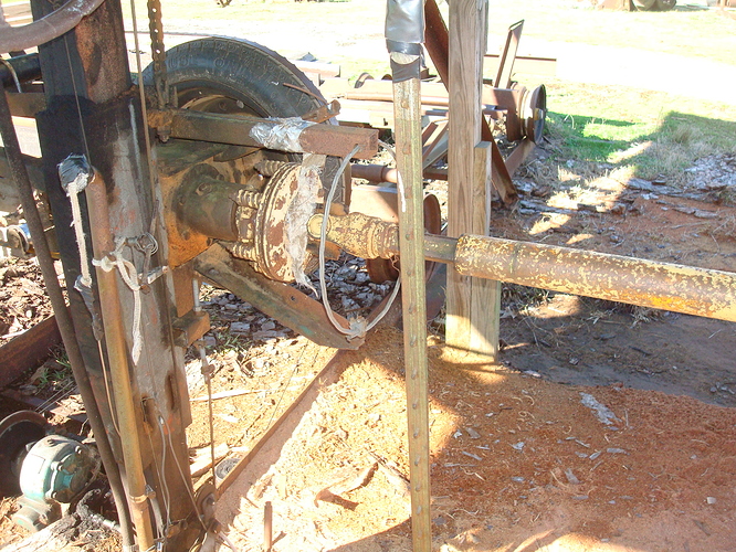

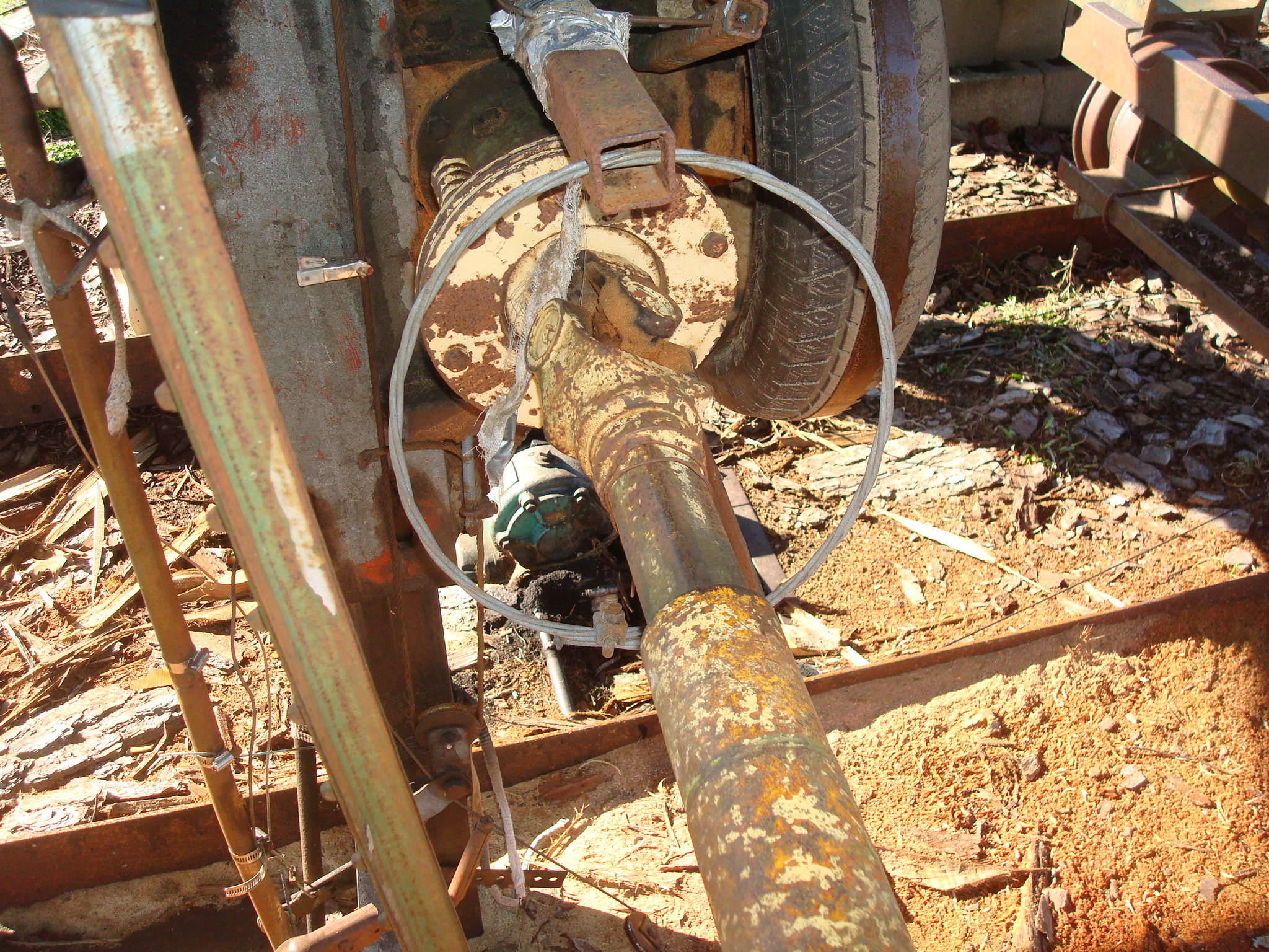

On one other note I noticed your having to work near your PTO shaft that includes a universal joint.

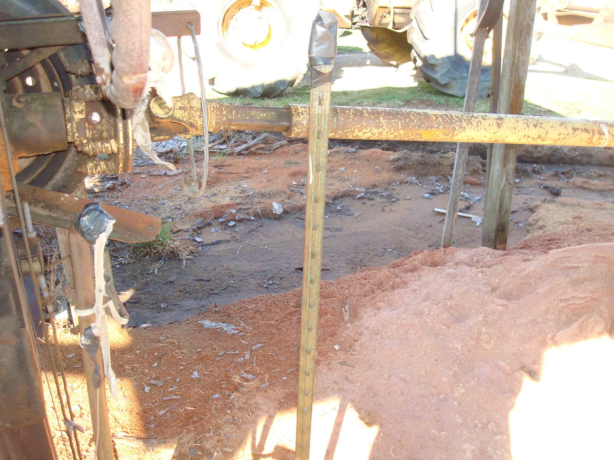

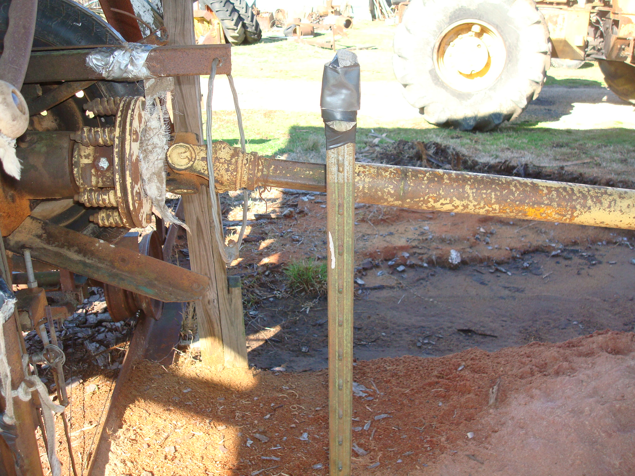

I wanted to show a couple of pics of my PTO shaft. You might say I am somewhat of a coward when having to work close to them if they have a U joint or shear bolt.
I have a fence post driven in the ground and stands close to the PTO shaft . Also a cable loop around the shaft. If the shear bolt or U joint gives way I hope the above will give me a half second to get out of the way.

I really enjoyed seeing the two wheel tractor power your mill ! !
I also agree with Wayne. Keep safe and sound.
The pto scares me allso, l figured later l will build a wall between the pto and the track, and “hope for the best” untill sawing lumber for the building, but now thinking about it, that is kinda stupid. I will coppy your idea untill l finish with a permanent structure. Thanks for the help and concern.

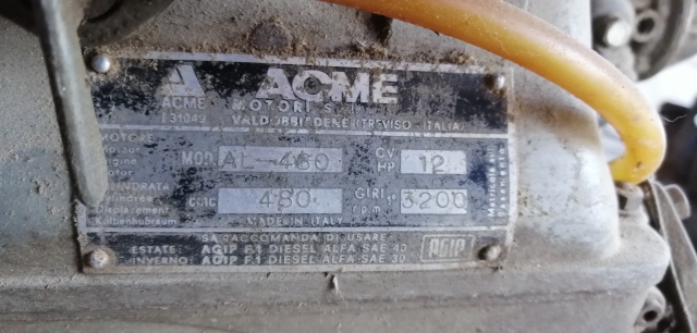

This is a ACME 8hp engine. Max rpm 3200. Unfortunaly that is all the table on the engine says.
I know a similar ACME engine with 14 or so hp on a BCS hay cutter has 550ccm. But l have no idea what the displacement on my 8hp is. Has anyone got a idea? I know @Chris mentioned he has them at work…

How about a PVC tube to guard the shaft?
For 8hp it might work. But with a bigger tractor the PVC would simply shatter expecally in the cold. My mower simply has a metal box around the end of the shaft so when the I joint explodes it will contain the mess it is 100 hp on the shaft and about half inch plate. Just remember to keep access for grease fitting when you add guarding or you will be pissed later. I like lock collars which allow me to slip off the shaft for mantaince and then slip it back on without tools or removing guarding.
What model ACME is it? I can find specs and probably a service manual.
Chris, it says AL 75 on the engine. 8 hp
I think I found it…

The truth is different thugh. Those engines are tough. Father in law has a BCS hay cutter with a ACME that runs for over 40 years without a defect, runing allmost non stop in the 70s and 80s. Cuting hay at days and harvesting grain at night.
I was wrong, this is its specs of the BCS engine
There were allso 18 hp engines. Now, if a 12hp or a 18hp wuld happen to fit in place of my 8hp engine that is allso a possibility… waiting for @Chris with the specs first.
