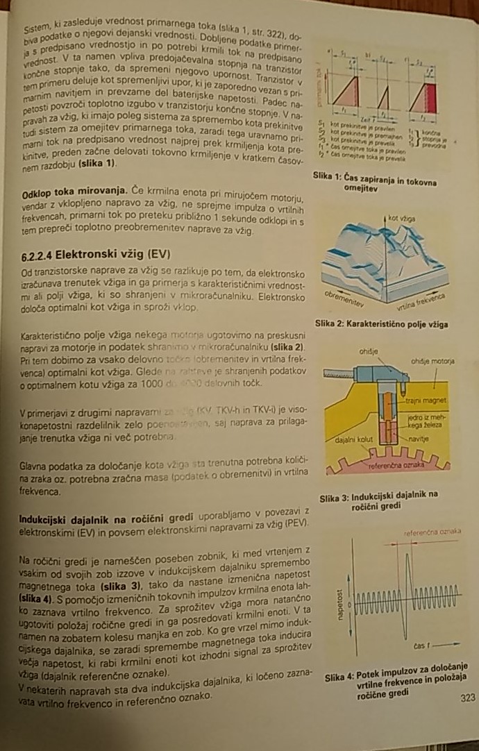

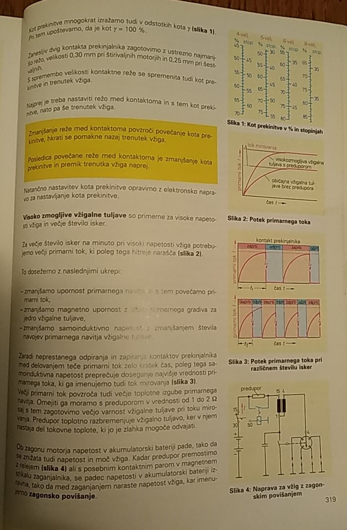

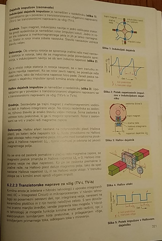

Engine is home. The donor car was a Proton, and google says the engine is a Magma megavalve 12v made by Mitsubishi. Looks good but it has mpfi and electronic spark distribution. I was unable to sorce the “brain” for this engie so some “Wayne Keith” style engeneering will take part.
Best l culd fiind out is the dist has a cam position sensor and a ignition coil built in one pack but is turnable.
My thinking is l could make a simple transistor circuit that would pick up the signal from cam position sensor and send current in the ignition coil. Its probably gonna be a spent spark system but that doesent matter. And one fixed timing wich doesent matter on a fixed rpm engine…
Any ides, will this work???
Yes. Can be made to work.
Use flywheel steel pins for each cylinder. Magnetically triggering the simplest coil amplifier brain available to you.
I put up conversion link on another topic using USA 1970/80 auto amplifiers.
Search for this.

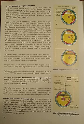

So you suggest not to use the original cam sensor at all and just make my own? Or had you had in mind l actualy make a kind of magneto ignition?
Any idea wich topic it was?
Edit. I see what you mean now.
Article was on the;
www.gardentractorpullingtips.com/ignition.htm
Scroll down to magnetic and Hall sensors using GM/Chrysler/Ford ignition amplfiers.
Same could be done with Euro amplifiers.
All of the old had internal 10 degree timing features.
ADVANCED multicyclinder distributorless types you sensor/pin set ~45 or 60 degrees before your spark and electronically calculates a spark initiation lag from that.

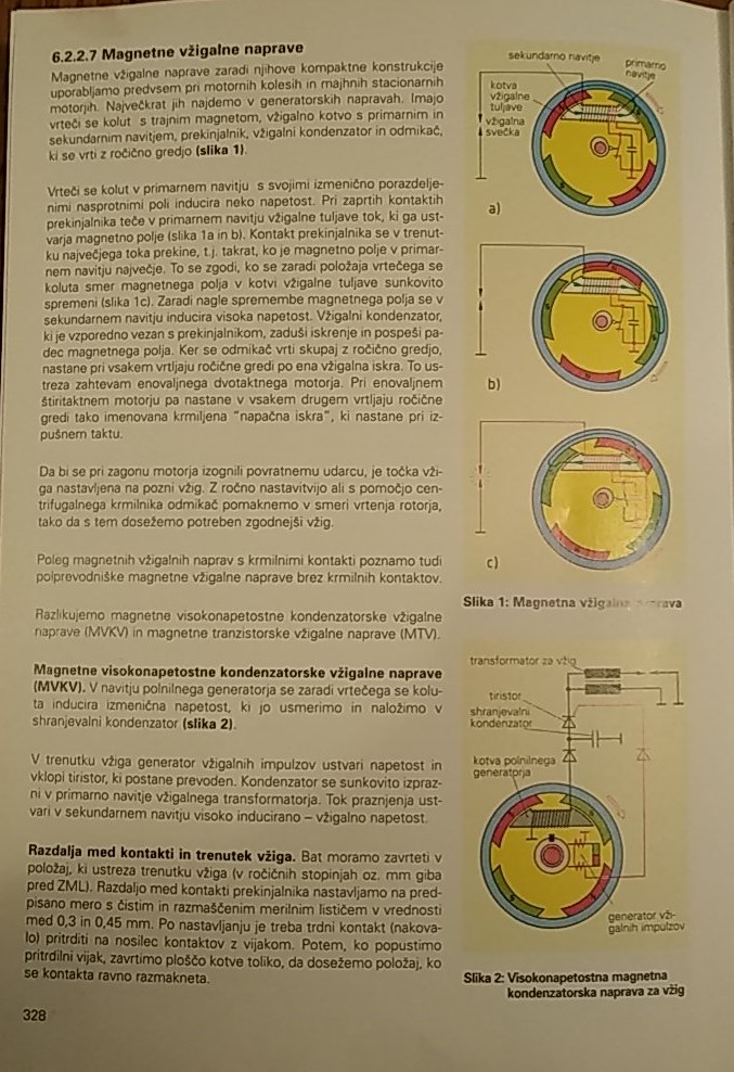

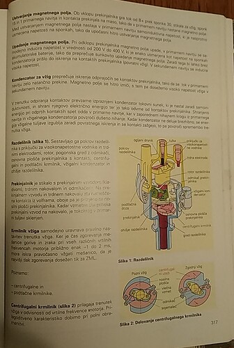

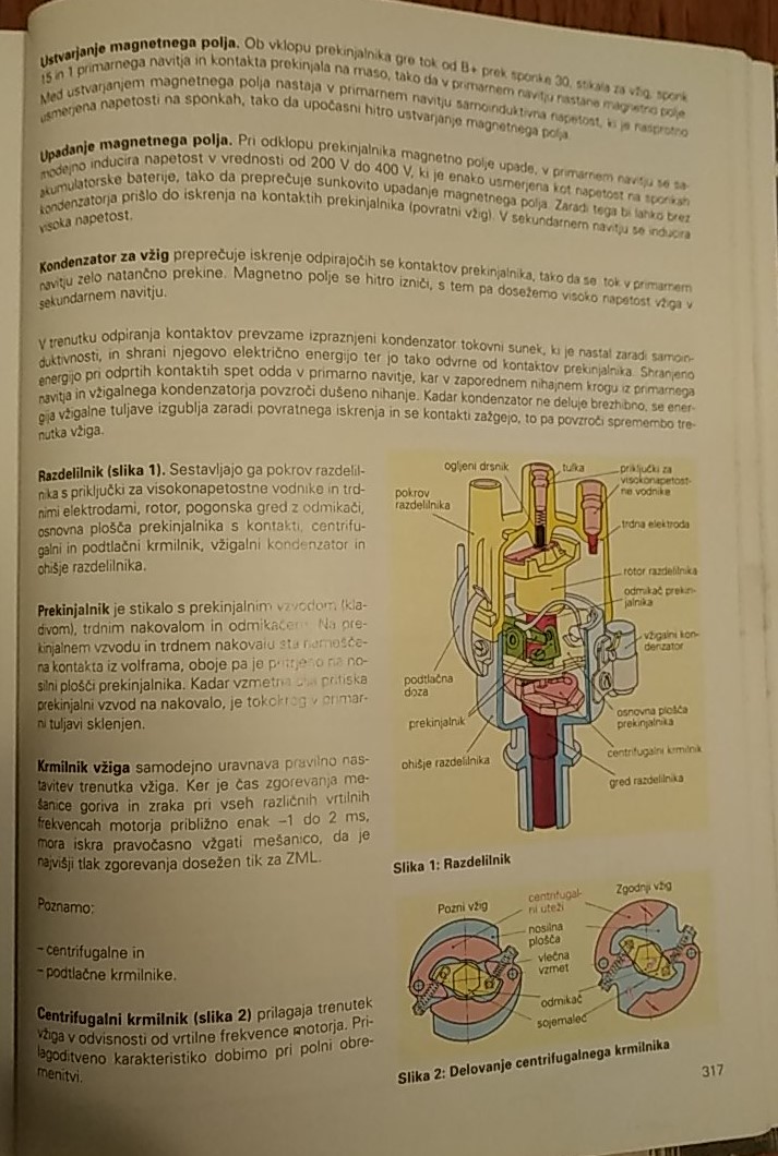

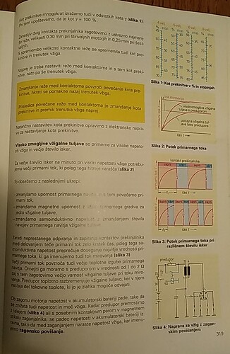

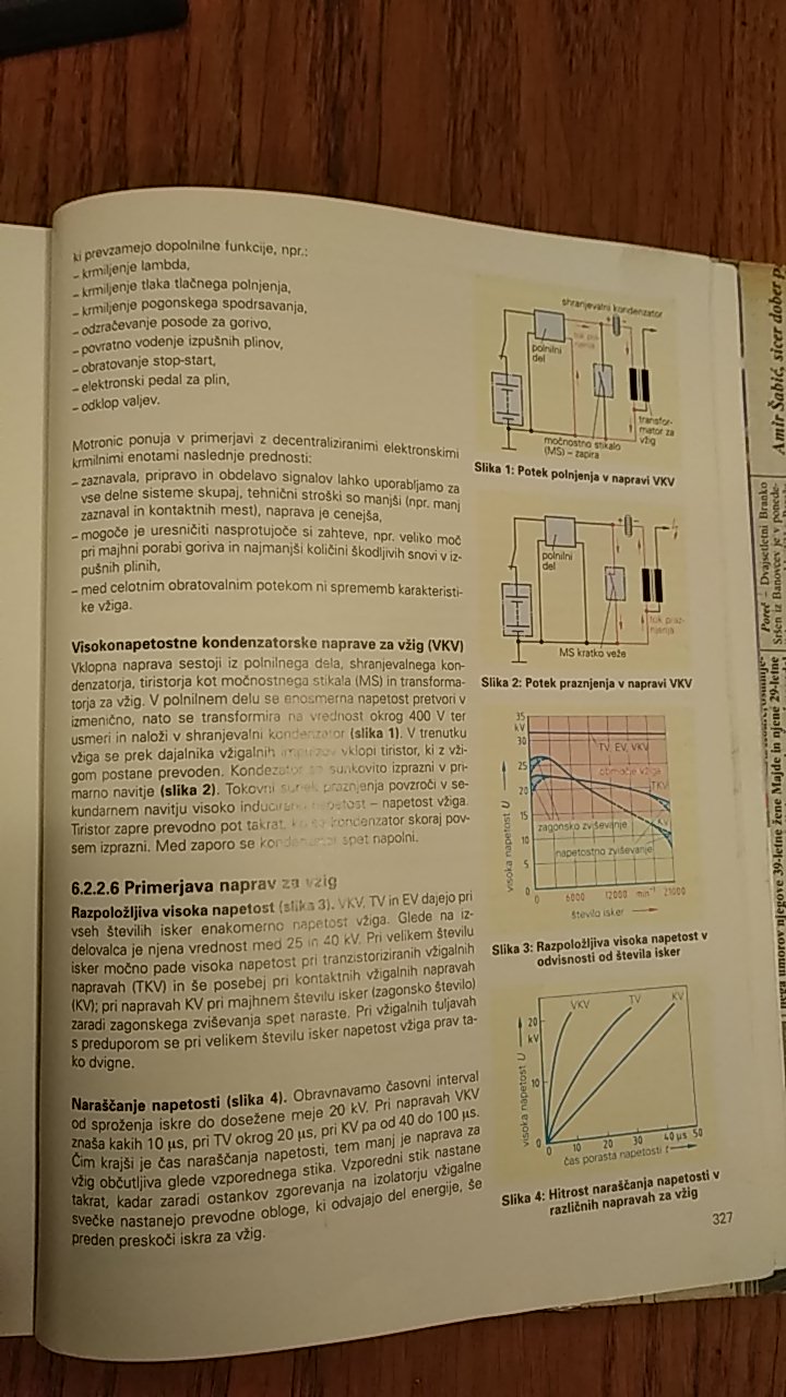

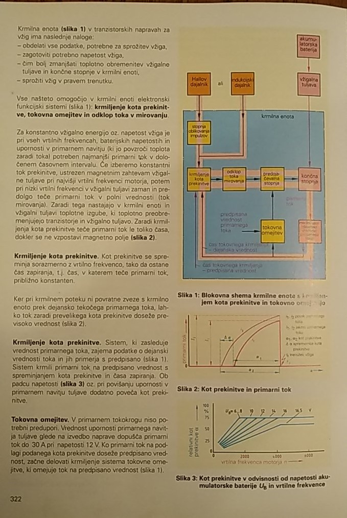

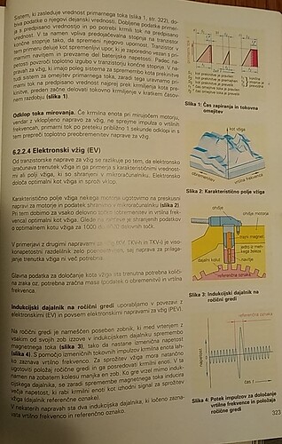

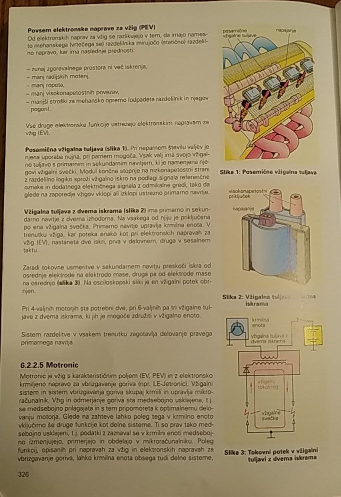

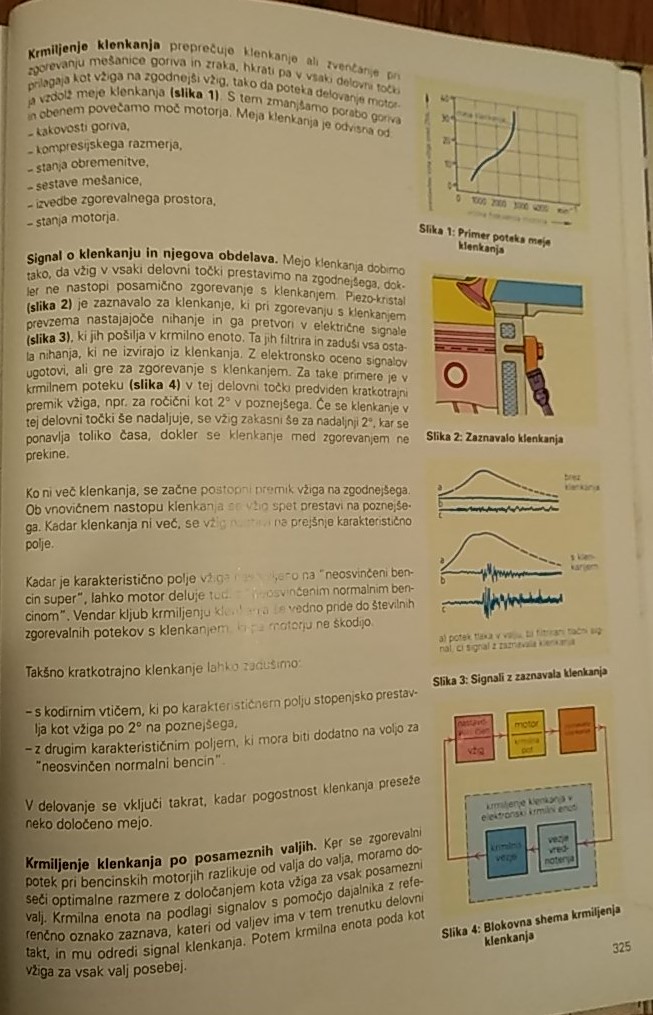

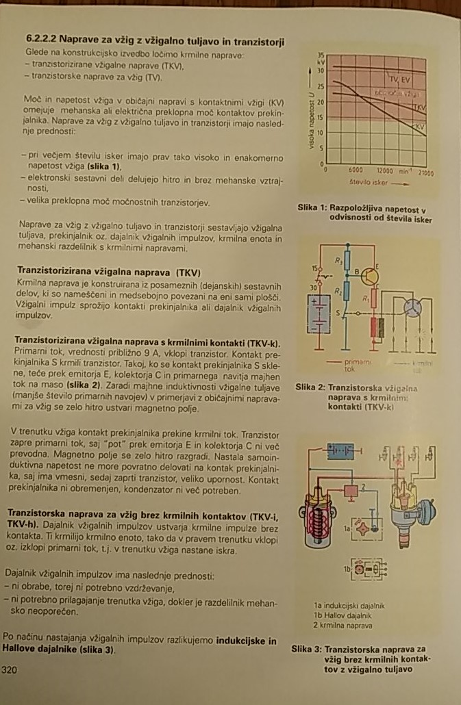

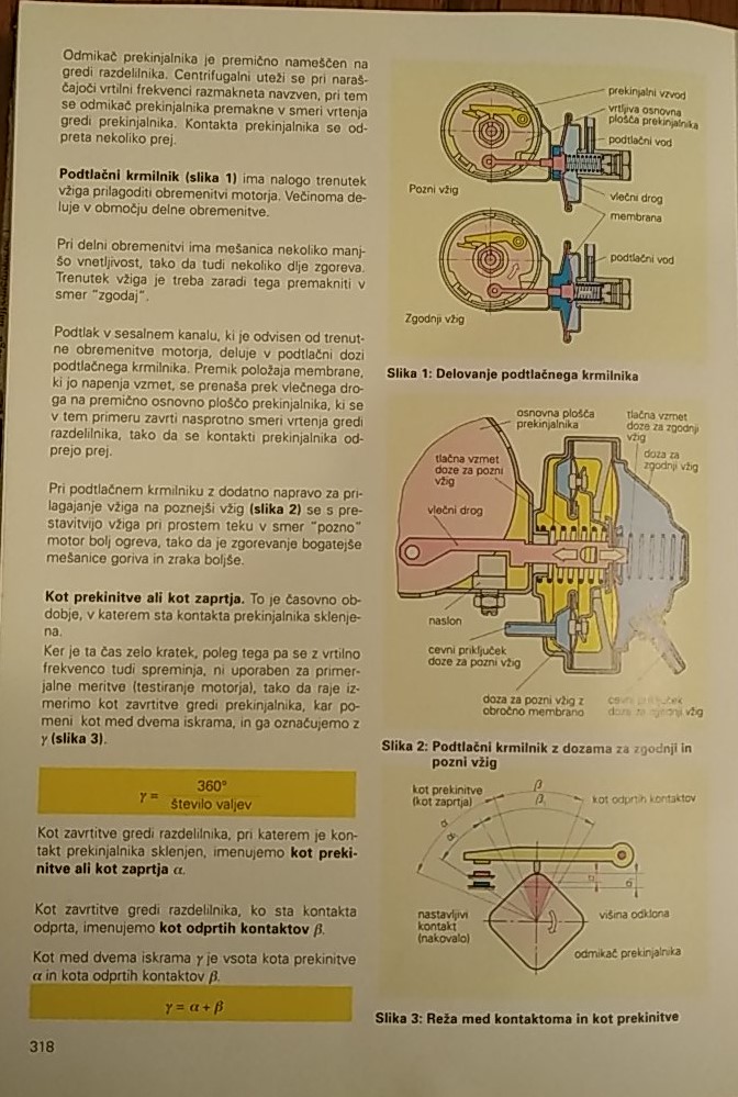

Kristjan, mislim da brez motornega računalnika ne bo šlo…
Christian, I don’t think it will be possible without a motor computer …!
Hello. I am back.
Since you only want to sawmill run you will only need 2-3 spark timing sets.
Cranking to start.
Started idle running.
Power RPM.
The old 1st generation ignition amplifiers can give you a switched two of these.
From a single magnetic or Hall sensor you get two ~10 degrees apart with a amplfier single wire change.
Using a coil per cylinder would need an amplifier and sensor per cylinder.
Two output coil-pac types? Then only two amplifiers with sensors.
Your third timing set could be from a separate switched-over-to positioned sensor. Or . . .running movable sensor.
Really search up this article and you see a Hall effect triggers system would be best.
More precise. Playing with cutout notches then.
Or four small four stroke unicoils pacs; with one to each cylinder; triggered by it’s own sensor.
The large engined Honda, Kohler, B&S single cylinder unicoils have three timing advances built within them.
They count the sensor pulses to calculate RPM and step jump the timing advances.
All of these system being battery powered.
