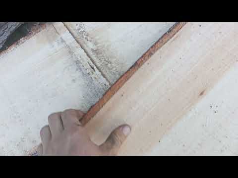

Kristijan, are those boards meant for siding? (Outer wall?)
Un-edged boards up here translates to something like âwilderness panelâ. They are more expensive than regular boards. Probably because all the motor fuel still remains

Thatâs a big market here to, they call it live edge slabs and popular for counter tops tables and night stands for a ârusticâ look
The same overhere. Used wood is more expensive than new. And hot! Since 15 years wood from construction sites it used to make garden furniture. Now, after 15 years its a species like willow oak meranti etc. Grazy. Some construction company was giving new wood to brick layers every month so they got the used ones. Upside down
When I was still building houses we had one customer that we build four houses for. He wanted them all sided with the slabs from the saw logs. Had a deal with some mill to cut from the side before they squared the tops and bottoms. Came with a semi load of them all six inches thick. At first I was reluctant to mess with them since it required setting them with long 5/16 lags that were hidden in the chinking joints, but once we got to doing them they looked just like natural logs. It was kind of a pain to get the corners mitered right. Houses came out great. It was before we had digital camera so I never got pictures. He did all the chinking himself with something that came in large caulk tubes.

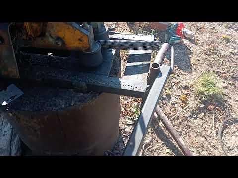

Don, this is for you.
The engine slides back and forth, on a track. This serves as a clutch. Else is spring tension.
Nice! Thanks. That is slicker than snot.
A real simple system, I like it
