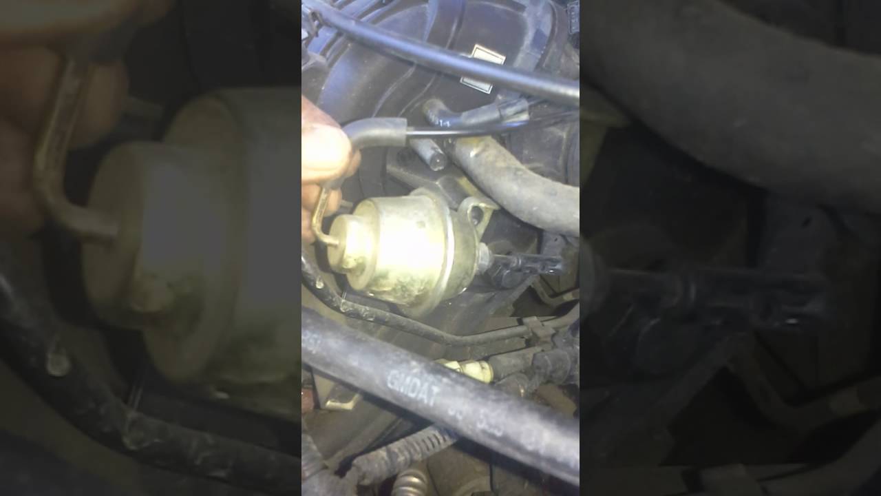

Ok guys l need some help identifying some engine parts. Instead of takeing pictures l took a short video.
The first part is what apears to be s vacuum diafragm of some kind, althugh it isnt hooked to a timeing advance (or is it?) rather it moves something in the intake manifold. It moves when l step on the throttle.
The other is eaven more mysterious.l thod its a sort of distributor, but there are just 2 holes. One is connected to the intske manifold by a metal pipe and the other is positive pressure, apears sooty, and pulsates as if it wuld be hooked to exhaust somehow. Culd someone plese help light the lightbulb on my head, looks like someone shot it with a slingshot :wink: l am realy lost here…
second one is for sure exhaust gas recirculation.
It looks as it is the EGR valve…
Thanks guys, that has to be it. Based od what the wiki says about it, its just for emision control. What are yout thods on plugging it? As l understand this just dilutes the already diluted woodgas with nitrogen, a unwanted thing isnt it?
