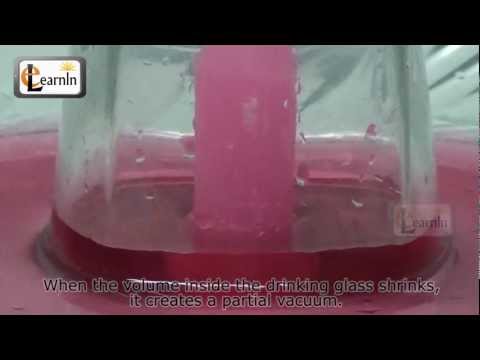

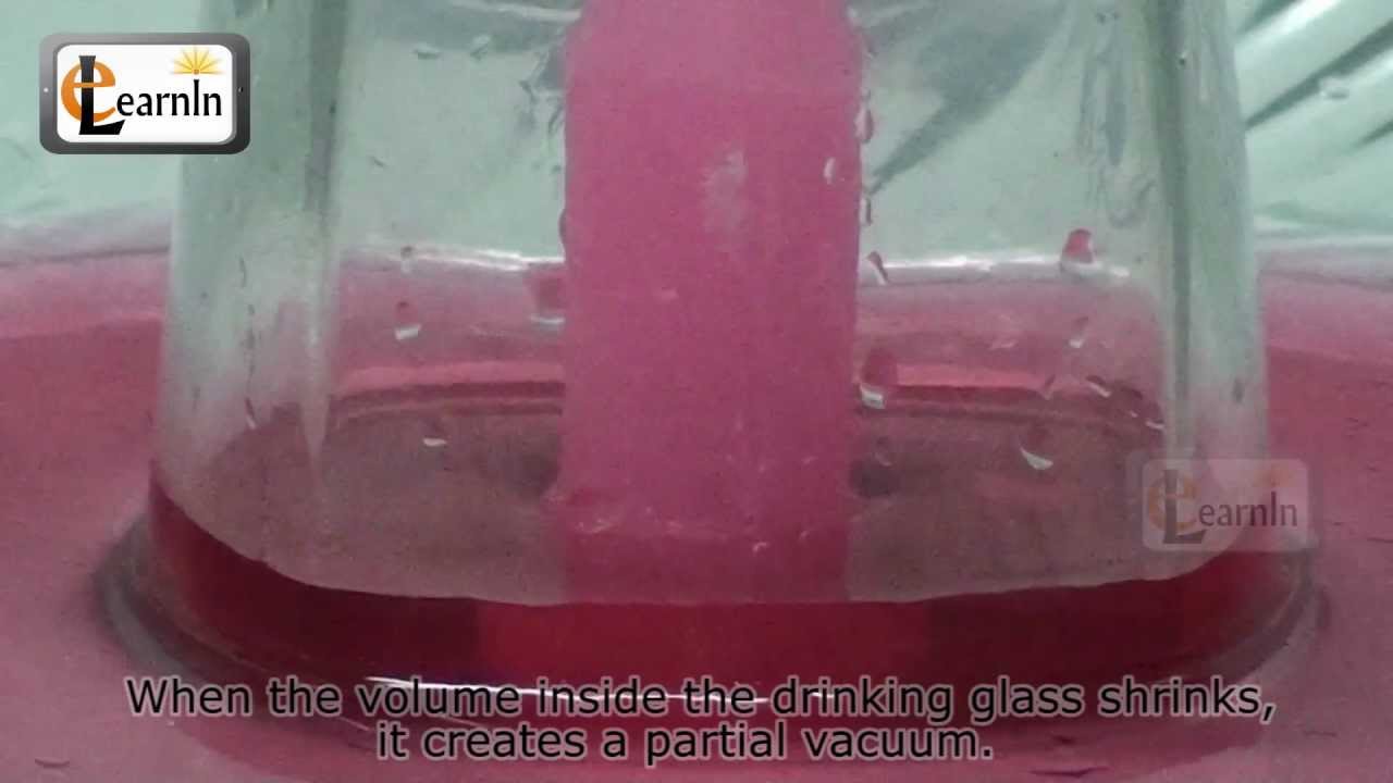

1: Time to find out your turn down ratio… ( minimum gas stream against max gas stream )
2: Increase the size from your filter would work to ( larger volume )
3: or a balloon like system, that slowly expands at a ratio that you not go below your minimum needed gasflow, this will also be helpful as accelerator after throttling down
4: ofgassing, take a look to some off my video’s , watching what happens if i disconnect the engine… the nozzle opening spits a gasflame… untill new suction comes…
5: some old school experiments might learn us more to understand some of the physics in the gasifier…:
What happens if we do this with a piece of glowing charcoal ?
Does this also happens in our gasifiers ?
Why would it , or not, happen ?
