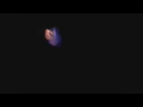

Made a short video showing the amount of offgas l have when l shut the engine off. Not much less when it idles.
And that is not eaven pushing the gasifier to extremes!
Ps the flame was lit at the ait intake of the engine, at the automixer valve.

Now-- what is that. The gas is just belching out in spurts after shut down?? Could that be air coming in the nozzles and igniting gases above the nozzles then going out until more air comes in. The burning gases would force the gases below the restriction to be pushed out to the air intake. ??? That is my WAG ( wild ass guess) TomC

No Tom, the pulsating is of my doeing. Opening and closeing the twin throtle to alow gas comeing out and not alowing it to burn anything. I just wanted to show how much offgas the engine has to deal with.

I suspect your hopper beeing so hot you are gasifing the whole hopper content.
Exactly! It gives me good power but at a high price! I have to find a optimal way to take the good characteristics of this and take out the bad ones. Thanks to you guys l have some ideas now.
