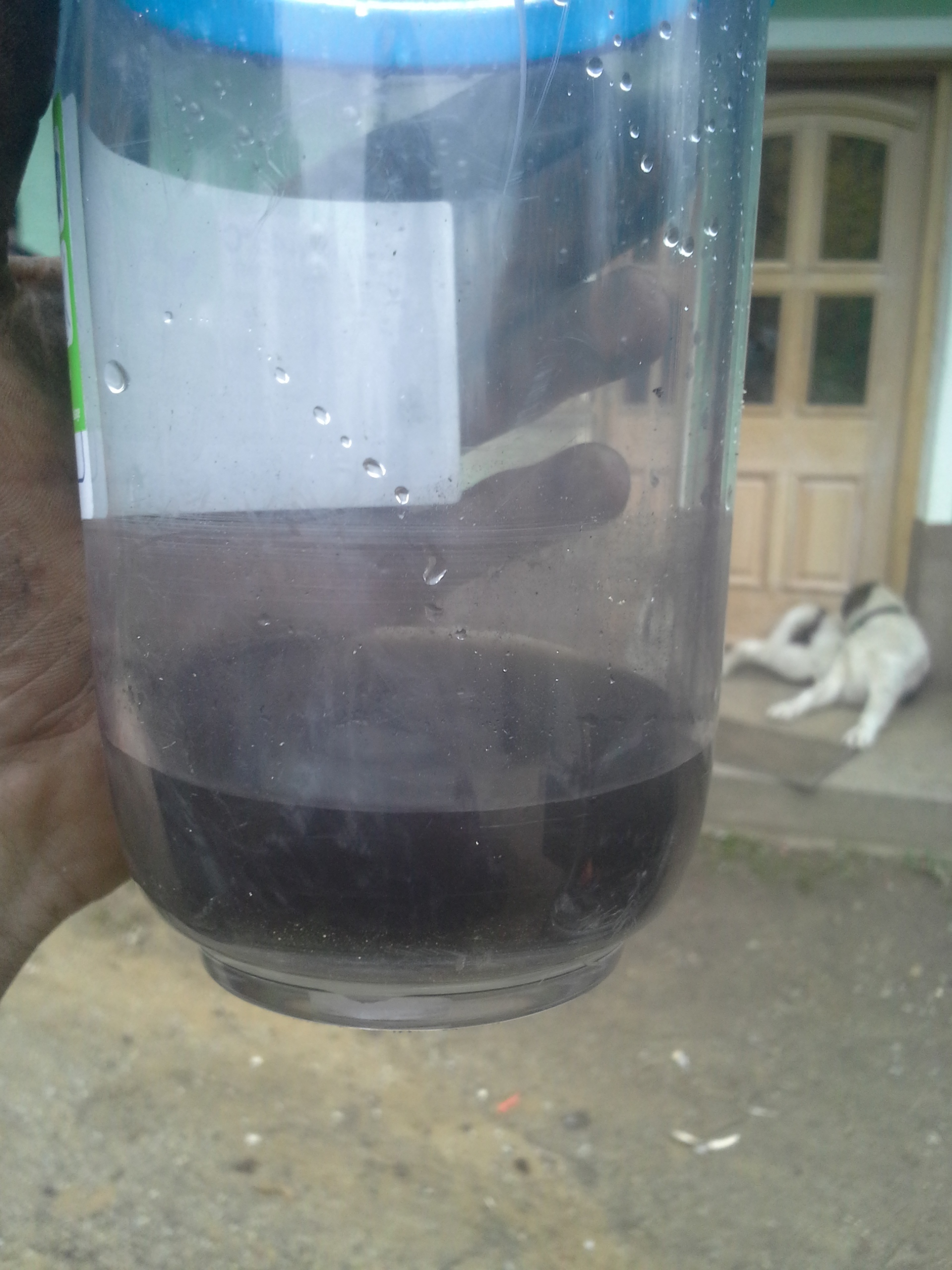

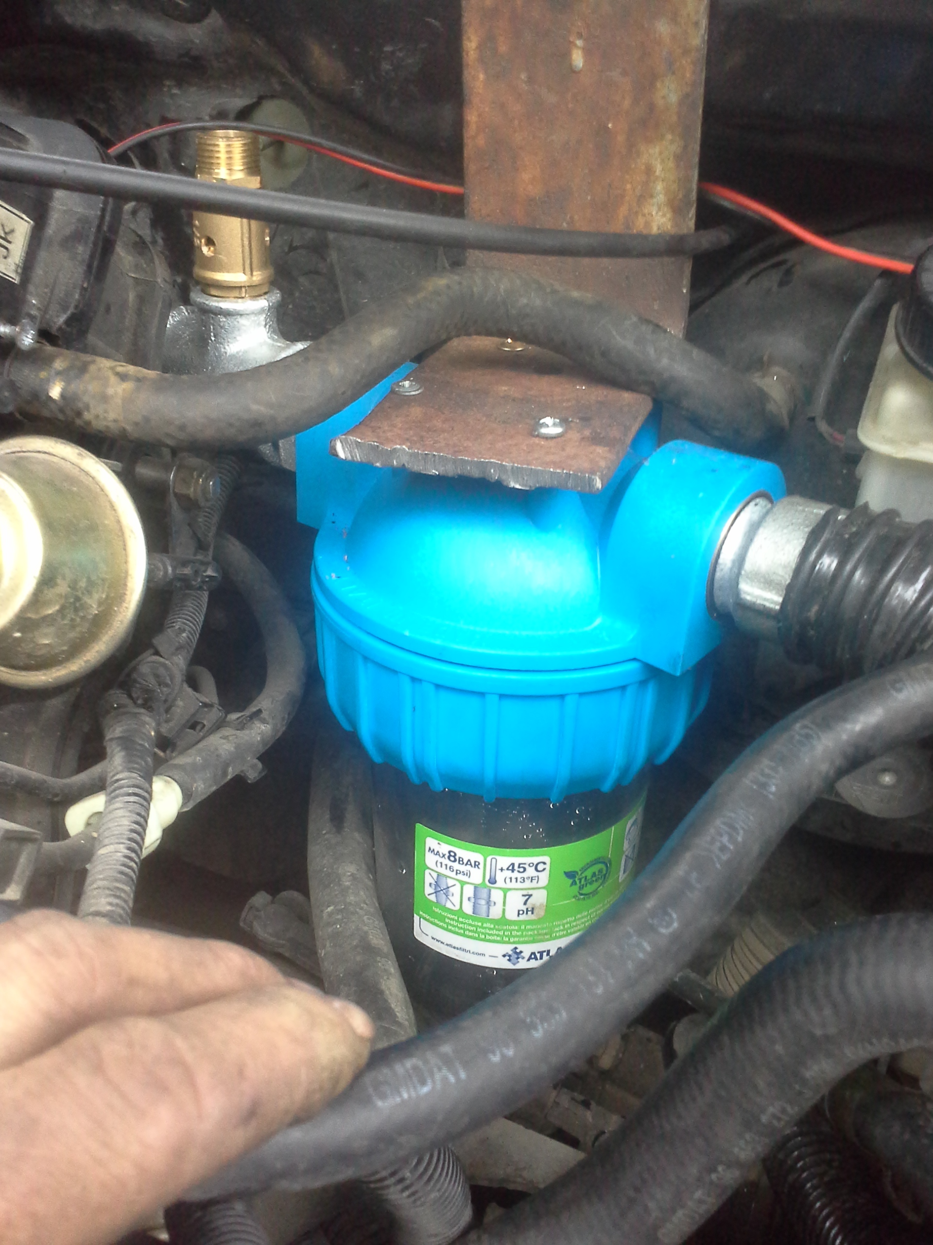

I have installed a condense catcher today.
When installed, l started the engine on gasoline and this came rushing in!
No wonder l had problems with cold starts! Looks like condense forms in the gas suply hose at cooldowns.

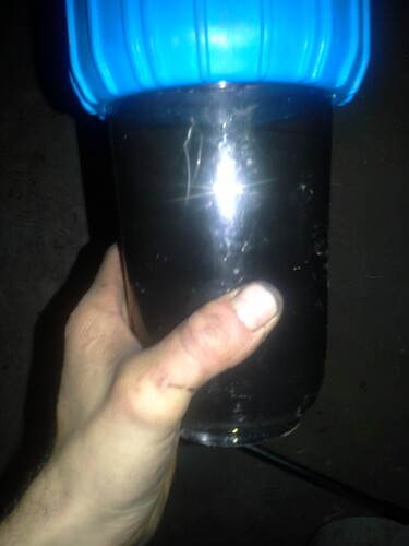

Thain l went for a drive. It drove great. l burned about 5gal (1 hopper) of my 5 years old oak chunks, they seem bonedry. This is the amount of watter l catched:
Culdnt belive it! Thats about 1/3 of a galon! The poor engine had so much water to deal with before!
Allso, the water was wery black. Like old engine oil. I suspected the filter has a hole but after setting the water for a few minutes there was just clear water with a few pinches of extremly fine sediment. Nothing to worry about.
Wow, that’s a lot of water.
I wonder if this was my missfireing problem as well, during the hottest days this summer.
Is that a water filter housing? Clever.
JO, it sure shocked me. Overall performance is much better now.
Its amazeing how important is such a small correction to a woodgas sistem. Reminds me on how much more l have to learn.
First l planed to do a cyclone type of moisture separator, thain l thod l might just use a water filter houseing, saveing some precius time, and it seem to work just fine. And l get to see whats inside!
I was thinking to drill a realy small hole in the bottom, to alow water to drip out when not in vacuum, but let a minimal amount of air in. At this rate of water acumulation l wuld have to dissasemble it on every refill.

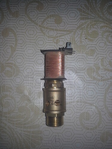

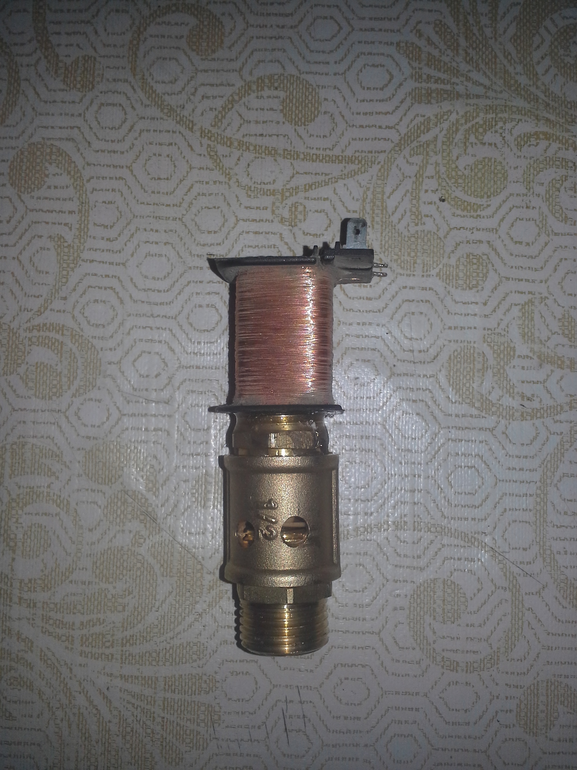

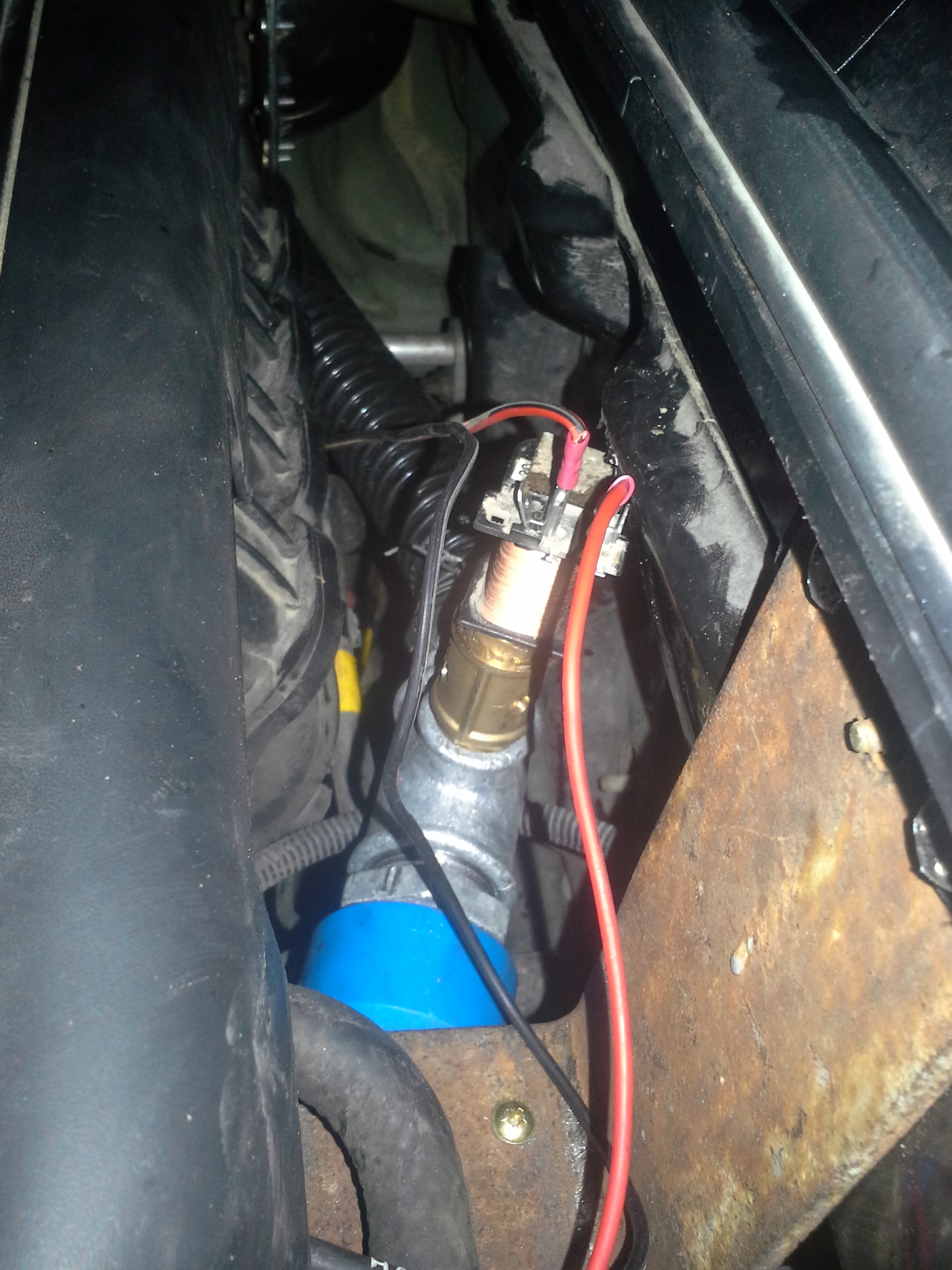

I made a electromagnetic valve today for adding air in the air/gas mix for hybriding.
This ads just enough air for the computer to find good A/F ratio while on 25% petrolpump swich with hot gasifier and for startups goeing uphill with 100% petrolpump power (do need that when l go home from work)
Its installed between the automixer and the condense catcher.

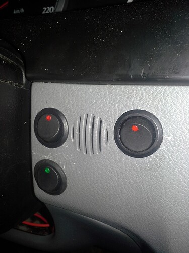

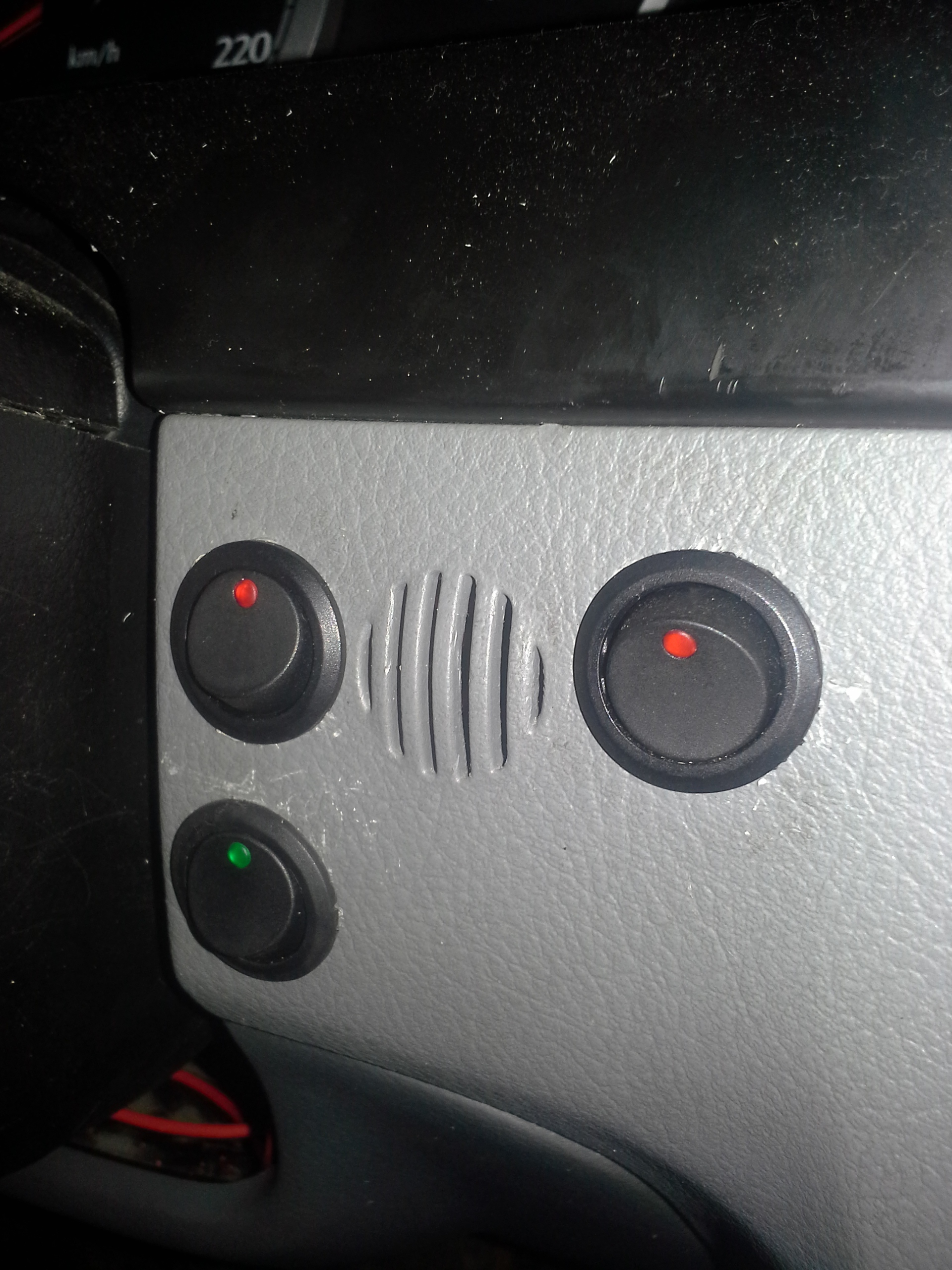

Added a extra swich. First l thod to just put a double swich on it, so it wuld open the air valve and power the petrolpump on 25% at the same time, But culdnt get such a swich. Glad that was the case! With the help of the automixer, cars computer and those 3 swiches l can more or less do anything l like.

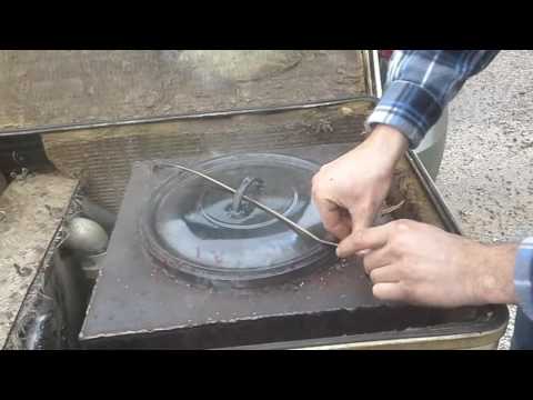

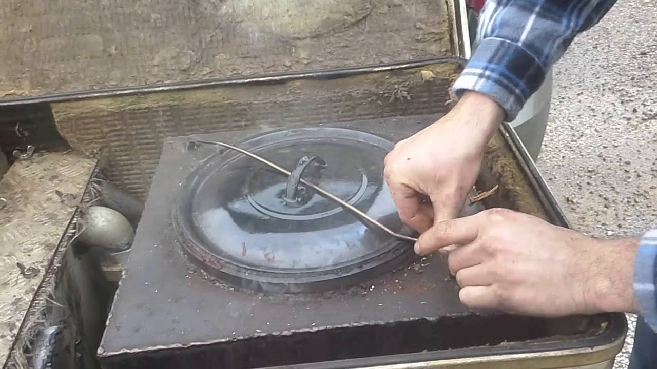

Itc is a cold rainy day today so l decided to take my family on a roadtrip, wood powered of corse. Here is a short video of it, and the refill procedure.
How bad do your clothes smell like smoke after a refill like that?
Actualy, not so bad. l was woried about that and have driven a work mantel with me for some time to put it over the clothes at refill but i dont anymore.
