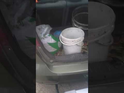

Looks like the pellets work just fine!
I saw no difference in performance and the dense pellets alow me to extend my range from 40 km to at least 80km on one hopper. Ill have a bag of them always in the car in case l rin out of chunks.
Carl,
This was my main concern but it looks like the hot hopper likes them. A positive thing is allso they have much less moisture thain my wood.
