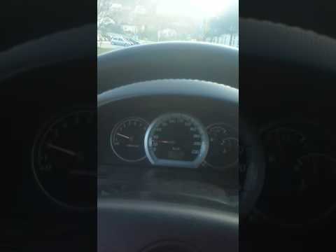

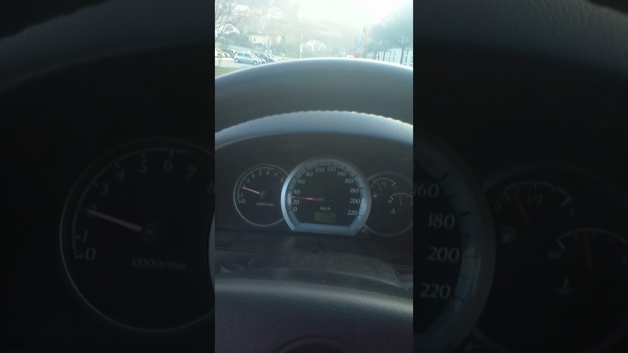

I did a litle video today, was planing to do a bit of town driveing and trafficlights with idleing but a nasty road accident forced me to take a nother road home. Or shuld l say 3 other roads.
the gasifier runs with a new restriction now. The old one cracked and twisted so much it had to be replaced.
The new restriction is just a mild steel disc with a 4" hole in the center. Wirks well. I might start to experiment with more “masive” aditions to it now to achive that flyweel effect. Will see.
Thank you, Kristijan! This was educational.
Like you said: Felt like I’m sitting right next to you or even in the drivers seat. I could almost feel that power hesitation. Same as I feel when killing the gasoline seconds to early when leaving the driveway. I usually wait until I’m in second gear to be able to take advantage of some momentum.
Good to see you’re up and running again :sunny:
And you always have nice weather :wink: I envy you.
Thank you Kristijan, and what Jan-Ola said. It always a pleasure to ride along with you and the others on DOW. Good to know the new restriction plate and reduction zone is working good. Yes, when you get some metal mass installed in that area, you will notice the flywheel effects when idling at longer periods of time.
I second what bob mac said.Thanks for posting your build Kristijan and the vidios. Good too see it working out good enough for the design and weight limits available in the light vehichle.
Thanks for the video :relaxed:
Hope no one was hurt bad in the traffic accident .
I had some spare time today, so l did a litle research and testing on the system.
I added a new lighting port-this way l can fill the hopper in the evening and light it fast and easy in the morning, plus its a bit easyer for my wife to light it. Less soot on the fingers.
I tryed to bypass a portion of woodgas to the air side of the automixer, so this way l compensate with small airleaks in the system and weak gas after longer idles.
The new restriction is holding up well.
I allso put off the gasifier air intake non return flap. I suspected it not working well for me at long idles when wacuum is wery small.
So l warmed up the gasifier and set the engine rpm to 3500rpm in neutral. Disconnected the injector fuel line to be sure and started to play with the new gas bypass valve. I found the automixer does set it self a bit lean, the bypass did a great job of correcting that! My refference was O2 sensor.
Then l let it idle. At first a puff of steam was rolling out the gasifier intake for a few seconds, all this steem wuld suffocate my engine at idle before when it hadnt had a chance to vent out. Then it idled well for a loong time. So this is good too.
Thain l drove to work. It was a pleasant ride, perhaps best so far. I allso stoped to buy some petrol, the car idled for about 5 minutes on wood and guess what?? I drove away on woodgas without much hasitation!
Slowly working on. Next step is hideing the hopper steam at cooldowns…
