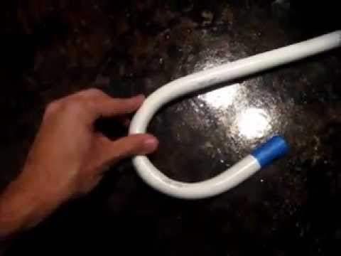

I have arranged with my friend for me to drive at his workshop tomorow, we will lift a car and asemble the new gas suply pipe. This sayd, has anyone got a idea how to shape a 5/4" plastic PP water pipe for the new gas suply pipe? Its a thick wall semi hard type. I have to make at least 2 90° bends and have no place for thick fittings so it will have to be in one peace.
I was thinking to heat it with a torch to soften and try to bend without pinching. Any better ideas?
try this.
Usually you use a spring when bending electrical pipes cold but it may be hard finding a spring in the right dimension. I think I would try sand and torch/heat gun.
For PVC conduit you just have to gently heat it over a large enough area past it’s critical temperature and it will bend evenly.

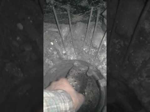

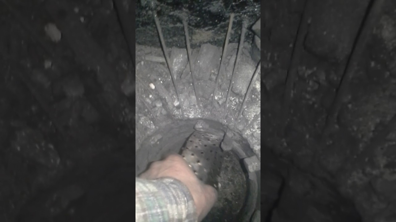

I have cut a strip of perfurated ss of a old washing machine drum about 3" weide and 30" long, connected the two ends to make a ring and lowered in to the firetube. This is now my grate. This way the char goes all the way down to the ashpit that the firetube covers, the rest of the ashpit still serves its function. The change is that rather thain gas being drown down trugh the grate, its now goeing trugh the side of the firetube.
Time will say how this works out in term of ash buildup.

I have emptied the firetube today, the looks were as expected. Ash plugging big time on the small holes.
I think this holds a lot of promise but w sort of a scraper wuld have to be built to scrape the ash built up up on the holes.
In this weather l have no pleasure in experimenting outside.
Ps allso its worth mentioning l drove for about 250km with good performance, so althilugh ashplugging does happen, its not happening imediatly.
250km of good prefomance? Could the ash build to point then be pulled threw the screen when restriction gets strong enough?
No. The ash is in form of a brittle slag, you can see it in the video when l crush a litle bit by hand. It cant realy pass trugh the holes.
This happens with the normal grate too. The difference is the old horizontal grate l can easyaly reach with a poking rod at refills, breaking those clumps of ash, the new grate l do not reach. This us where a grate sctaper kicks in. The point is realy just to break the clumps apart, gas stream does the rest.
