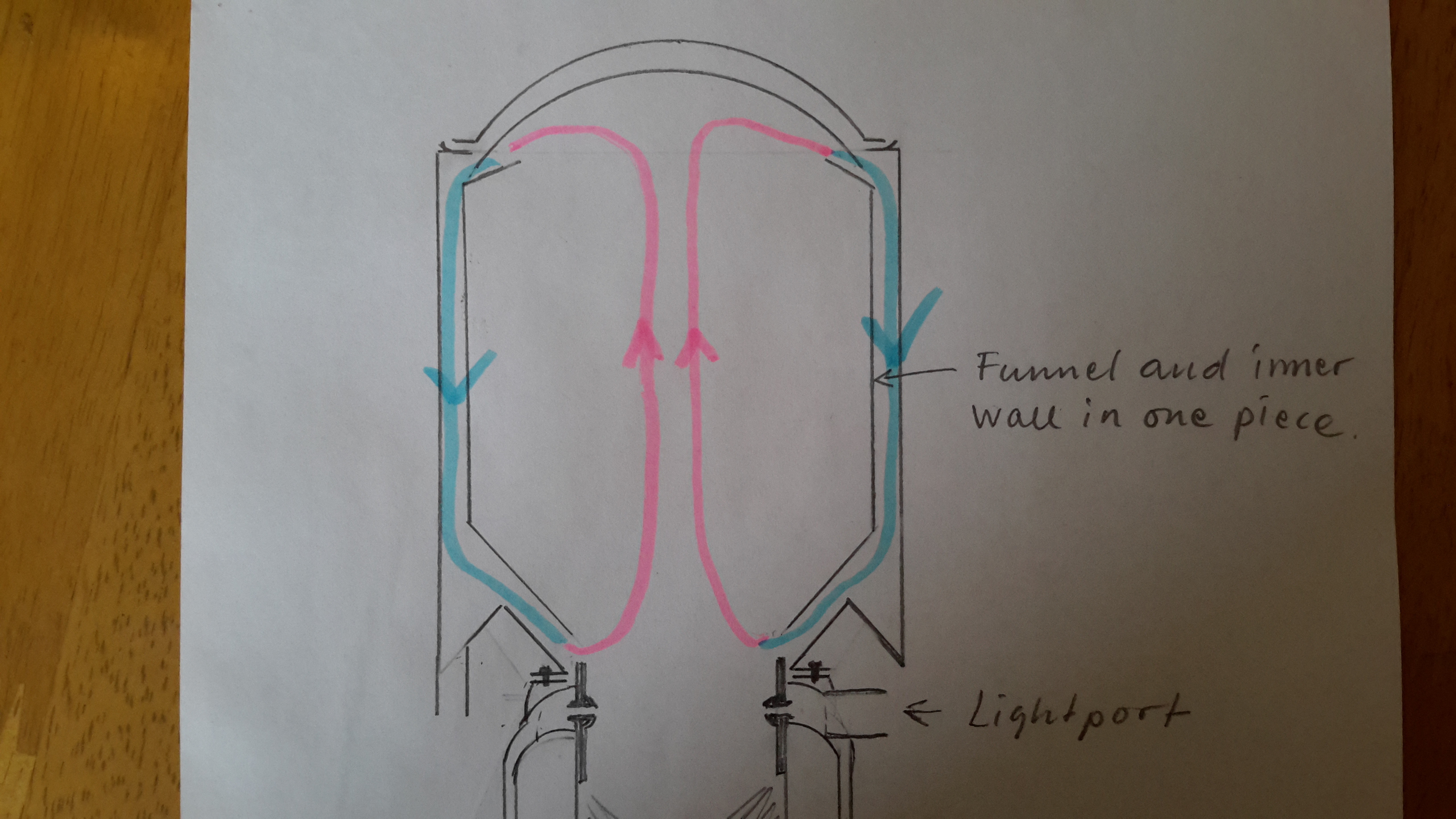

I’m not Max, but I take the oppertunity to intrude since this is one of very few details I belive I fully understand :smile:
Mesh works, but not as good. If upwards flow is totally separated from the “cold” downflow with a full body wall the hot and cold fumes won’t mix.
I get the feeling you use the word “gutter” when you are refering to that wall, right? I think when using WK terminology the “gutter” is the ledge catching the juices (where the drain is). Wayne is using an upper gutter as well, but it will only be useful if you use cooler tubes.
I hope this makes sence :smile:
Below is how (I think) my hopper works :smile:

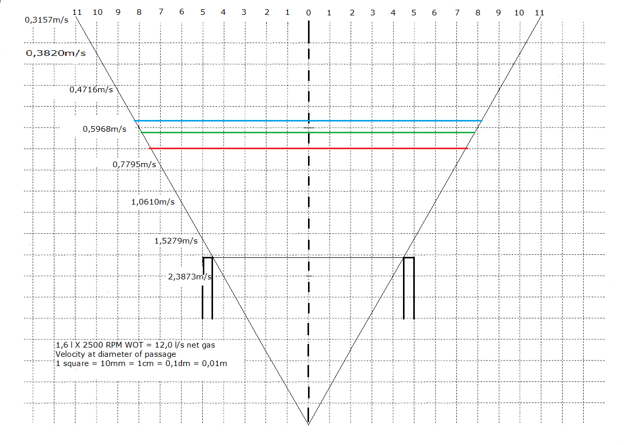

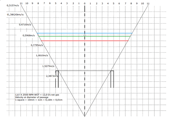

Here is a skiss with the 7%, 6% and 5% levels of 12l/s volumes marked by colour bands.
Looking at it in natural size does not inspire to attempt multi-level nozzles, or what do you think?

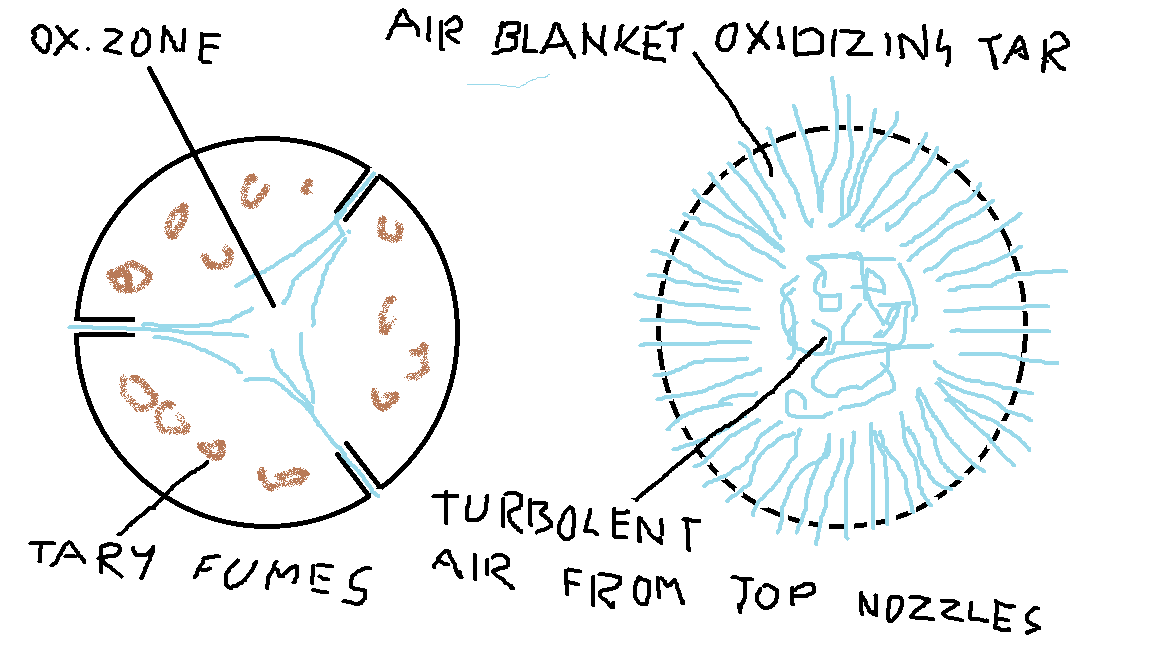

Again, it was never my intention for the air blanket that produces via ring of fire, to protrude deeply in the center. This is the job of top nozzles.
A picture worth a thousant words!
l have a “new” modern engine. Everyone always told me modern engines and woodgas dont mix well. This is what l want to prove false, so l have to have zero tolerance towards tar production. This is the only reason l am goeing trugh the effort of developing a better gasifier. I might just be kicking the fog thugh… But the only way to find out is by testing.

When I get a “scaled” skiss, or a drawing with at least the main measures, it will be possible to assess better where different air deliveries and where “consumptions” take place.
Rant: My skisses are on 10 X 10 mm squared (checkered) paper, made with BMP, which should make it easier to get right proportions…
As a chemist, you well understand that I mean free oxygen as a nominal heat generator and afterwards as CO2 only an endothermic “burden” at reduction.
End of rant.
And now, the main “problem”: Acheived process temperature and volume.
If say ~1/2 of the intake air is “consumed” at a peripheral region, instead of inside the process cone, the net process volume and temperature will both be lower.
A good sketch is giving a better overlook…
OK, a missunderstanding. l thod you ment air preheat depleats air of oxigen. This wuldnt make any sencre.
No problem on the dimensionised skech, if it helps, but l did this construction entirely by the feel, just folow basic lmbert dimensions.
“And now, the main “problem”: Acheived process temperature and volume.”
Temperature, l dont know. Volume is about as it shuld be for a lmbert and about the same as your Audi s, if not a bit bigger.
Yes, 1/2 is about right l think. But the first plane air jets are thicker, shuld penetrate a lot deaper.

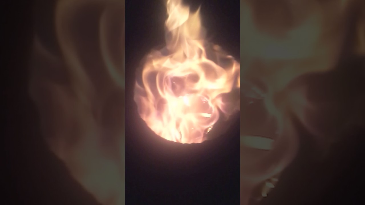

I wast thod it is not nice to owe anyone-return the favor as soon as you can. So, the “mad sciencetist” test video, with a twist l didnt expect my self. Thanks JO.
The flames are just air sucked in by the chimeny effect, but its amazeing to see!
Wow! Now, that’s a hot video.
Nothing (no tar) will sneak past that ring of fire, Kristijan!
You are a true scientist for sure.
Thanks a lot. That was really interesting.
I’ve seen the video three times already. Wife tells me to shut down the computer. I’ll watch the video just one more time before I go to bed.
Very interesting video. It does "sort of " make the point of the ring of fire burning between the nozzles to keep any tar from sneaking past. You only have 3 major nozzles and there is still a lot of “black” space between the nozzles. I had 5 nozzles in my last design, but I am now converting to 10 nozzles to try to fill in the black spaces. Maybe now with a ring of fire, I could fill the entire surface with flame. TomC
I watched your video again and I have a question: At one point you say you close the air inlet and that the engine dies.
Why doesn’t it continue to run with the gasifier in fema mode? And if the air inlet is closed, what is coming outof the nozzles? What did I miss?
Ha! You didnt miss anything. Good eyes (and ears :wink:)
The problem is in my English. What l ment was GAS intake to the engine. The air can still be drawn in freely.
