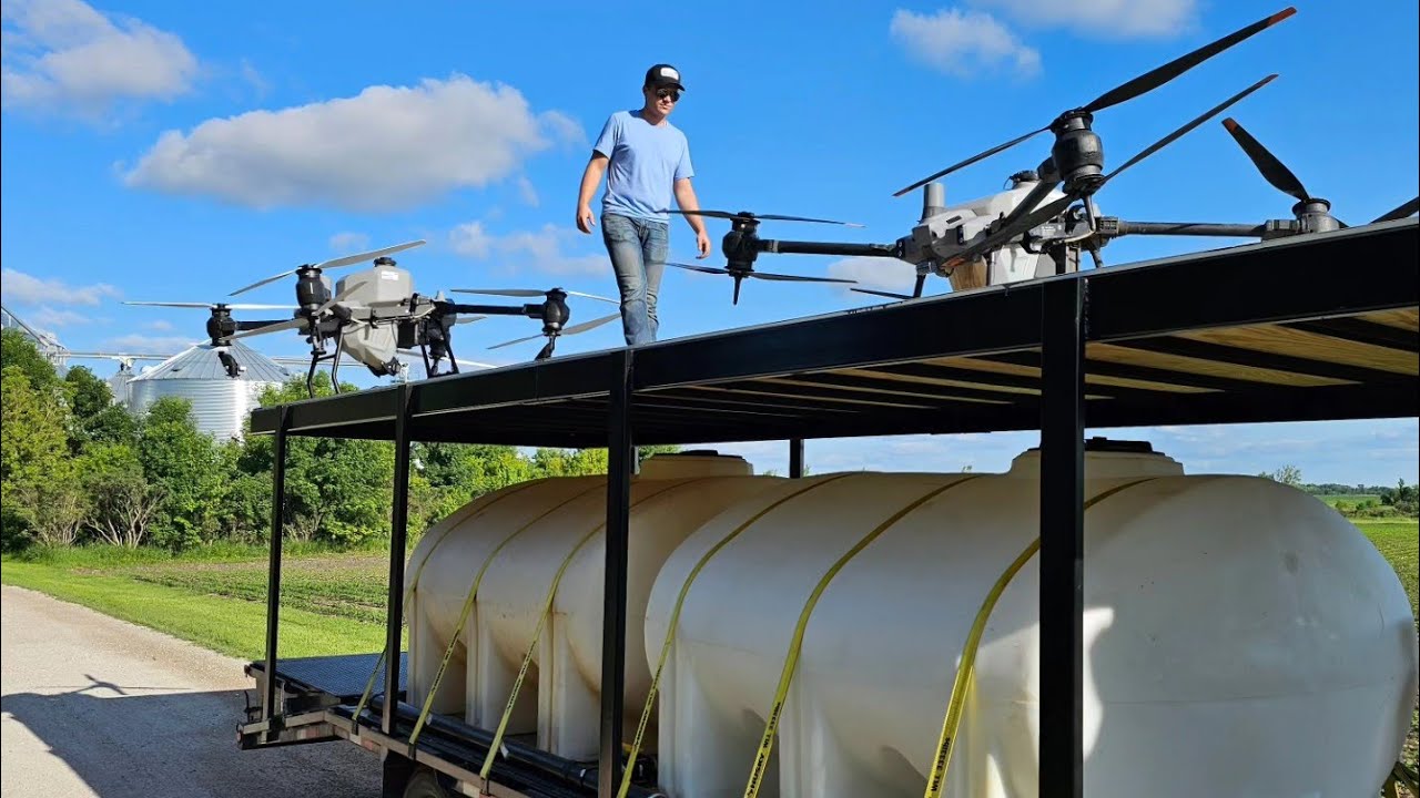

they have been using those for a while. ![]()
The robot weeders that go down the row to kill weeds are coming along but are more for horticultural crops at this point. As a side note, there was a bunch of talk about banning JNI drones made in China because they upload your path to their main database, and because they are cheap a lot of places were adopting them.

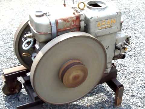

It was a hot summer day, my friend Boštjan told me that an old legendary diesel engine - Aran, which I have been looking for for a long time for my collection, was for sale nearby, and I couldn’t miss this favorable opportunity. The seller is an elderly gentleman (71 years old), farmer, beekeeper, vintner, … who still works hard despite his health problems, but he abandoned the idea of rebuilding the engine in order to use it only. Here are the pictures I took during the transport, in the background there is a stone viaduct on which the railway runs, which was partially destroyed during the Second World War, but then repaired, but they did not restore it to its original state with stones, but the destroyed part repaired with concrete.
That looks like a nice engine Tone ![]()
That was a good story Tone until you called the 71 year old elderly. 71 is 6 years in my rear view window. I might have to make a trip to Slovenia for an arm wrestle. ![]()
Well I suppose they will put that program into a helicopter then they can hook the helicopter to a 6 or 8 bottom plow to prep a field. TomC
Dont know Aran. now I do. This video was one of the first to show up.
It suits your collections Tone. What Goran does with chainsaws, you do with old engines.

Probably not that. John Deere even quit building plows. They are used to drop cover crop seed because they can do it while the crop is still standing, and it isn’t dependent on field conditions.
They map fields to look for damage, and a lot of times they just spot spray with them. There is a company that is trying to use them to drop trees or tree seed.
They also drop water to put out forest fires. Emergency responders use them a lot to survey situations, and look for people.
