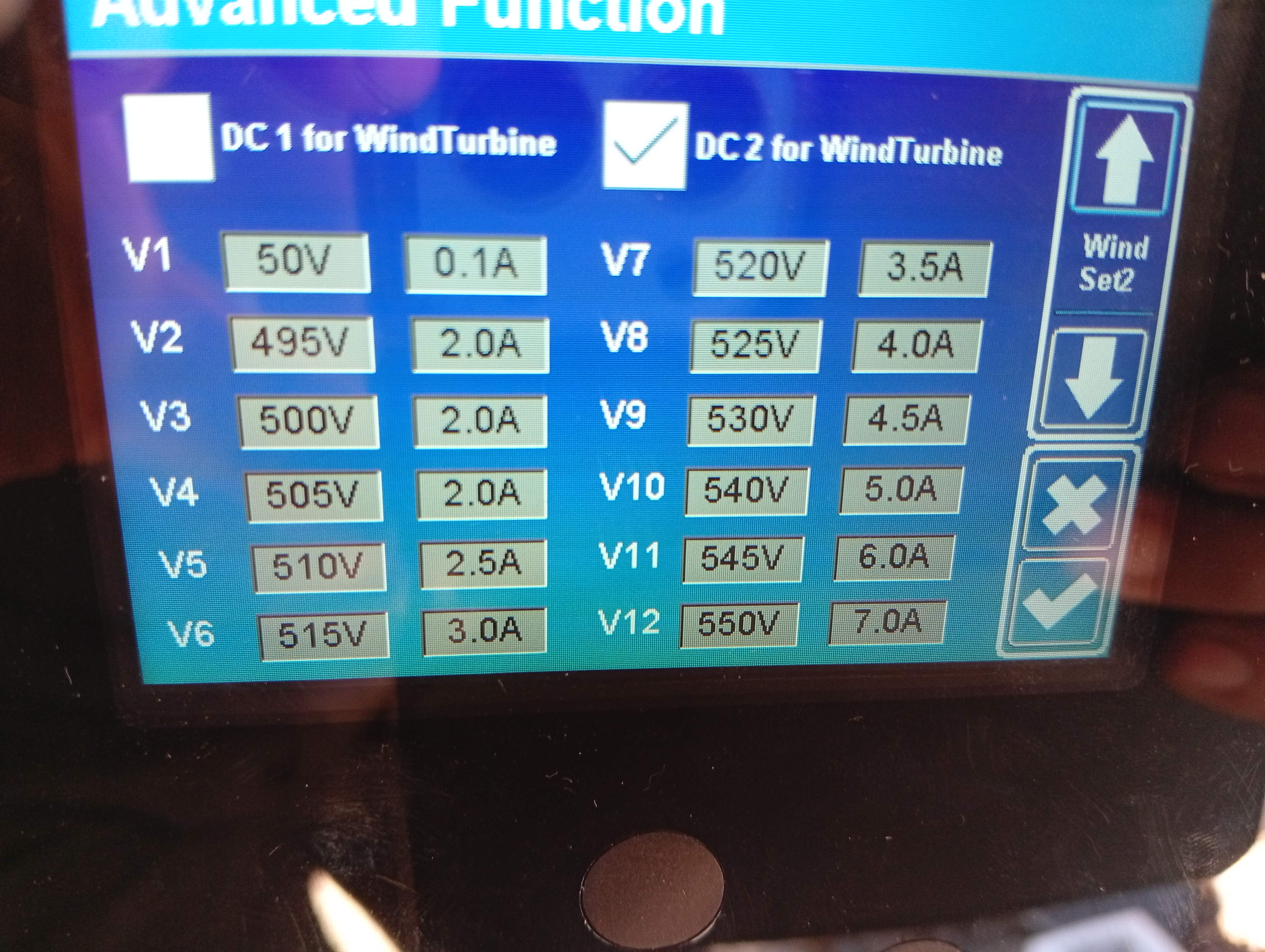

Joep, this inverter has the option, as David said, to connect “wind turbines”, and offers a table for configuring the power consumption (current) according to the voltage, which is ideal for my needs.
Brief explanation:
-When the voltage is lower than 480V, the current is 0A, or the inverter does not consume energy
-when the voltage increases, the inverter starts consuming more and more electricity, current - power
-when we reach 550V (the highest possible voltage for adjustment) I set the power consumption, current to a value that the generator cannot exceed, this is actually a “brake”
Since I intend to run the engine on wood gas, I need to make sure that the inverter does not overload the generator so much that its voltage collapses, but that it only collects the available energy, this is ensured by setting this voltage/current “curve”.
In the inverter menu, we set the total power that we intend to connect to the DC inputs, this is the sum of the power of the solar panels and the power of the “generator”,… if this value is set too low, the inverter will limit the power to this value and the generator will not be loaded,…

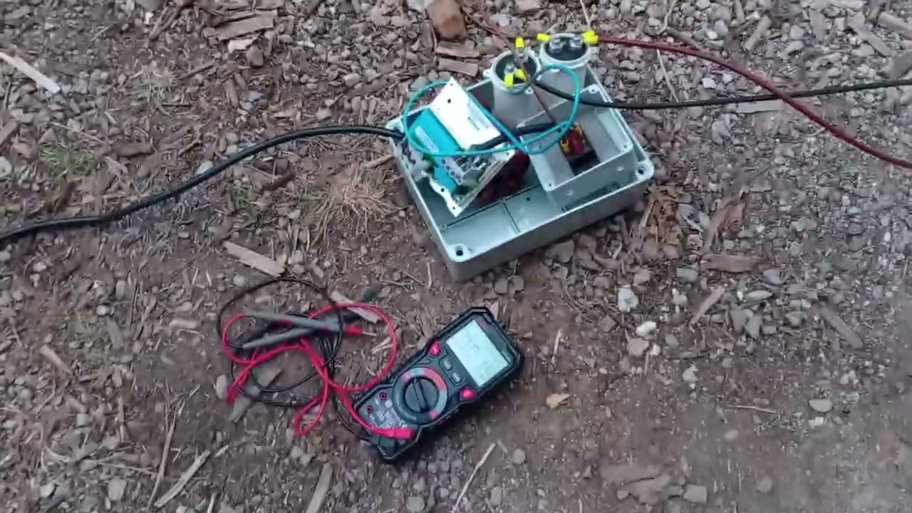

Greetings to you too Martin. This is a “regular” asynchronous electric motor, but I added capacitors for excitation, which are in the first cabinet, from which I get three-phase electricity, it flows further through the choke, then through the three-phase rectifier, and the capacitors finally smooth the DC voltage. This DC voltage powers the inverter, well, here is the settings folder (currently) according to which the inverter takes energy. I intend to slightly increase the engine speed, so that the electric motor-generator will rotate at least 60 Hz, and I need to replace the three-phase capacitor with a slightly smaller one.

For the generator input, I can only set the nominal power of the generator, so the inverter will load the generator up to this power, I see the problem in that if the gas quality drops, the engine will no longer be able to provide this power, the revs drop and the rationer will cut off the generator, … in contrast, if I use the DC input, for which I can set the values ​​as desired, the generator will be optimally loaded, or even unloaded in the event of poor gas. I will increase the last setting on the V12 to a value that the generator will not be able to overcome and will act as a brake.
