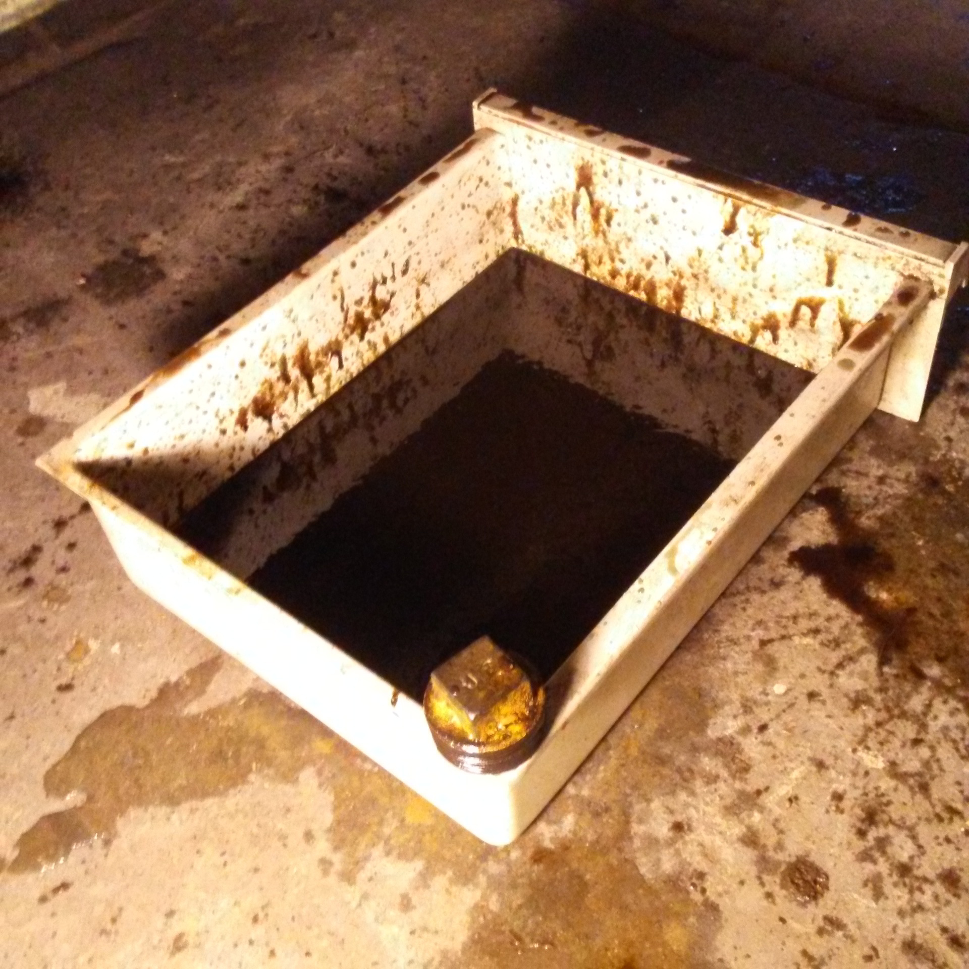

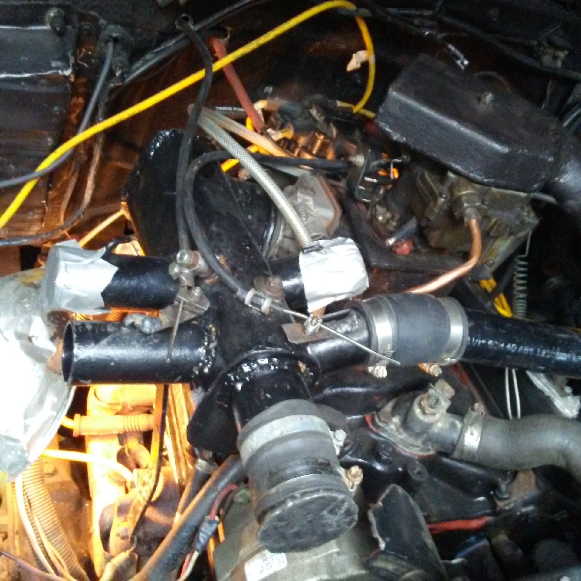

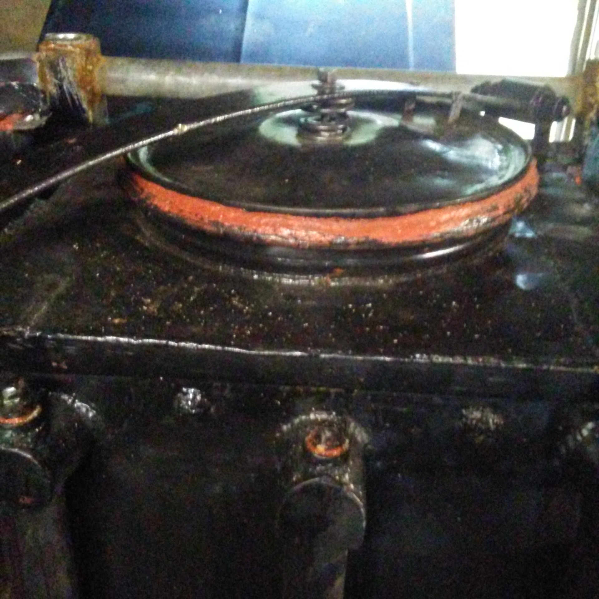

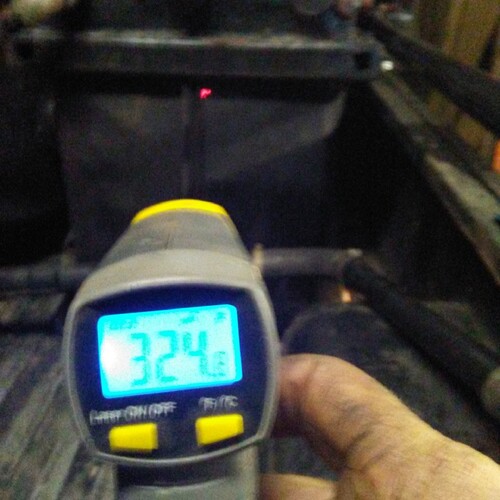

<img src=“//dow.nyc3.digitaloceanspaces.com/original/3X/e/9/e9b6bdf890611ca664b5d1853500a7ea973c2797.jpg” width=“500” height=“500”>anyway just few pics. Drove around the block backed in the barn and checking temps, the ash dump lid never went over 240 f yet.the power was low as expected, i am running on one hay filter fuel line 1_1\2"pvc.so may need the other line hooked up. Lots of fine tuneing yet finding few leaks, the lid seal spring lid works good, ran the pusher blowers with hopper lid closed and the lid door spring works letting any back preasure out and keeping from building up any big burps. sorry about the lousy picks, my camera is junk and its a rainy cloudy Day. Once i get it up too 55 mph on a sunny day i will have a vidio of my old truck project driveing.Thanks DOW & Wayne and Chris.

Congratulation!!! It has been a long time coming, but now you are there. An honest to goodness woodgas driver. TomC
Hy Tom C Thanks for the congrads you know i earned it,it has been a long time getting too test it has , and it serprirized too hear it running that well first time around., i will add the other fuel tube and see how much power i pick up.i think i might drop too from 6" too 5" restricktor for winter any way. And my wood gas pedel only moves about 60 percent open.my wood is alittle on the damp side so getting some wood farther away from the open shed door.

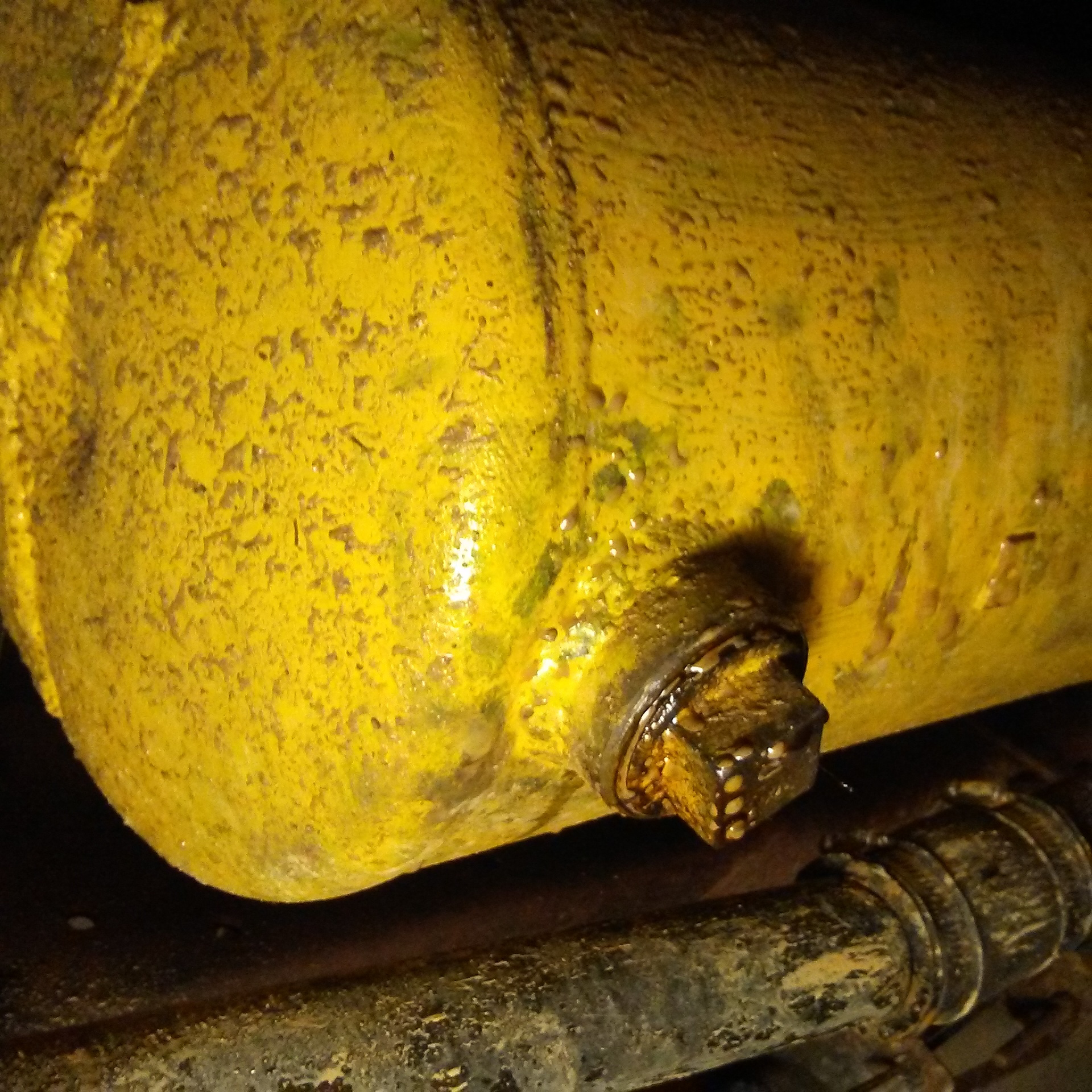

Thanks Wayne and mrDick Thodal . that old truck of mine runs good on wood and when i back in the barn and let it run few minuts and shut off it dont have the stink of the old carburator motors, no smoke at all,brilliat design mrWayne Keith.I am swithing sides on the carburator gasoine and wood gas throttle pedal, that will help.and adding the other gas pipe,? No not the gas line.:sunglasses: Ps as black as the hay filter water drain is when you stir the water it is only char ash on the sirface makeing it look like black muck.

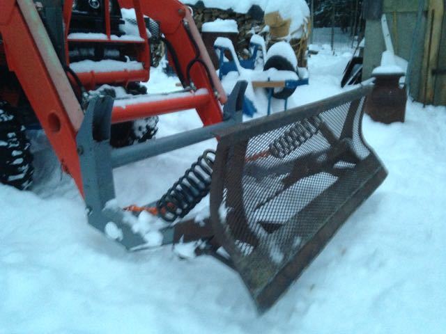

We got that snow in VT.Here’s my plow. Goes on and off the forks pretty fast.
We have been missing most of the snow this year i plowed my drive 2 times 5" and 7" other time, it aint so bad if you have a plow rig.How ever i got some wood pies cut off for truck fuel now i need herbs chopping machine.

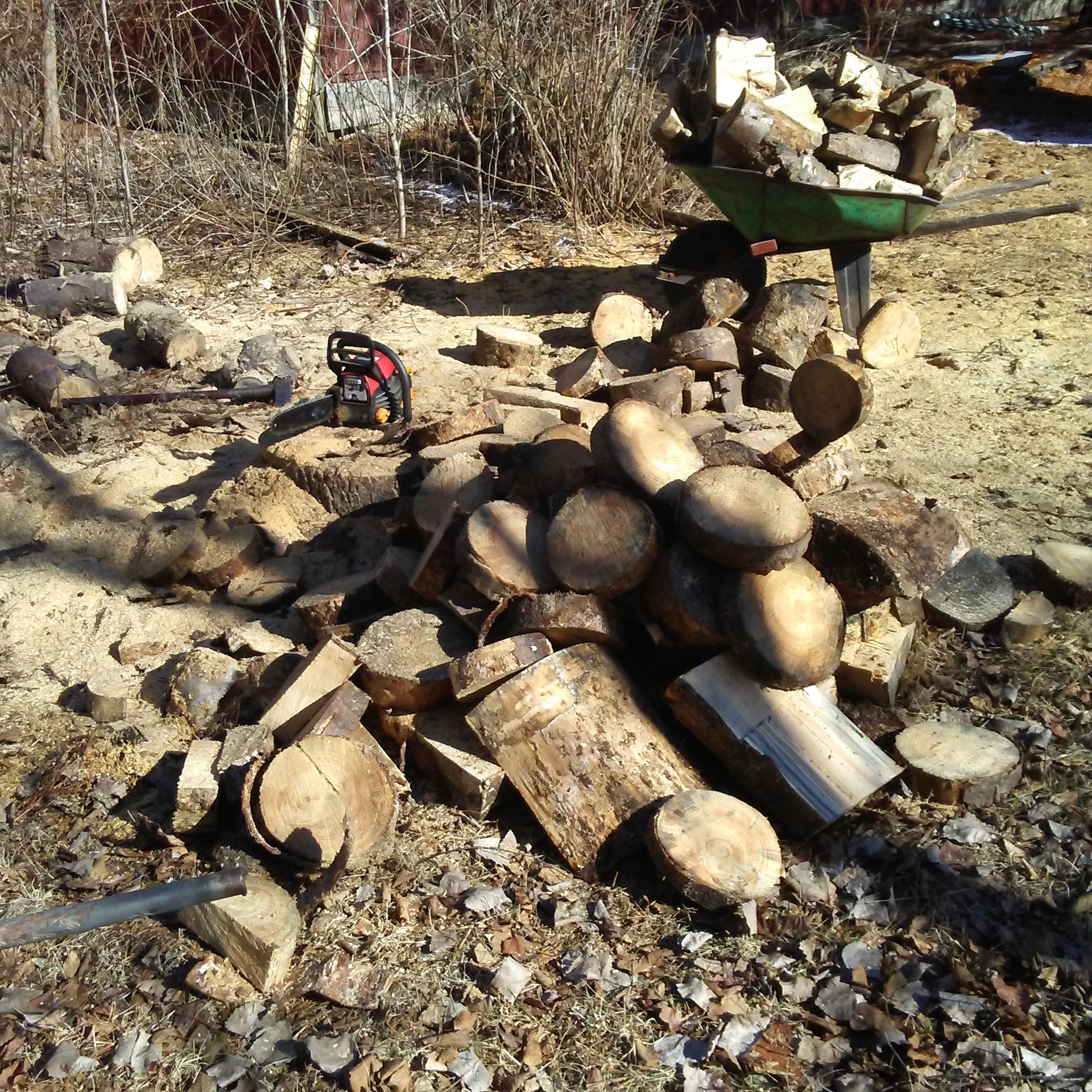

I agree Dan A those chopping up the pie tools could get the fingers or at leaste i think i want a gaurd on mine too. What i have in mind is the later, a large rotateing flywheel hooked up too my 1 1/2 ton axel with belt or clutch and have the very large fly wheel doing most the torqe breaking the wood with rotor like cutting wheel or the standerd truck wheel cutting set up. That type set up with very largefly wheel on a clutch letting the large fly wheel free wheel untill the brake is aplied would work with smaller gear box. I will have too build with what i have and test. I know any won putting miles down with wood will want a hefty chunker ASAP , my arm is still soar from cutting all the pine pies with my small 14" chain saw. My next chain saw my be electric if can find a decent heavy duty model? I know the pile looks small in the pic, i have a sharp blade on the saw and spent at leaste 2 1/2 hours cutting, even with processing gasifier wood the hard slow way i would say there is at least 300 pounds wthey dry wood there.in my big truck that is about 150 miles times per gallon at 8 miles per gallon on dino. That is close too at least 20 gallons of dino or about 50 bucks of fuel saved at todays price per gallon.That aint a lot of saveings for all the work unless you get better chunking tools or in my case, 50 bucks i dont have its worth the work the hard way processing tools for short while.That Jo and kristien guys i envy makeing those tiny cars work on wood. My little wood pile wood get them little cars ,pickups 600 miles by the way they claim there milege.
Look how long it took you to build your gasifier and you are talking about building a chunker?? Mr. JO is probably driving just about as much as anyone is this time of year. He has a Rebak, but he cuts log disks, takes them to the basement and sits by the furnace, with the radio and chops them up. He feels he is earning more money by chopping wood than he would make at the plant. Giving up a couple of hours of TV will reward you with an equal amount of driving time. TomC
