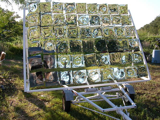

A solar array is not hard to build using bathroom mirror tiles sold at home improvement stores. I constructed a spider for the back of each mirror that causes it to focus down to a spot about 4" square. Each row of 9 mirrors is then mechanically adjusted to focus on the target. My collector has six rows of mirrors and each pair of rows is on a small pulley to adjust the beams up and down to follow the sun. The array was built on a boat trailer and the tongue of the trailer is moved every 9 minutes. The mirrors were fastened to the spiders with Gorilla Glue.
I built this to use as a solar oven, and it was used to bake chicken, angel food cake, bread, vegetables, french fries, biscuits, etc, (A stick is easily ignited if held in the beam.) This array is rated at 3000 watts, 950°C, and is called a Helios. More information here: Solar Fire in a Nutshell | Symington Solar Fire

It looks to me like every tile is centrally distorted to tighten the focus? Great setup, I have mirrors already, just need to get a frame together and I would like to work on a tracker so it can run unattended.
Thanks for the link.

Yes, the mirror tile is glued to a 3" square 1/8" thick steel plate. The 4 arms of the spider are also welded to the same steel plate and a 1/4-20 steel bolt pushes on each corner of the mirror. It takes very little pressure to distort the mirror tile, i.e. only a couple of turns on the bolt, since the focal point is far away. Each mirror is adjusted separately while focused on the front of the oven. The oven is also on tracks, so it can move back and forth, because the ā€œcolorā€ of the light changes the focal point throughout the day.

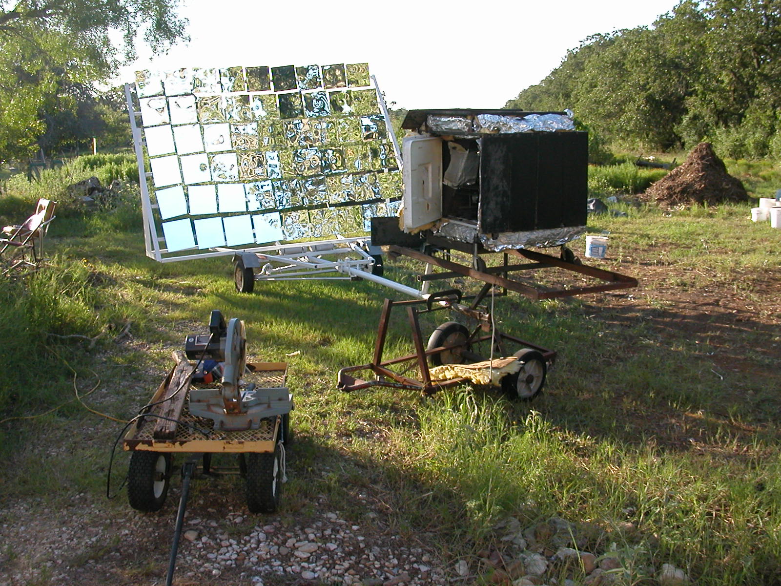

Glass at the focal point was a problem for me. I tried strips of glass made from the glass in a copy machine, but they all shattered. Next, I tried Pyrex, and even changed the mount somewhat to hold the rotating tray from a Microwave oven. Every glass I attempted to use eventually failed, so my current solution is a heavy steel plate mounted at an angle inside the oven, and backed up with another 100 pounds of steel mass. The steel radiates heat into the oven. This idea came from India where a Scheffler Reflector was heating hunks of ships propeller shafts heated by the sun and rotated into a kitchen for cooking.
You are correct in the danger of this setup burning things. One builder left his unattended and the beam melted a plastic bumper cover on his car. Grass can also be ignited. In the photos, I have the array facing the opposite direction, and it is stored in the barn when not in use.

The glass is a tough question. But worth pursuing, as otherwise the radiative losses from the collector will significantly reduce the efficiency - 50% ? (Radiating both ways).

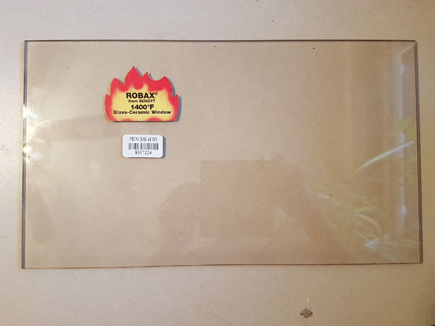

I picked up a couple of these, they are wood stove window glass. I wonder if they might handle the thermal stress?
What about the window glass from a kitchen stove? I suspect this stuff is tougher, though the kitchen stove glass is ubiquitous …
