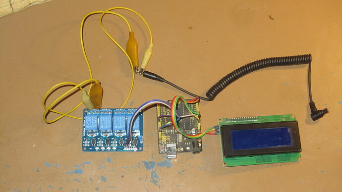

Sunday was my birthday, so I got to take the day off from projects. I have been thinking of taking some star video, so I programmed an Arduino to control the shutter on my Canon EOS. This allowed me to use the bulb setting to take long exposures of 15 seconds continually for a couple of hours until the camera battery died. I can then assemble the stills into a video,
The first night was cloudy, but here is a video from the second night.
I am going to order a dummy battery - basically a USB connector in the shape of a battery to power the camera for longer periods.
My next project would be to build a motorized mount so I can slowly pan the camera over the several hours of exposure.
edit: Youtube is defaulting to a low res showing. 1080 is the native version.
