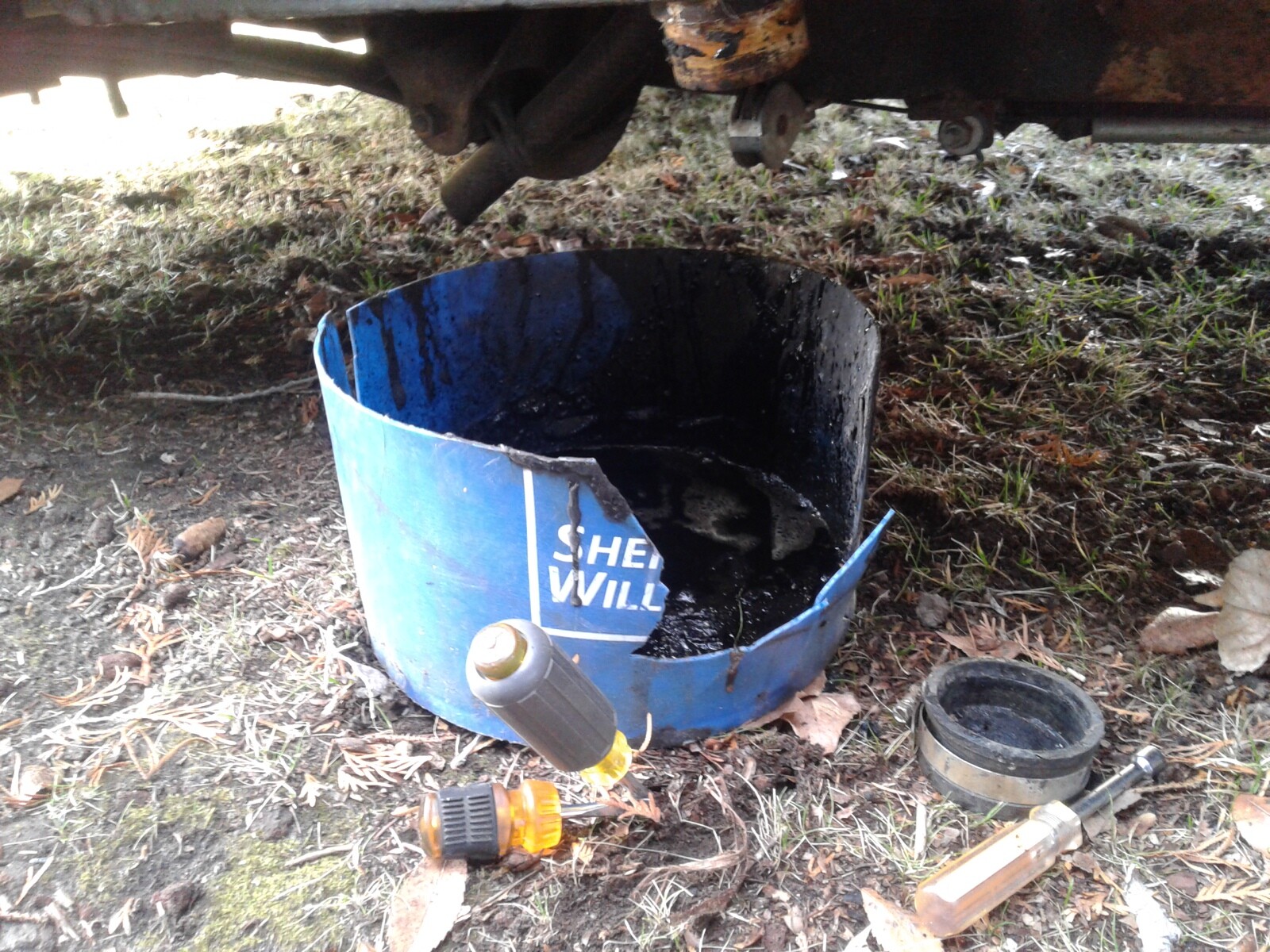

Yesterday black tar/water valve stuck closed. Today we are having a warming up trend this week in the North Central part of Washington State. 65°f or 18.33°C and sunny outside feels like the first day of spring but it is February 1.
Pull on the lever and the black tar/water valve opened. Not that much water is coming out just a little trickle. Removed the 2" cap the tar was solid. Had to do a little digging to get the water to start flowing out. Hopefully it will be even hotter tomorrow so the tar will begin to flow out of the tank.
Thank you Yehovah God for your Son and the warm sun shine today. DOW

Some progress, ( 2 days later ) on my tar/water dumping. The water is out of the tank. But the tar is taking its time to drip out and into the bucket. Bob : Make a note to always while it is warm and before the winter sets in with freezing temperatures to dump all the black water/tar out of the tank.
