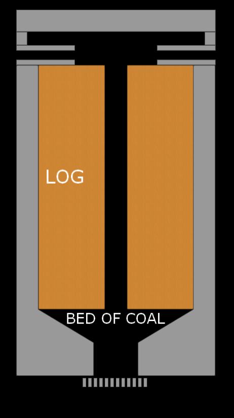

Maybe something like this would work using pre drilled logs?
Nope this isnt going to work for an engine. There are wood boilers that have gasification process that run on logs. But this can not run engine.
Believe me if this could be done someone would have figured this out many decades ago.
