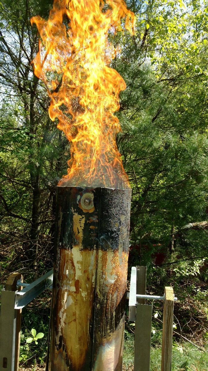

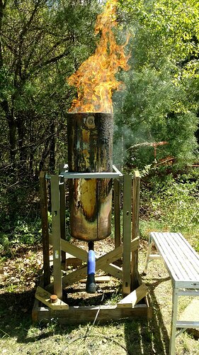

what did you put on top of it for the ring? Do I see a tree on fire too?

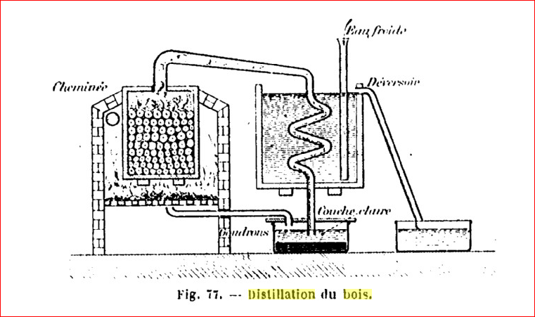

a French technique of the 19th century, absolutely everything is used during the distillation of charcoal and recovered, the pitch, pyroligneous juice ect..the pitch mix with the charcoal dust finally to obtain carbonite by the After a change to a ball press and then dried in the sun, a volume of wood is put in at the beginning to raise the temperature of the hearth and then maintained by the distillation gases.
simple and perform, respecting nature, our elders were far from devoid of good ideas.
The “ring” is the bottom 4 inches of a 55 gallon drum with several 1 1/2" holes in it. Just something lying around from a different project. The ring was not needed for my previous setup which was burning from top to bottom with good fan control. Trees were nearby, but no trees were permanently injured (except the ones inside the TLUD)
The ring looked like it fit on rather nicely. It looked like a squirrel nest burning in one of the pictures, thus the question. I singed the oak about 30ft up when I tried part of a 55 gallon barrel with a gap then a part of another 55 gallon barrel in mine. the flames weren’t that high but the heat was that high. you could see the heat waves and the leaves rustle from it… :wink:

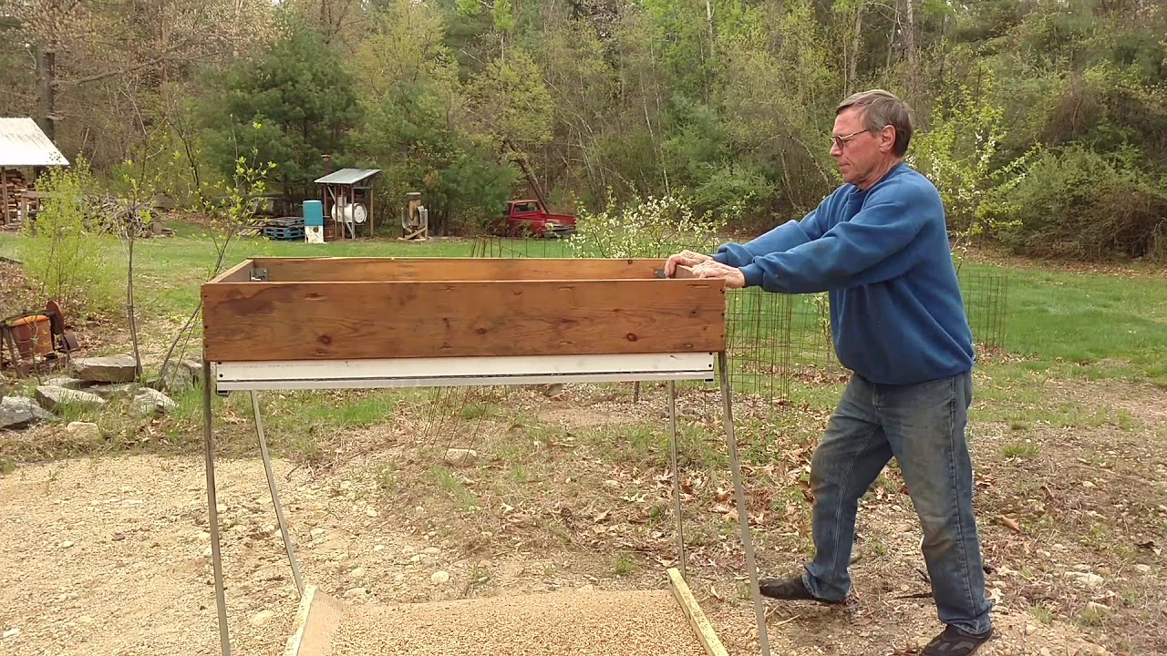

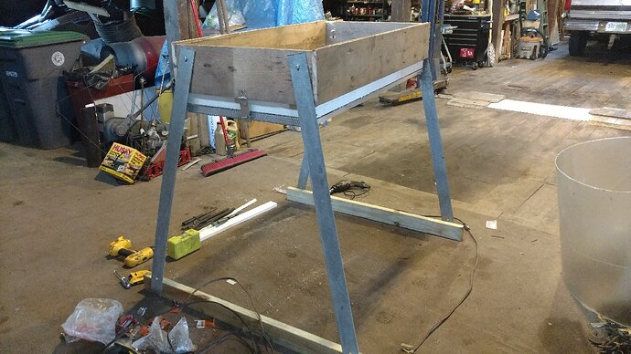

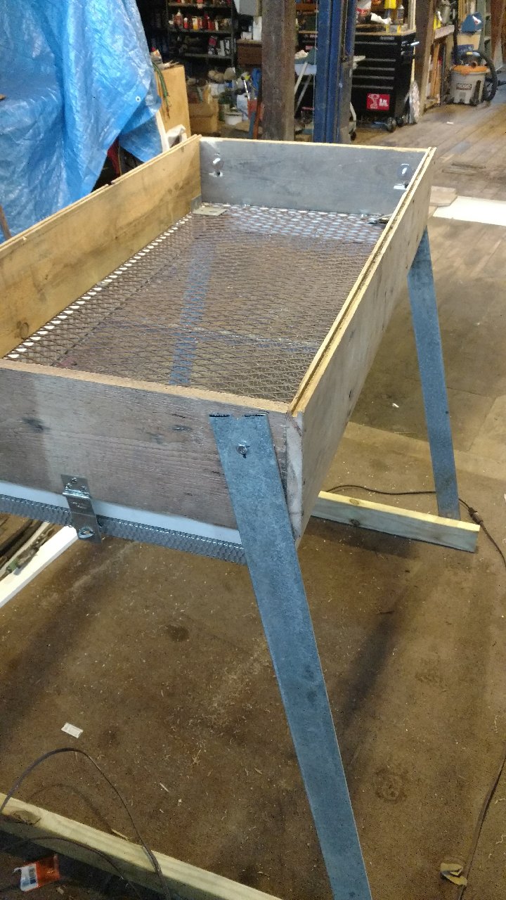

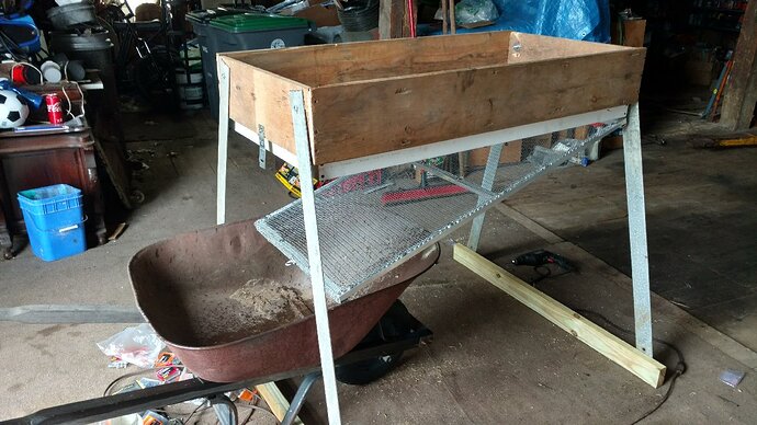

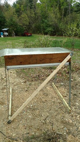

For some time now I have been sizing/classifying wood chips before carbonizing/pyrolyzing them. I was using a screen-bottomed box, hanging by ropes. A few months ago, I came across a sketch of a screen/grizzly/classifier for placer mining that used thin steel legs to allow easy shaking. A few days ago my prospecting hobby bumped into my gasifier hobby. I suddenly remembered some galvanized 1/8 X 3 inch steel that I salvaged several years ago from an above ground swimming pool. This setup separates chips into large mulch for walking paths, medium chips for gasifier fuel and small chips for garden mulch. The thin legs allow much better shaking action than the ropes did. I have freed up precious barn space and I can take the screen to the chip pile. A piece of fiberglass solar glazing on top turns this into a solar chip dryer.
how are you shaking it? Manually?

Yes, by hand.

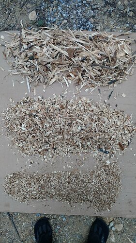

The three classes and relative amounts:
Brace to prevent wind wiggle and glazing for drying fuel chips:

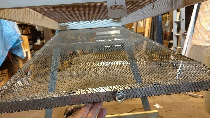

What size screens are you using? I would guess the two smallest sizes might actually run through a gasifier like matt’s carburetor set up. I realize that defeats the whole purpose of doing what you are doing so Rock On! :slight_smile:
The screens are diamond expanded, approximately 3/4" x 1" and 3/8" x 1/2". These middle size chips (between the screens) shrink a bit when pyrolyzed and go straight into my charcoal gasifiers/reactors.
As soon as I get enough chips screened and dried, I will rerun the giant TLUD with a proper fan control and report on the results.
We have found that the smaller sizes actually work quite well in a little gas can gasifier stove I built a couple weeks ago.I will try to bring it to Argos. It burns the 1/8 stuff mixed with 3/4" cubes of wood and chips really well and insulates quite well. I want to try what you are doing with the wood chips. What kind of time does it take to sift it by hand. I know when we sift clay by hand it burns up quite a bit of time.
The video was the complete actual sifting time for the three classified samples shown in the picture. That was my first test with this classifier. All I know so far is that it is much quicker and less energy intensive than my old rope hung version or my older wood on wood sliding version.
I was kind of wondering whether the second screen was actually needed if you just ran it in a gasifier.
It seems pretty fast, do the pieces stick together? I am wondering whether it would be conducive to running it at an angle with a vibrator type of motor like a grain separator. Then you can spend your energy shoveling it on, instead of shaking it. Not that it works with your overall goal, just wondering if you think it might work. :slight_smile:
Second screen is needed to create somewhat uniform size which aids the gas flow in a retort and even progression of the pyrolytic front in a TLUD. Without this second screen, fine charcoal particles would also clog up the gasifier.
I think an angled shaker screen would work. Somewhat expensive, but effective, shakers are used on hoppers that spread salt and sand on roads in the winter.

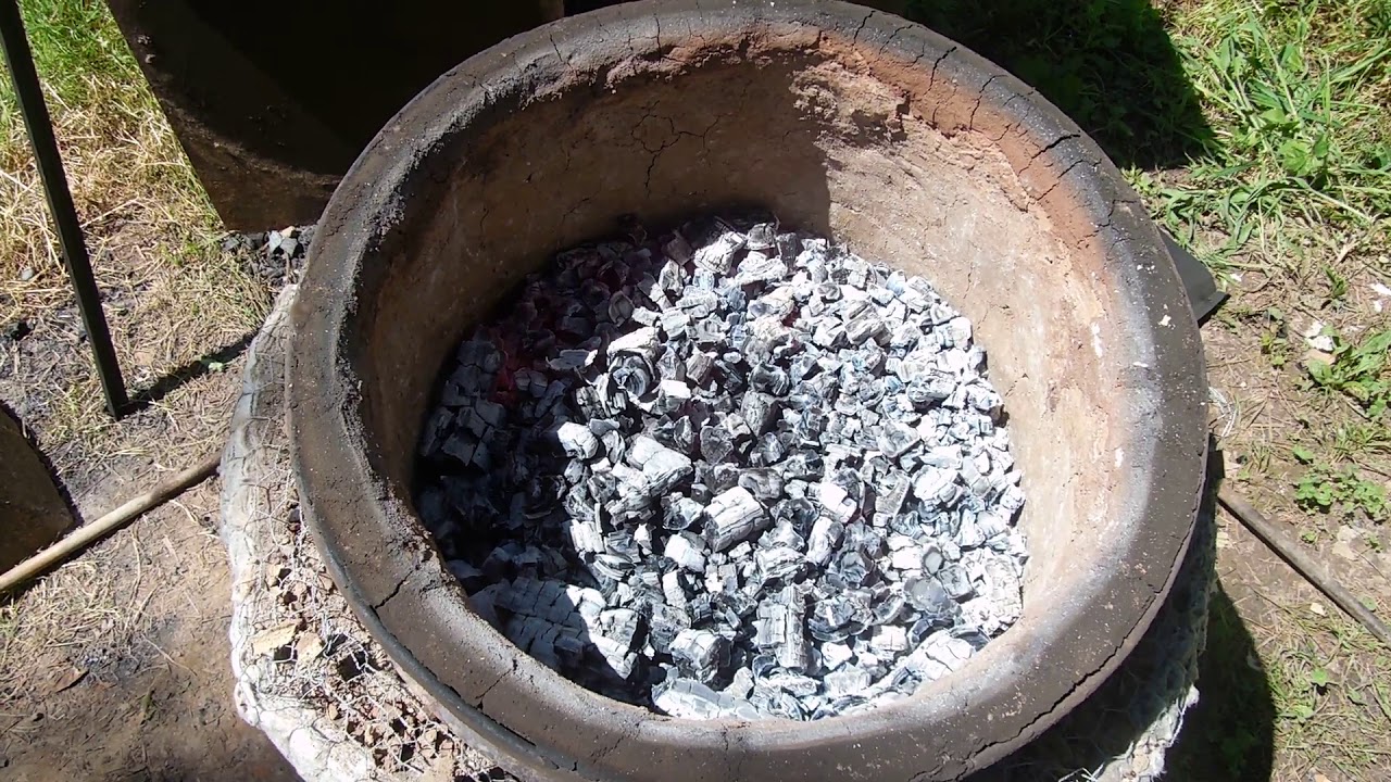

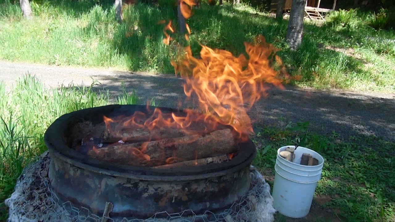

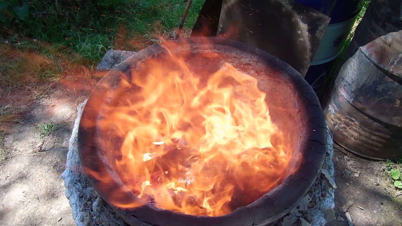

Hello charcoalers, I have done some experimenting with my clay lined charcoal kiln, but I have stopped up the holes, and Im using it as a pyramid kiln now. This seems to me to be maybe the best way I have yet tried to make charcoal without smoke. Here is a short video of me loading it.
The insulation makes it get really hot, so the burn is always quite clean. (Although I suspect it would do just fine without). I add wood every 15-30 minutes - as much as 5 gallons at a time. It does not really need to be tended, I did this batch today while backpack spraying, and would just toss on more wood when I was back to refill.
Once it gets up to the top, and mostly burned down, I put on a scrap of sheet metal to burn off the last woodgas without letting as much air in to the charcoal. This takes a little longer, but I feel like it is worth it. I weighed wood in and charcoal out on a small batch yesterday, and got an impressive 24% conversion by dry weight.
Todays batch took me 3 1/2 hours, but I got almost 3 hours of other work done, so it is pretty time efficient if you can work on something else nearby. I will weigh the yield of this batch tomorrow, but it should be in the neighborhood of 30 lbs - or roughly one 30 gallon steel garbage can full.
I am going to try and improve on the clay lining, as it has an annoying tendency to flake off little pieces, and it needs a bit of patching up after every couple of runs. Scooping out the finished charcoal is also kind of a pain, but not terrible. If I devise a more robust lining, it could maybe be tipped over. Otherwise, I feel like this is the best method I have tried so far. It is very similar to a cone kiln, but I like being able to partly cover the top at the end to finish the brands, and then cool it in place. No handling searing hot coals, or dousing with water.

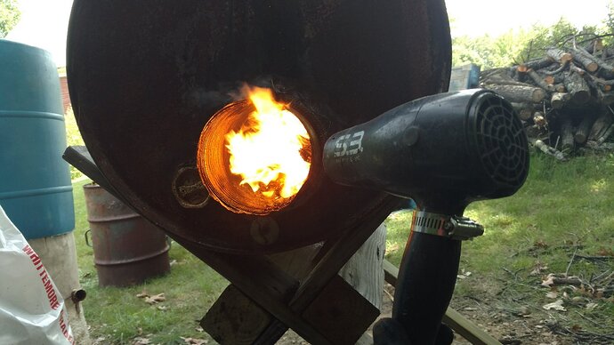

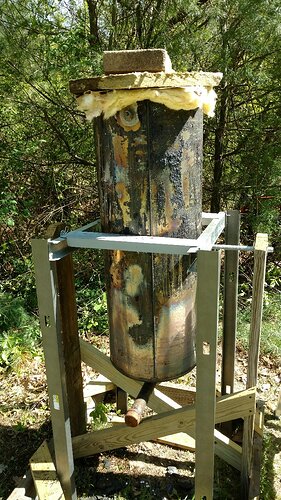

Sweet Success! Giant TLUD with dry, fuel-sized wood chips. Notice clear line between hot (black) and cold metal indicating even progression of the pyrolytic front. This time running properly from top to bottom.

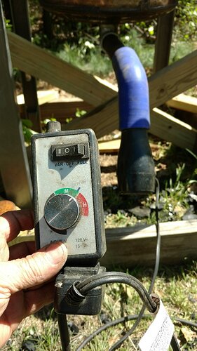

Using a router speed control with blow drier on low.

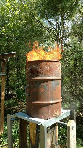

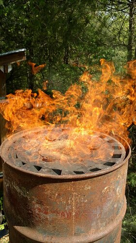

Although there was no smoke I placed a secondary air mixer on top to see how it performed.
Normal flame height without air mixing drum:
The only smoke is from the old styrofoam residue burning off.

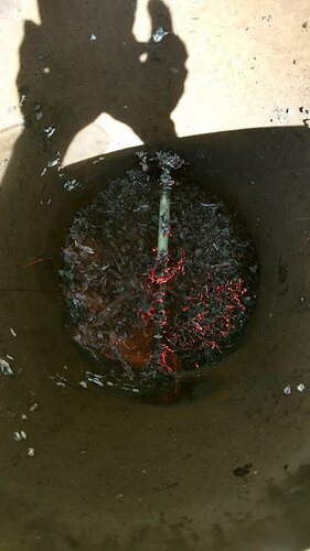

I filled the TLUD to overflowing. With fan assist it lit quickly and the complete burn took exactly 30 minutes. Char level just below the axle rod.
sealed for cooling:
90 minutes after shutdown I can lay my hand on the tank for a second or two. Shields were not needed to protect wood supports.

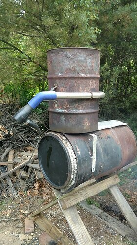

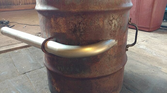

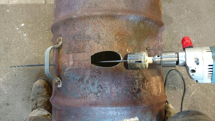

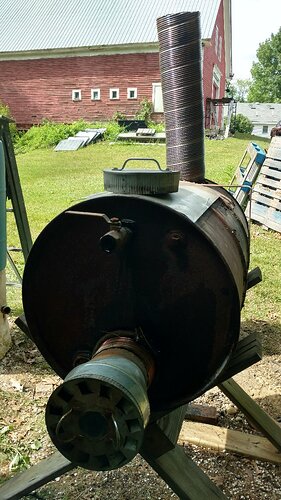

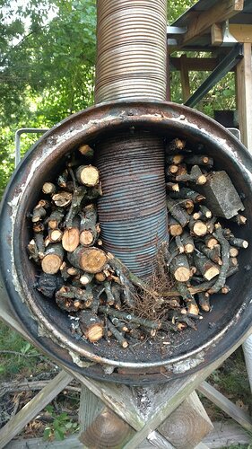

Testing a secondary combustion chamber on my 30 gallon retort. I came up with a way to add a tangential air tube that is tight fitting and stable/strong. Here are some pics:
Dear Bruce,
I remember some pictures of your retort with smoke from the chimney. Is the gone with this secondary combustion chamber? Really like your experimenting with different ways of charcoal production (TLUD, retort, curtain kiln, …) which is very inspiring for me for my own future projects.

Til,
Yes, the picture was taken during the burn. Truth is, the feedstock was still kind of wet so it took about an hour to get this run to self generate (usually takes 20 minutes). So I think a lot of the burnable gas was escaping along with the moisture. The secondary burn can placed over the chimney worked well with very little smoke. The blower helped control the small amount of remaining smoke, but probably wasn’t necessary for this particular burn.
