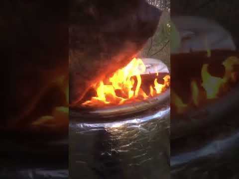

Nothing really, but for me the first time in real. It appears that the barrel is not tight, gas comes from everywhere. Half a barrel with good charcoal. Offgrid system is functional. I scored an old batt pack from small forklift. Doing great with 4000 W inverter and 2200 W saw. No problems at all. With a little work the hookway will be ok, and it really is smokeless. This the best path for me, if I want to make power whitout to much effort, this is the way. Thanks everyone for sharing knowledge.

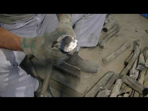

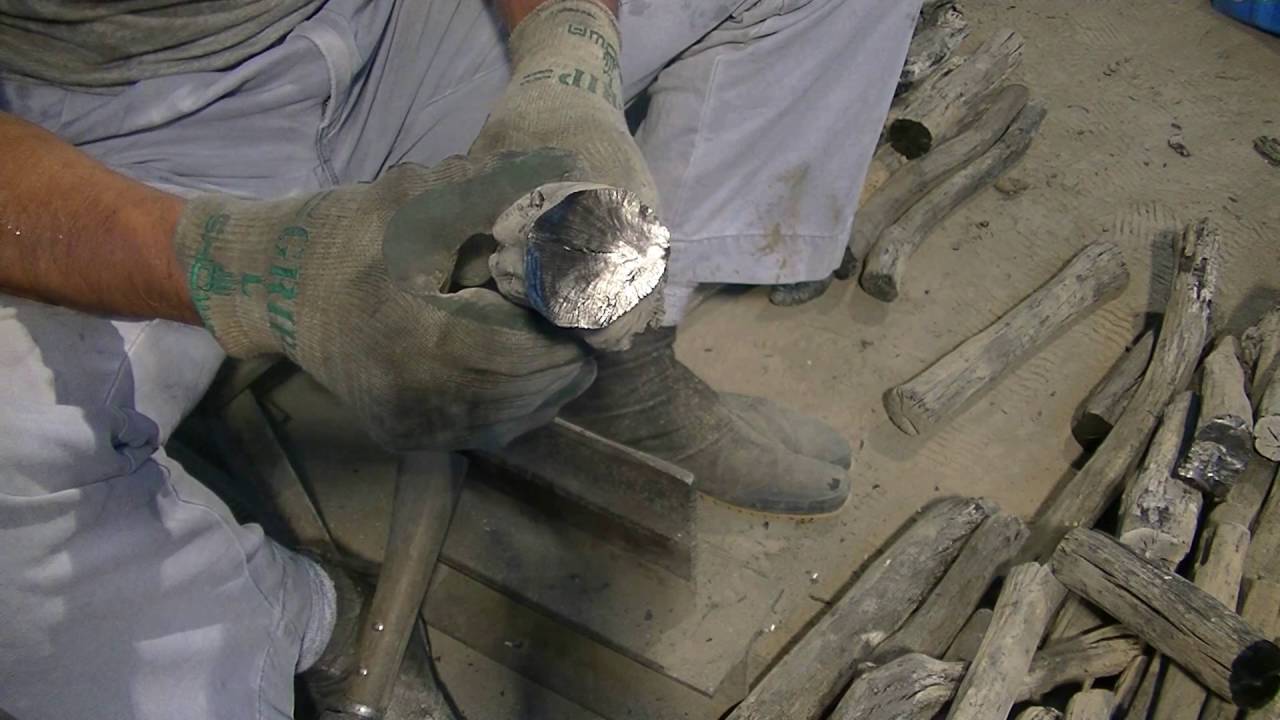

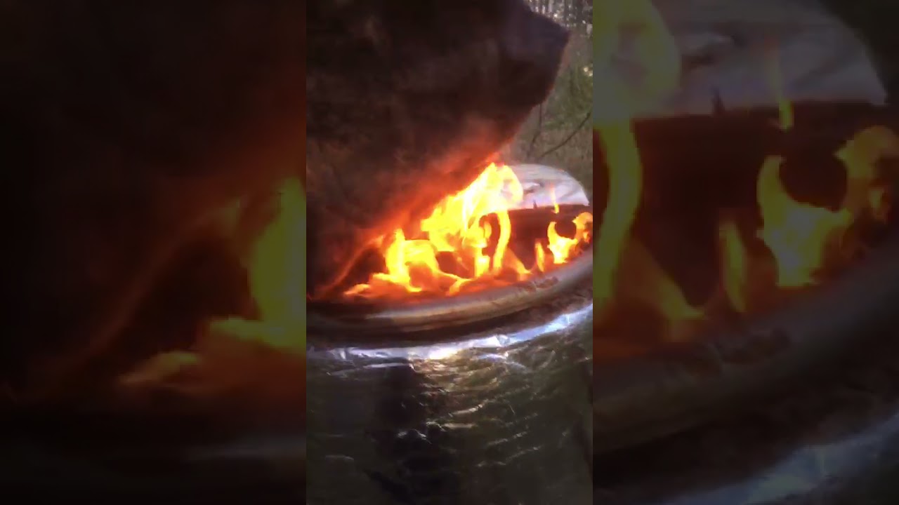

I stumbled across this video tonight. Listen to that roar.
I don’t quite know how its plumbed inside to get the cooked gasses to combust or why it roars like that. The end product is graphite that is pretty darn impressive

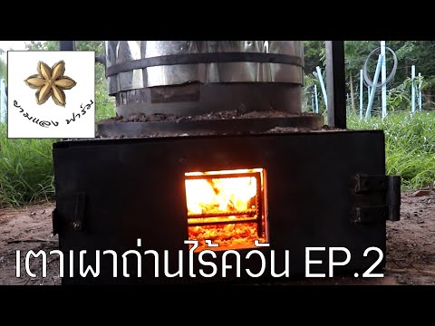

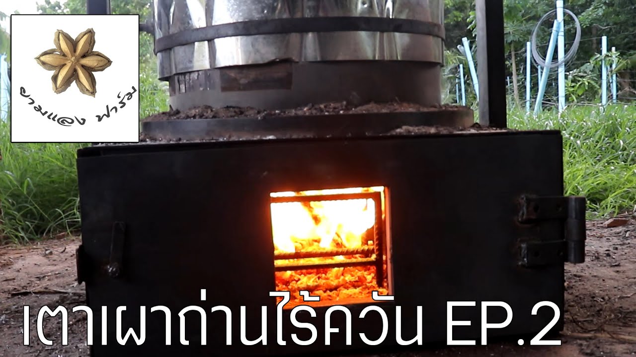

It is the same design as the one I posted in making charcoal without smoke, and was told it was essentially a hookway. the only differences are it routes the gas outside, it has wood in the after burner, and the other one had a long snout so they could get it started it with waste oil.
The large pipe goes straight through. Then the circle around it at the top but inside the barrel, collects gas, it routes the gas out through the square stock coming out the side, and back down to the burner area. He put the wood in the bucket at the top I think to help keep a flame and burn off the excess gases to make sure it was smoke free. It is kind of a neat harness for it.
I wonder what the street value of the white stuff is HA HA HA..
From what I heard it was actually pretty expensive because it is considered like sacred or used for rituals. Notice how carefully he is packaging it and handling it, you don’t do that with a commodity product.
