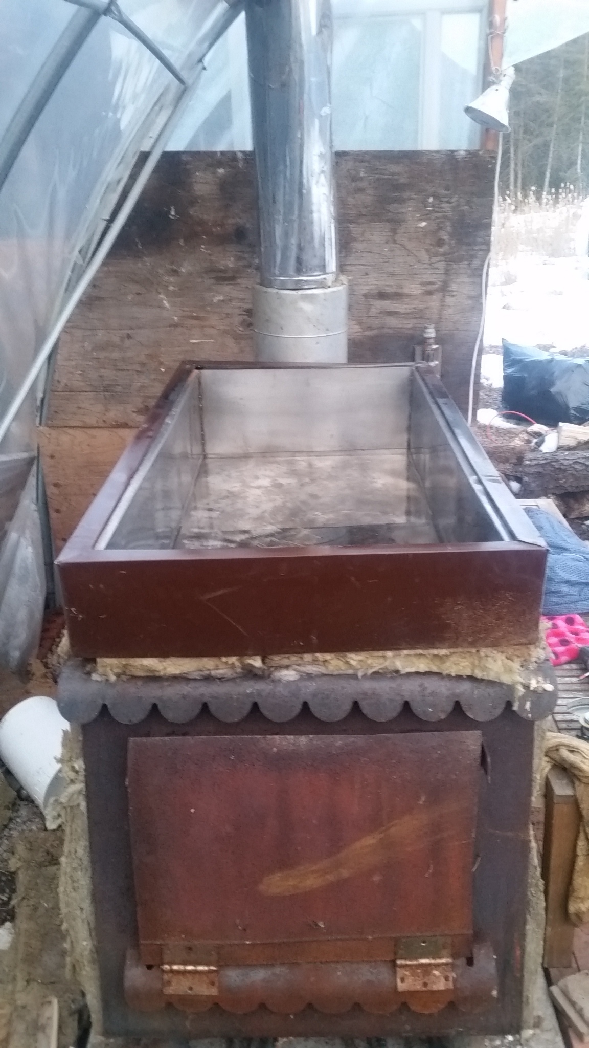

David it seems we both have exactly the same goals for this operation. yes my pan is small but it will boil all the sap I collect in two days down in just a few hours . It is just starting to get efficient when I run out of sap to boil

Pete I love that video. At a puplic Hotspot I think I watched it 3 times last year. You need near perfect control of your sap flow, a reservoir system for sap and stable fire temp though. I like a compromise of trickling in preheated sap to about an inch of concentrated stuff for faster evaporation. I don’finish in the boiler because I built it into the fire box and can’t slide it off…

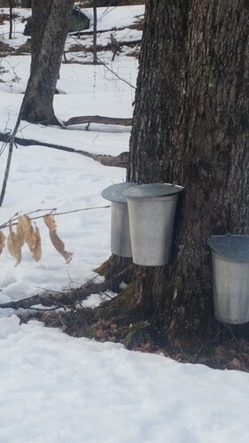

David my average seems much lower than yours. this year I had 32 taps on 14 trees and yielded aprox 4 gallons . jury is still out last of it is cooking now. I would say 75% came from 5 trees while others proved fruitless. So on an average it took me about 8 taps per gallon. This year our season was really broken up. We had a few days here and there over a couple month period, nothing steady. This is only my second year and I have no real taps or buckets. I have been using copper tubing for spiles and coffee cans for buckets. On good days I have had buckets overflowing and fallen off on the ground empty. Much room for improvement. All in all I am happy. I have zero invested and enough syrup for myself and my daughters family’s. I hope to get some real equipment and expand to the other side of my creek where the majority of my mature maples are. I don’t get back there much because I don’t want my dogs thinking it is ok for them to go there, They go everywhere I go.
Hey Jim you can’t beat free… If you ever want to spend some money the plastic taps for the tubing system are only about 30 cents a piece. One of those, 2 ft of tubing for another 30 cents and a used food grade white bucket with a lid and you are in business. I have 50 of the old school aluminum buckets taps and covers but plan on doing the setup mentioned above if I go bigger. A friend of mine does it that way and only visits his taps every few days…

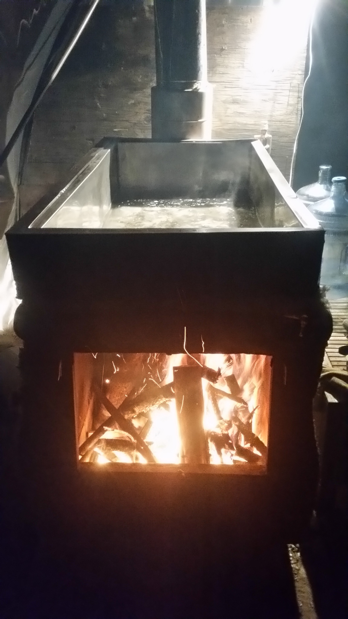

I learned a lower heat will make a light amber syrup. High heat will burn the sugar on the sides and make the syrup darker. I think if I can drop it in at the rate it evaporates it would prevent the burning. This also means the pans need sit on the fire and not in it. So much learning this year and get rewards for doing so. Next year I will at least double my evaporator with a minimum of 4 times the taps.

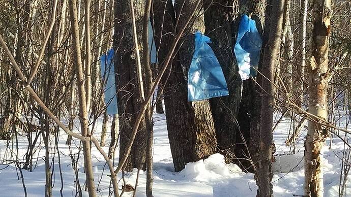

So far I have 80 bags hung. I hope to do another 160.
It’s been a little too cold so far to get any real amount.
It sure is nice your girls get to learn. Good bonding time they’ll always remeber.

My granddaughter and I hung 2 dozen bags last Saturday. Was running good then but not really warm enough when the sun don’t shine. Could be go time any day now though.

It wasn’t up to temp yet but it’s working well…
