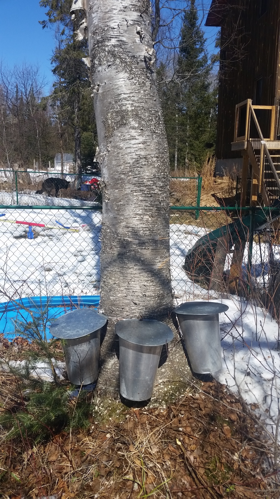

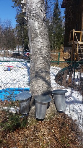

Trying something new this year. This birch is coming down this year which is why the 3 taps… we will see.
Last year I used Tamarack. This year may be a mixture of Tamarack and Poplar. I really want to save the Birch I have for firewood.

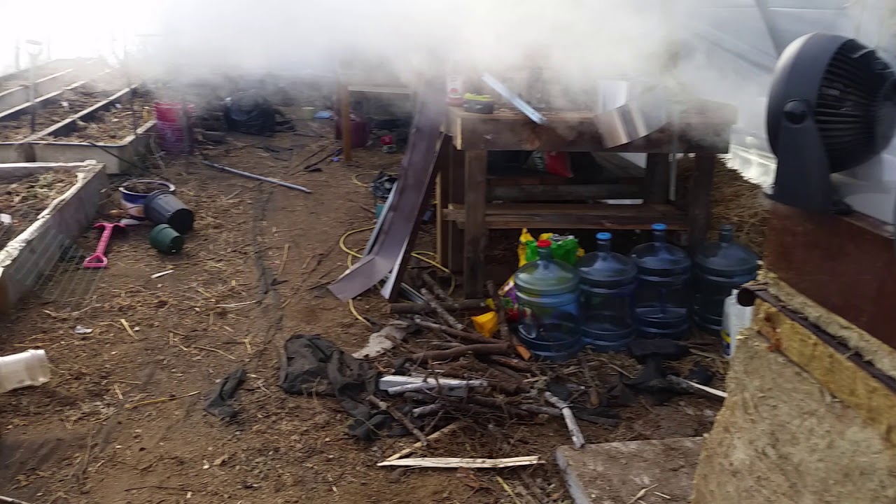

Greenhouse peak with the sap boiler going in the background

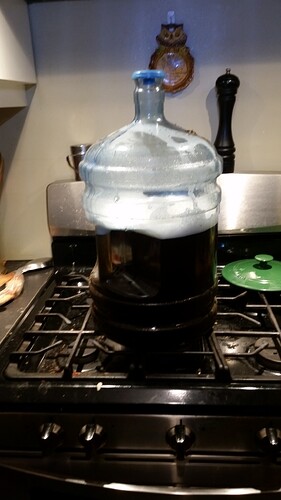

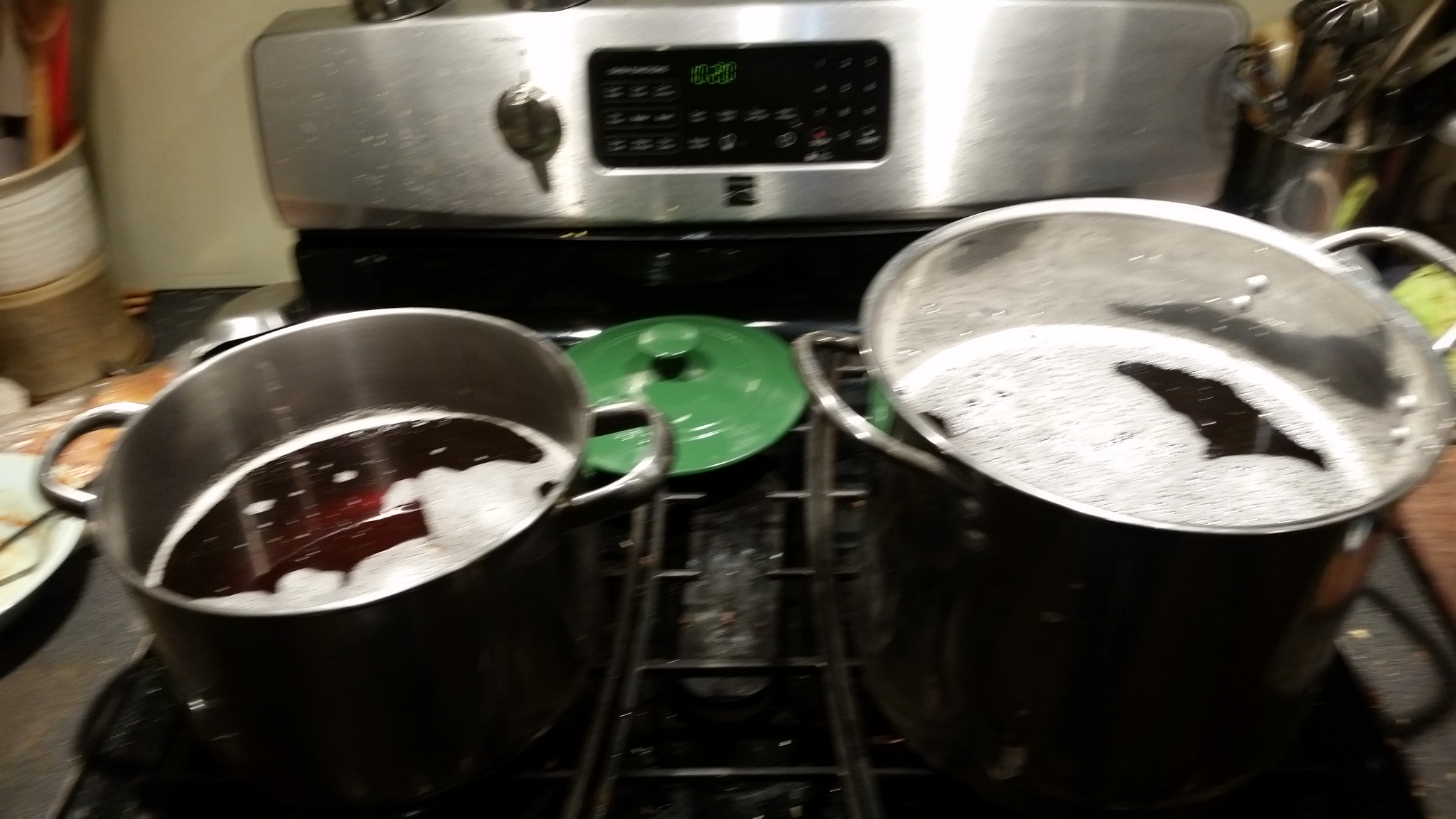

From 160 litres to 12… final boil in the house.
