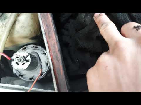

There was talk of the gas blowers in Waynes topic. Here is what l did 2 days back.
Ping pong ball non return valve
The blower l sneaked from wifes small battery vacuum cleaner. She was not happy :smile: but the motor is rated at 7.2v and you can imagine how that looks like hooked to 12v! It sucks like crazy. For how long, we will see…
Kristijan I hope you are looking for a newer replacement vaccum cleaner for her. For your oun sake, and not a new broom and dust pan.
A happy wife makes for a happy husband that DOW.
Great idea with the ping pong ball non return valve setup. So simple.
I like that ping pong ball idea too- but looking at the picture I cant quite tell where exactly the gas is going? It seems that you are sucking on the pipe to lift the ball, but where is the outlet (or is this just a test?). I also advise caution when it comes to disassembling your wife’s things, and on Valentines day no less!
You’re treading in thin ice, my friend.
No worryes, l allready payed her back by taking her out for dinner :slight_smile: Drove there on wood, wich counts double l guess :smile:
Carl, the gas goes nowhere. Its sucked and vented out trugh ports near the motor. On top of the white houseing. I built a cover to vent the gas away from the car but l am not sure l will install it, its more prone to clogging the motor with tar, condense and dust that way.

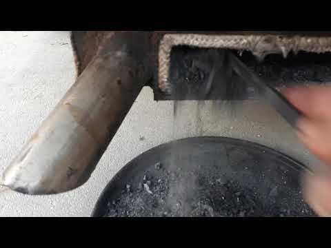

Bob no, the only moisture trap s the cooler being so low. But with practice l figured out eactly how much water l must add to the charcoal so none gets by in the first place. There is only dry dust in the cooler/filter now.
JO, no, the filter box. Yes l stiched the towel stronger at home and filled in ss dishwashing pads for support.
