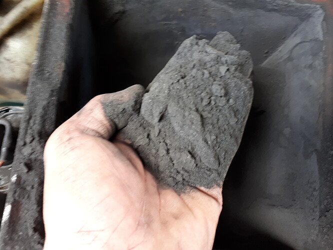

I filled 2.5 gal of petrol in last week. 150 miles driven and the fuel still isnt used up. That has to put a smile on your face right?
Yes l use some wood mixed with the char or l mix a cup of water with every bucket of dry char, 2.5 gal. It sees to be just right so that no condense forms and the gas is of best quality.
