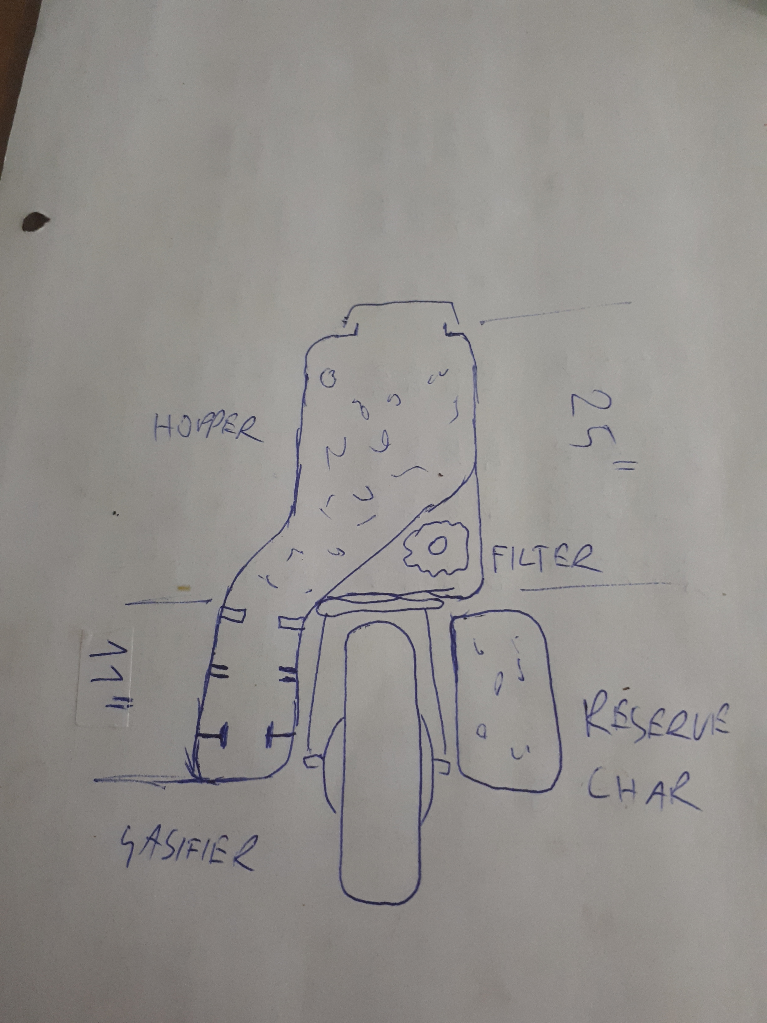

As much as l love the updraft gasifier for its simplicity, years of testing out different designs lead me to the design l currently use, a downdraft hybrid of the old WW2 style gasifiers and the WK gasifier. It gave me best performance of all with a minimal size package. It is more complex thugh.
Anyway, if l wuld be building, l wuld make something like this:
This is looking from behind. With this setup you are looking at a range of about 60 miles with one hopper filling + reserve char. Thats a rough guess with 12x12x25" hopper.
Wow Kristijan, your drawing looks like a person sitting on the back seat of a motorcycle.
