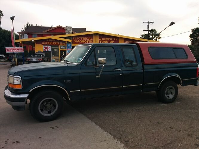

I bought this truck about a month and a half ago. it only cost me 2k and ive had to replace a bit (belt, tensionor, shocks,starter, locks and ignition etc)
im an aviation support equipment technician in the navy, which is something like an auto mechanic
i just went to welding school when i bought the truck because it just seemed like the right time to finally do this!
im hoping very very soon to start the actual build!
after a bit more fixing up the truck!
hopefully i start and finish it before my membership runs out haha!
its also was the last year i could get an auto loan on through my bank, which happens to also be the last year of obd1 and makes it emissions exempt in my home state of Illinois where i will register it even though right now I’m stationed in San Diego California
