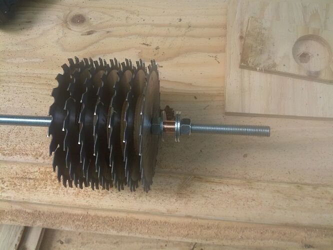

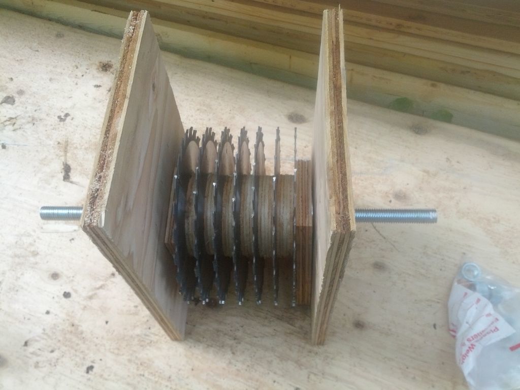

Some pics of the grinder… Early days
Is that plywood used as spacers between the blades?
Hi Bill, yes there are 3 inch cutout pieces between each blade. The large square pieces are 2 of the sides of the box to be.

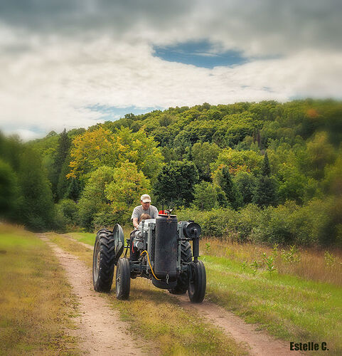

My mom came to visit and she is a real photographer. Here are a few quick shots; nothing new but the light was great…
Very nice pics!
The bottom looks like calendar material.
TerryL
Terry’s right, definitely a great calendar picture. That needs to be submitted somewhere.

Hey David ,
I’m with the guys above . The picture needs to be hanging on the wall !

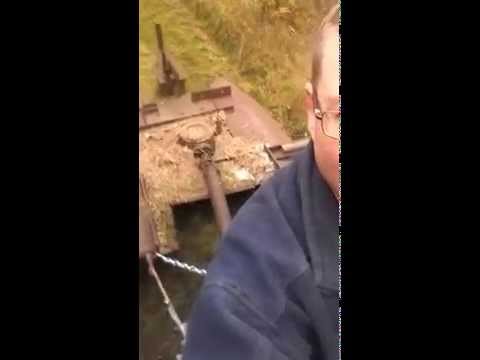

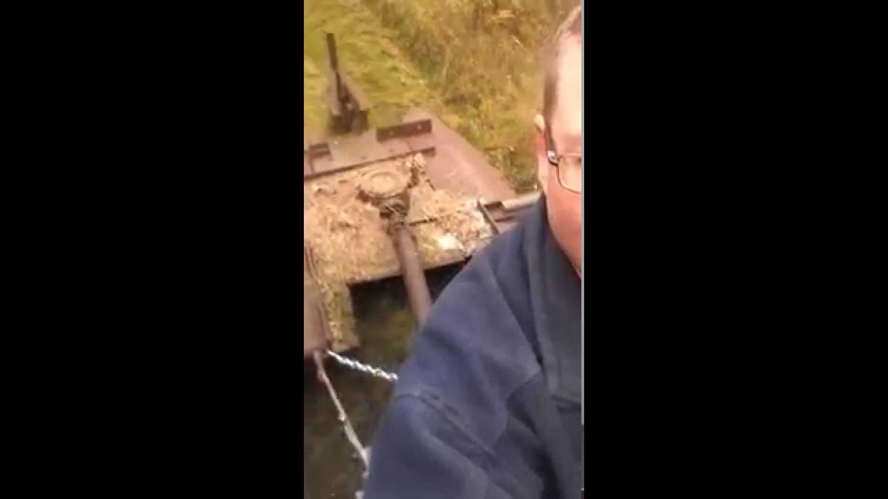

Did a test run today with a friend’s bush hog cutting an overgrown pasture. All things considered it was a good test. The power is less then on gas for sure but it can still do the job easily. The cutters were dull, the grass was heavy and very dewey; about as heavy cutting as I’m likely to do. Consumption was about 7.5 gallons of softwood charcoal in a little over an hour for an equivalent of about a gallon of gas. On hardwood charcoal the run time would have been twice that. So far I have about 6 hours on the tractor in the current setup. Doing the gasoline test after this was filmed I managed to shear off my pto shaft end… but that is another story.
A short video here:
Thanks for the video David. Sounds good on charcoal.
I like it !! :slight_smile:
Good job on the fuel consumption numbers DavidB.

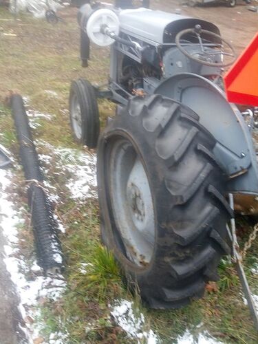

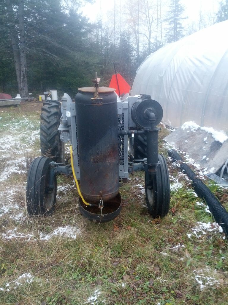

As the frost creeps in more and more , plowing gets harder. I managed to kill one of my long suffering rear tires thus ending the idea that charcoal gas lacks power!!! Wrap up for the experiment is 11 hours of heavy run time doing everything a tractor should be able to do running on softwood charcoal consumption anywhere from 5 to 10 gallons per hour depending on load. There has been no ash removal so I expect a nice slag cake in the bottom when I empty it. She’s back home now and I look forward to the next mods. The tank paint is showing some wear but that is as much a review of my bad prep work as the paint. Fun fun fun…

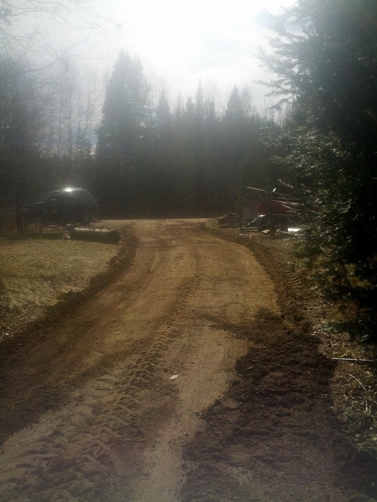

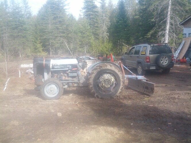

Spring has sprung, I traded a snowblower for a good back blade. Ran the tractor today on charcoal. Graded the new driveway to the garage. Working great, wish I had more time…
Finally got to a real computer for resizing. Not liking this new site issue but beggars and choosers and all that…

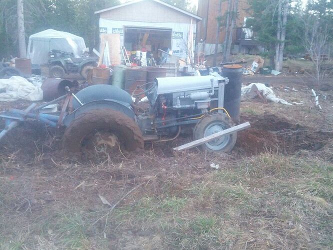

And that in a nutshell is why you should wait for the ground to dry up a little more…
