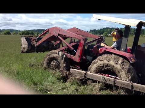

My charcoal tractor
You must have good top soil. That could never in Arkansas, too many rocks. Ha!
are ya stuck? Lol…
Interesting tom…
I ended up using one of those 4 ft long jacks. Picked it up at a yard sale a few years back dangerous but very powerful. I put the jack on each rim jacked up about a foot and threw firewood into the ruts. Spent less time working on that then ramming it back and forth the night before. Next solution was going to be ask for help and boy that would have sucked; wouldn’t have heard the end for years…
Carl most of my place is a great big bog and with spring melt I was asking for it. Generally the soil around here is very poor with granite close to the surface.
