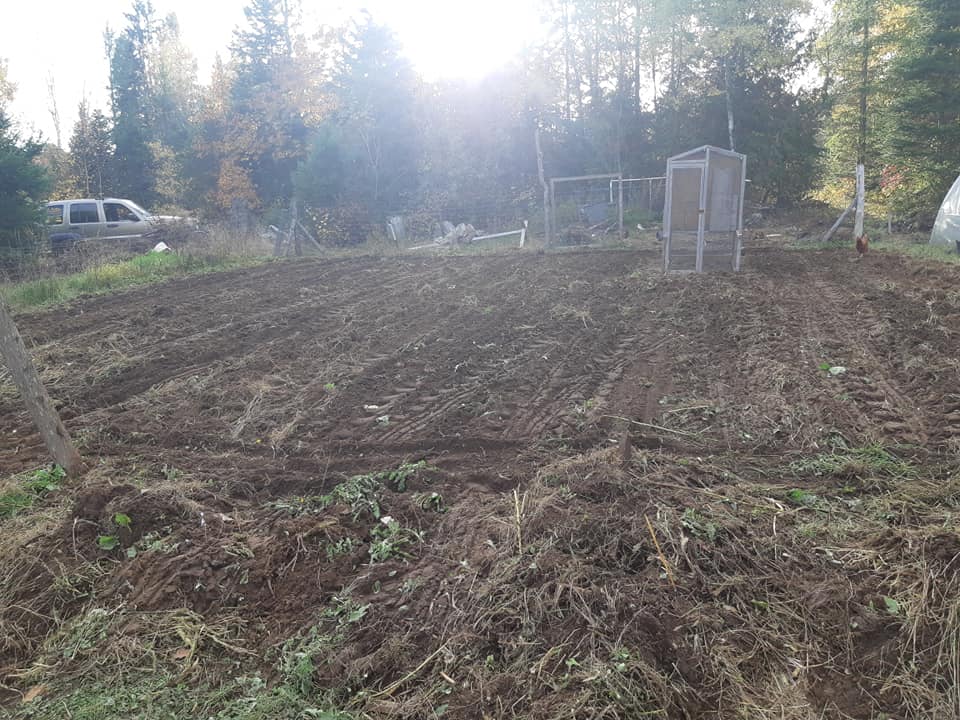

boy oh boy… over 2 years! I’ve been away from this for far too long. Dusted everything off, rejigged everything filled it up and did some cultivating today. Sure was nice to get her running on charcoal again.
What are you planting this time of year? It looks like your tractor did a pretty nice job.
Not planting just tearing it up. The garden suffered severe neglect this year so lots of overgrown weeds. By tearing everything out I expose fresh soil, knock them all back kill a lot of roots and start fresh in the spring. The weed seed should sprout early so I’ll till it again in spring… plus it’s fun!
Part of my garden suffered the same fate. I tilled it down a while ago and planted a cover crop to avoid erosion. I thought maybe you were trying to do a late planting of potatoes, turnips or wheat or something.
I think from his pictures that DavidB get to be one of the snow-carpeted winter gardeners.
