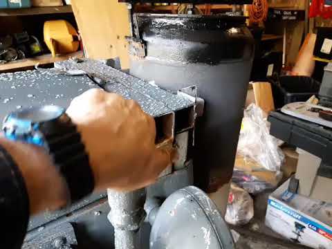

I’ve been thinking about a new filter lately. The 5 gallon bucket and gamma lid were ok but The problem has been I’ve never really had much success with the cyclones as the dust seems too light or is moving too fast. The idea here is that in stage 1 the gas goes into the steel tube and is forced to turn just like the cyclone. This will also cool the gas. The rod with the scrub pads adds turbulence and forces some dust to stop. The it goes into the upper filter section where a pool filter does the rest. Hopefully it all comes together very soon…
OK, now I know why people ask for a sketch when i post an idea for some new idea. You even gave us some pictures, but I still can’t get it straight. I like the idea of a two-stage or three stage filter.
Stage one: dirty gas enters at the top of the cyclone either tangentially or with a spiral air ramp so dust can be taken down to the bottom container (preferably through a restricting ring with an opening about the diameter of the inlet). Then the cleaner gas exits upward through the internal outlet pipe (preferably with a diameter larger than the inlet but smaller than the cyclone diameter).
Stage two: gas from cyclone passes through scrub pads.
Stage three: the gas is filtered through the pool filter.
Is the cyclone in the bottom half of the steel pipe and are the scrub pads in the top half? Is the cyclone entrance pipe located between these two sections? is the entrance pipe tangential or do you have an internal air ramp?
I like the way the paper filter hangs along side the cyclone.

Hopefully this helps clarify things a little… Here is a hot restart and a walk around. Basically the front of the long metal lower tube is the cyclone action/cooler, the back half has the rod with the copper scrub pads. Then it goes up to the Spa filter which is waterproof and washable. The whole thing is tipped back a bit for condensation to drain to the end… My charcoal is damp right now so I’ve already pulled some water off of it. It has less then an hour of time so far… Some stills for Steve soon.
