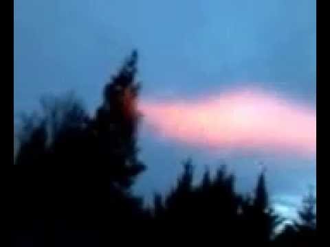

I have a new hay/foam filter and a new cooler that seems to work great. Here is a video of my new setup w/ the exact color flame I was looking for. If I’m wrong about this, please let me know.
BBB Gordon
Link doesn’t look like it’s showing up. You may have to go to Youtube and see my channel “Gordon Ooghe” See the latest vid, thanx
The video works here, but I went and subscribed, then while reading the Youtube comments I notice I am subscribed to the first four commenters, all builders.
Looks like very clean gas to me but then again I am new to the woody variety
