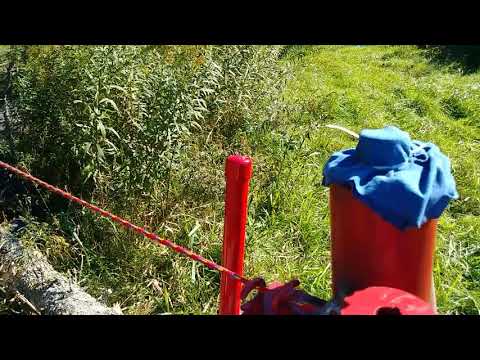

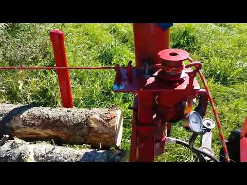

This is the second self load with rear arch. Next problem is to unload. Thinking a pull block hung up a tree and pull the stems off.
And here is a video. Sorry, was holding the smartphone and trying to run the winch.
You da man Jeff. I’m amazed that the tree moves instead of the tractor.
Thanks Andy. I use a fence post to lock the arch in position. It gets jammed between the arch and rear wheels thus braking the wheels. The harder it pulls the more the braking action. However I am sure it can slide back and I might have to modify this.
