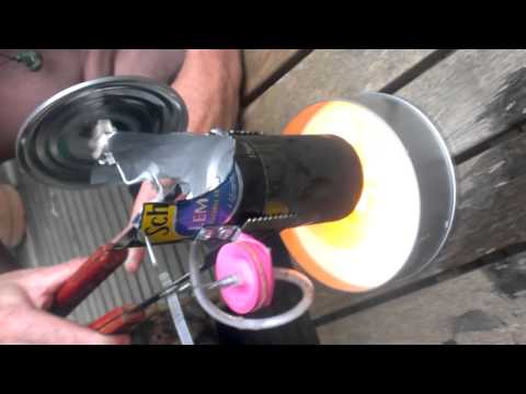

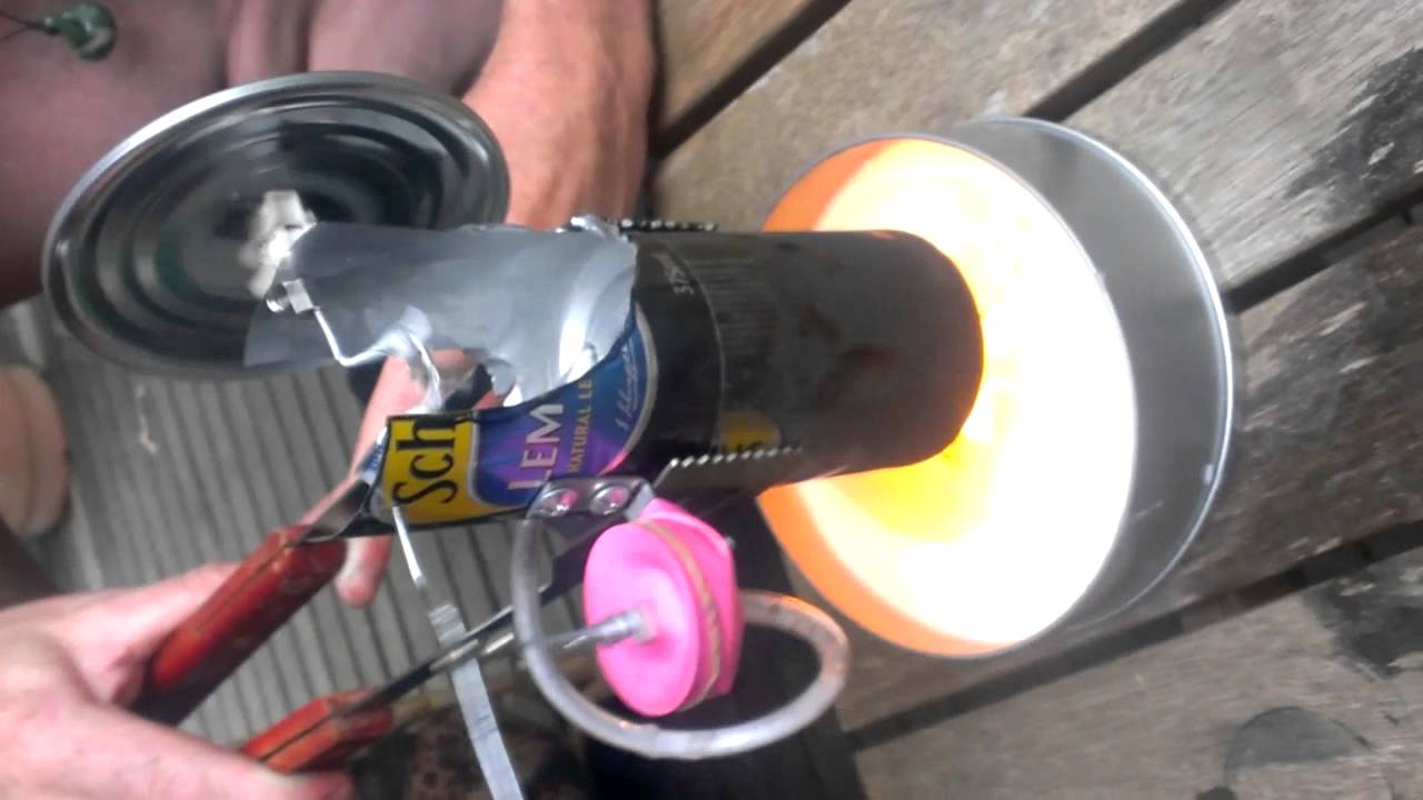

Yeah i have noticed that .im a sort of both feet in (my mouth usually) lol kind of guy and have a very good understanding for making engine related stuff . here’s a sterling engine i built with my boys in a few hours just because when i asked one what they wanted to do that arvo one said I DON’T KNOW what can we do . i said anything u wont and he said WELL WE CANT BUILD AN ENGINE .lol CANT WE I SAID and this was the out come . in the end i got sore from holding it and just put it down .
That’s a very good engine.
