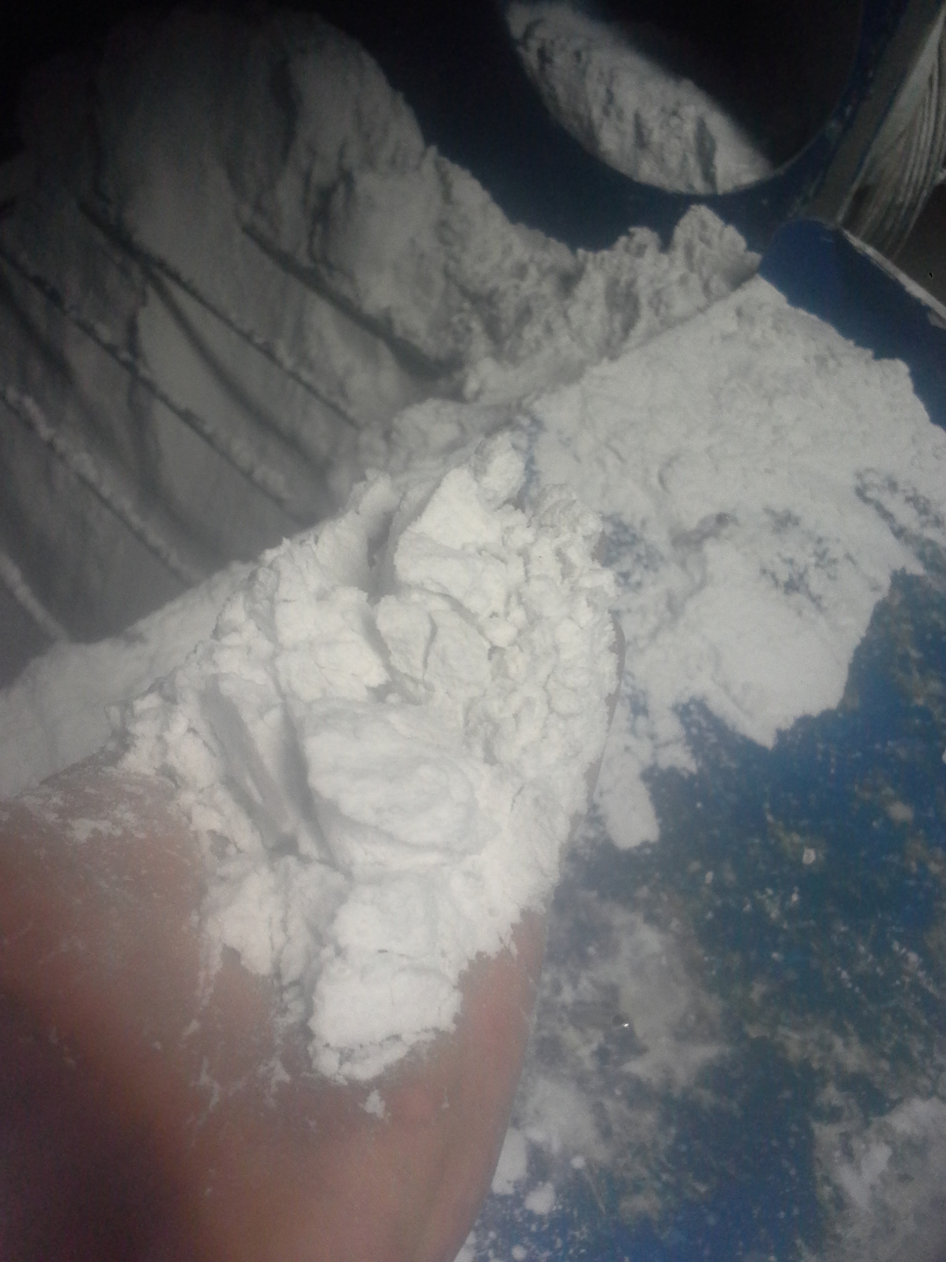

Its called “filtration aid agent”. Its basicly perlite flour. Wery light and insulative. If touched with a flame, it glows white without phisicaly changeing.
I have dumped a few thousant bags in the dispensing machine in my time here, only now realised this has potential in gasifier related stuff.
At filling the new hearth with fresh charcoal, l usualy make a ash cone first out of some ash from the stove.
Do you think its worth to try and make it out of this perlite flour? Or will it just blow away, since it doesent get sintred as ash does?

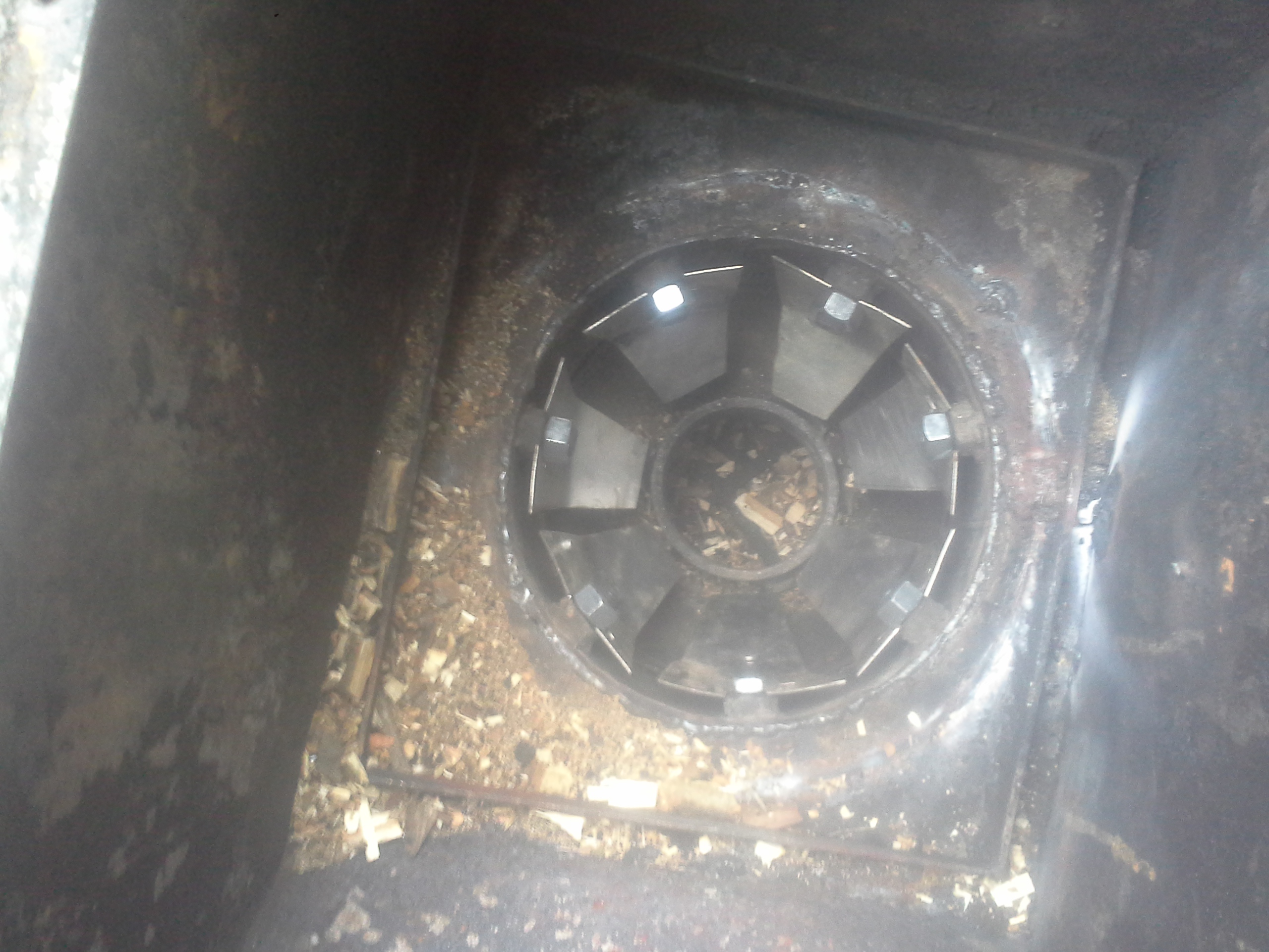

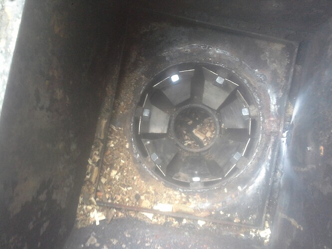

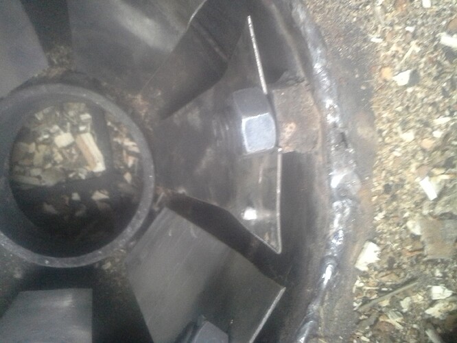

I decided to give this a try first, those are ss sacrificial plates, extending all the way to the restriction. The idea is for them to reflect heat, support the ashcone and enable a smooth flow in the hearth. If that doesent work, l think l will try the perlite flour sprayed multiple times with sodium silicate solution (thanks Dave).
Hi Kristijan, my mild steel plates warped down by the reduction zone. Is there any way you could weld stainless steel pipe in between the pieces at the bottom, and have the pipe go to the out side of the reduction pipe? It wouldn’t even have to be stainless steel pipe.That would keep them in place. With the ash packed in behind the plates that should work.
Kristijan,
A couple more suggestions

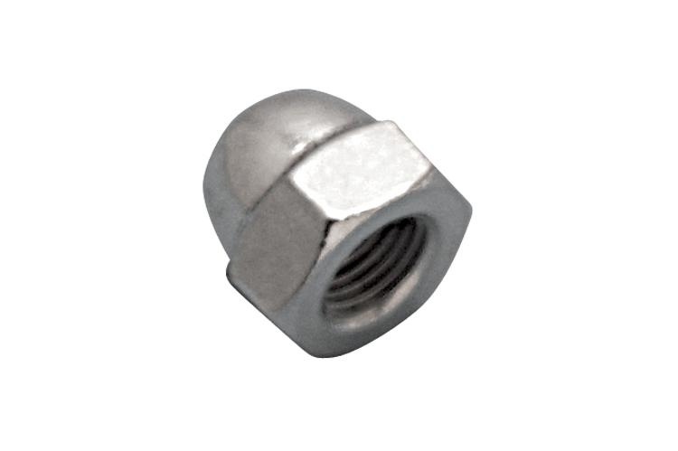

I would screw in or cut off the bolts/nozzles flush with the nuts + copper paste on the threads.
The sacrificial plates I would leave the way they are. If any warping occurs in the lower region just bend them in to hide in the ash cone or cut the lower halves off. The ash cone will protect the lower half of the firetube anyway.
Or… similar to Bob’s suggestion: A larger diameter pipe around the restriction could be a lose fit. Only high enough to keep those fingers from warping into the flow path.

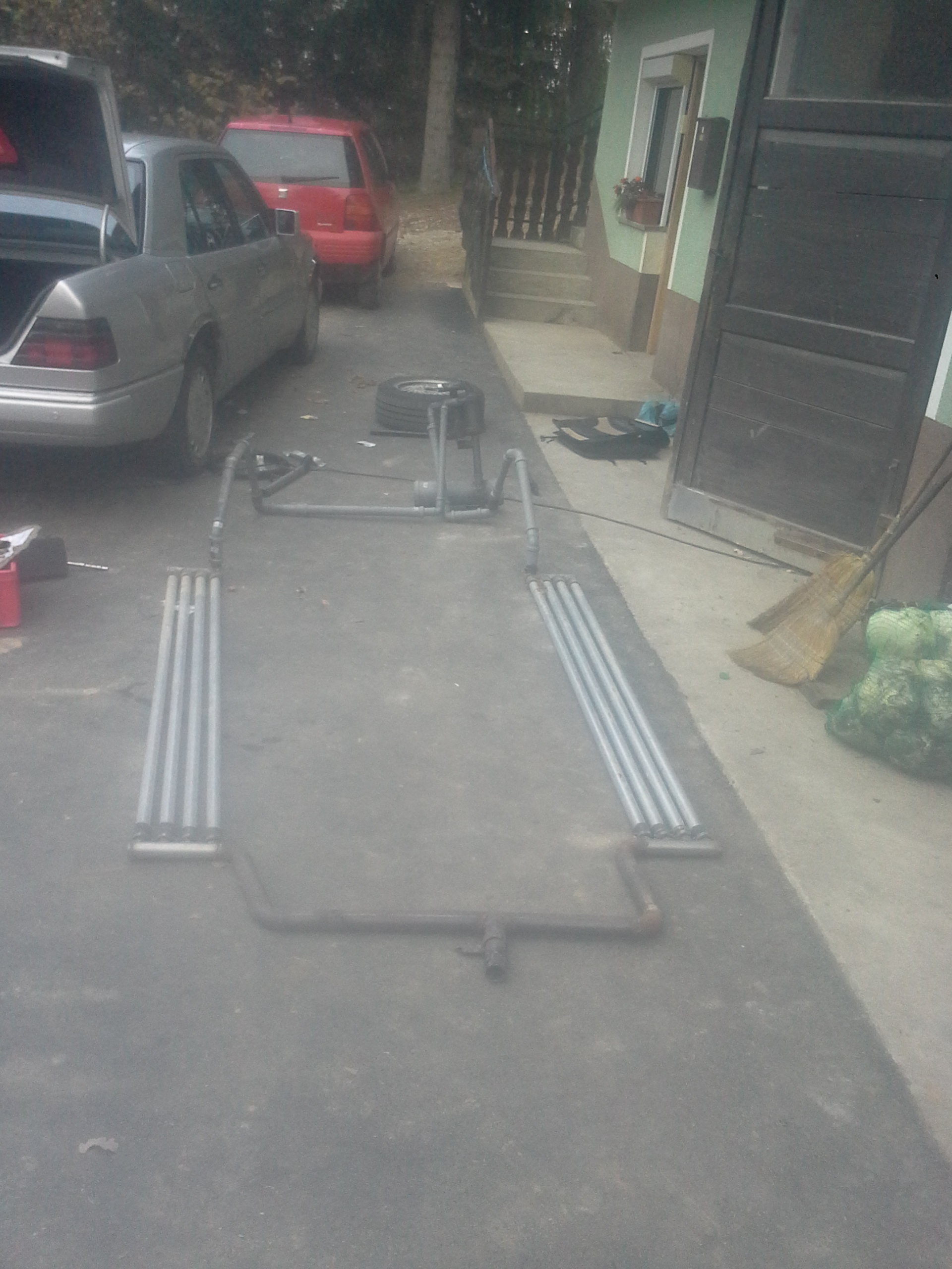

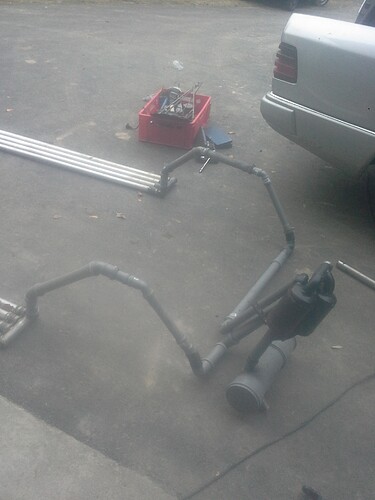

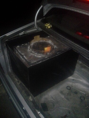

Been buissy last few days, pig slaughter day and anual technical inspection on the Mercedes, meaning l had do dissademble and reasemble everything wg related. Glad thats past.
@TomC, since l hadthe scale out from slaughter day, l weighted the gasifier&hopper. Thats 60 pounds so l think JO and l culd smugle it trugh airport inspection

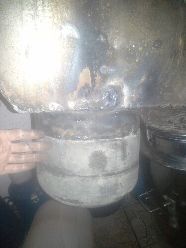

Here is a pic of my sooty hand next to the hearth.
