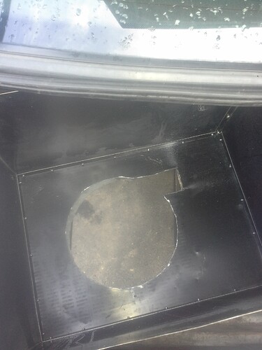

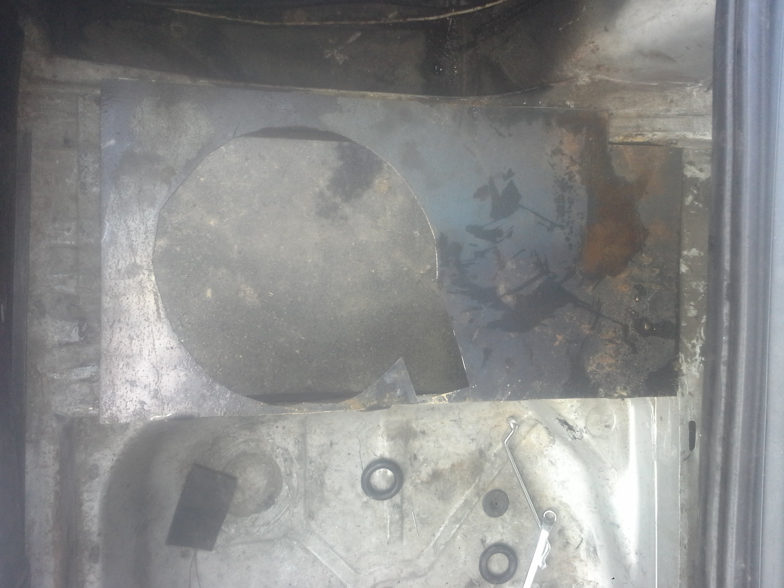

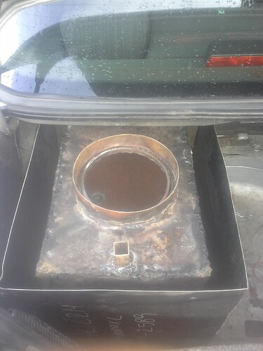

Afternoon shift caught me about 2 hours early to finish installing the crude system, but here are some pics of todays instalment
The gasifier suporting plate

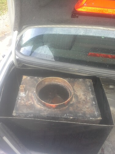

Aluminium box lined up with it, 90° rotated
Gasifier installed

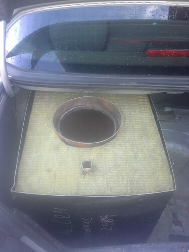

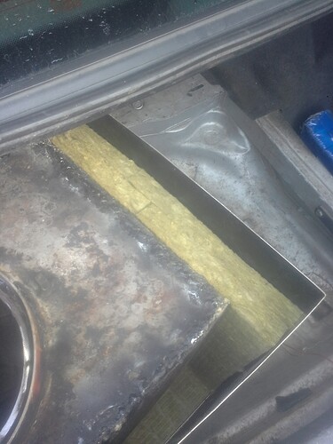

Rockwool plates installed. You can see the lighting port on top, ant it might aswell be the air intake. Some air circulation in the insulated alubox shuld aid the cooling some
Rotated 90° in the right position

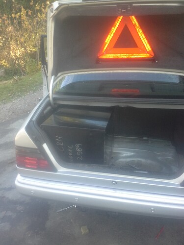

Voila! Top lid on, trunk compartment finished. Now its just a matter or crawling under the car and connecting the gasifier-baffle-cooler.
Pretty box! If I didn´t know I would never had guessed it´s a gasifier in that last pic.
Hey JO, when Kristijan get it all put together, and running. I’m giving him my vote for this years Stealth Wood Gasifier Build Award.
The SWGBA 2017
