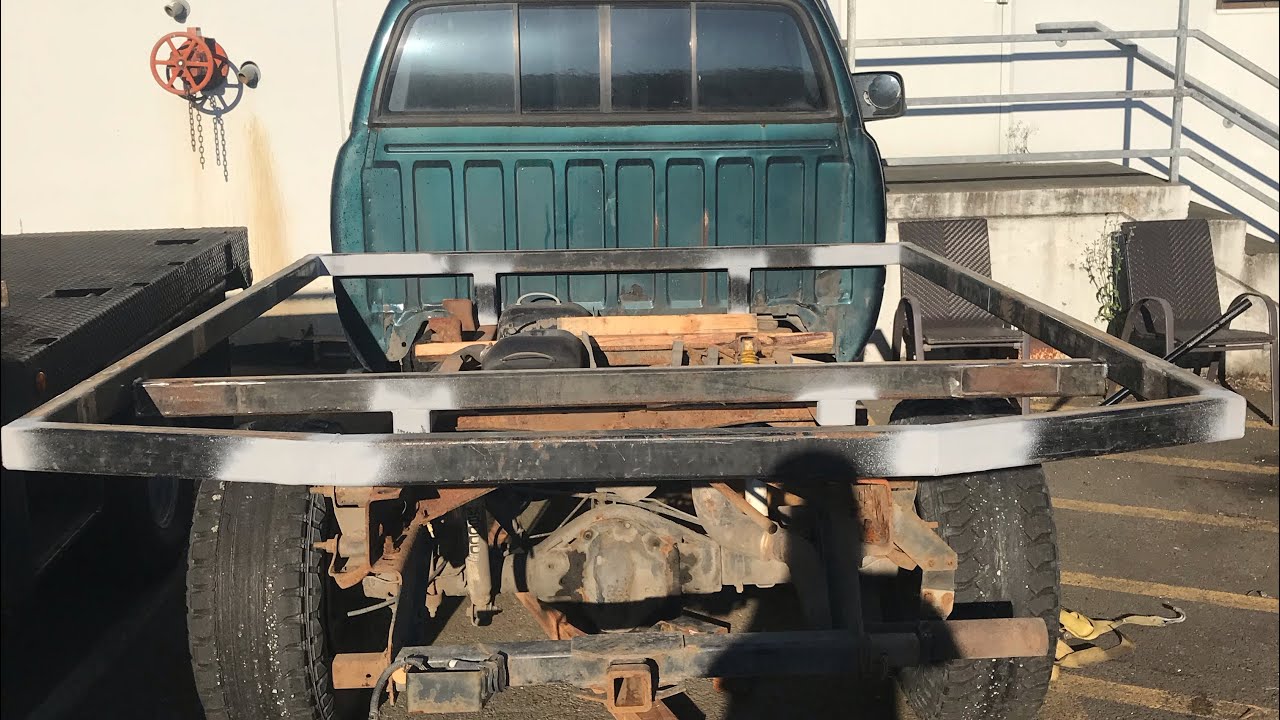

How do you know for sure that this frame and the other truck frame are the same? And they have not gotten a little out of square because of use off road, hauling heavy loads, ect…?
Dodge used the same bed dimensions though all the second gen trucks and I cross referenced every flatbed manufacturer I could and all beds 94-2001 are identical dimension and bolting if it’s a little off from road stress/ chassis flex I’ll make it fit, I’m to hard headed to let it beat me :joy:
