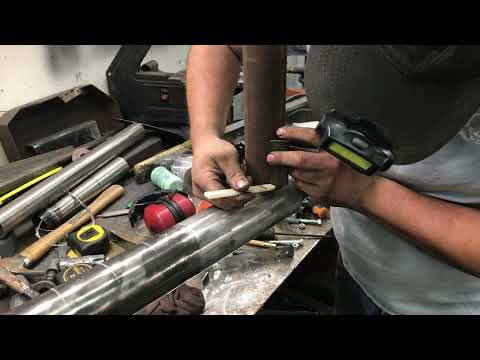

New project! Normans next gassifier truck
That looks like the way too build cooling racks, with lighter tubes clamped in later, those main connectors should last at leiste 10 years.
That’s my hope, I wasn’t able to find stainless but this came along and I think it will be quit a few years before it rust out from the inside. Rear post should be cool enough to double as anchor points to tie anything onto the bed. Thin exhaust pipe 14 gauge for the tube in between should have adequate cooling/condensing capabilities I think

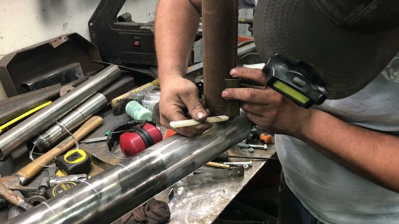

Is that center post 2" or 3"?
Edit: Nevermind you explained in the video, just had to watch it again.
Yea it’s 3ā€ but that scribe tool works for any size pipe

That piping does look good as it is. Would a clear coat take the heat? Your scribe trick is good. Normally if I want to do a perpendicular pipe to pipe I will just hole saw out the larger pipe an eighth larger and just slip the other pipe into it. I guess the downside is if you want a smooth interior surface on the first pipe.
