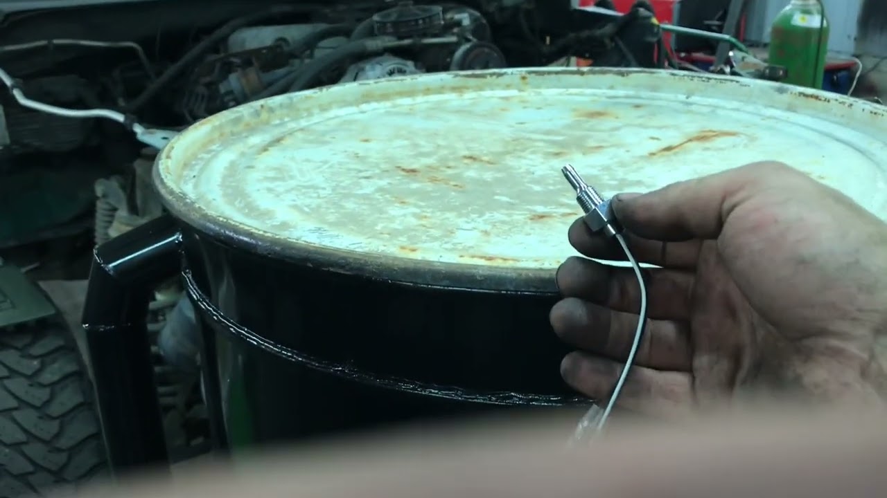

I have learned to use more spring tension to the front of the hopper ( closer spring spacing ) . If you have a burp it might not get condensation on your cab .
I did that on the Toyota and Iāll be doing the same on the Dodge. Only issue is the lid Iām using is a rather tight fit on the drum so Iām a little concerned it wonāt set back down after a fart, or might even bang. I have peened it a lot and it is still a super snug fit, like to get it to sit on the hopper completely it is a good palm smack, and a little difficult to get back off without a little prying

Hello Marcus, you are doing a good job, but you already know that, if I were you, I would add an opening in the middle of the lower part of the ash container, so I would have the possibility of easy installation of the lever for shaking the grate (as JO or Ben Peterson gasifier did). or maybe you can try the central nozzle. Or you can simply leave the editorial closed
That is one reason Iām happy with how I mounted the gasifier, it will be very easy to add on anything later everything is accessable easily on the lower drum, easy to get to the grate, I want to study your tractor design more and understand it better before I attempt this. On the Toyota I donāt have a grate shaker, I just give it a good shake at each light up and it does well for 100-150 miles. I think I e reason I slip so much char in that truck is my grate is only about 13" diameter, a lot smaller then most flat stainless grates in other wk builds. Iām hoping this big 15" grate Iām working on wonāt slip as much in the V10, holding it up and this one will have a little larger holes I have been studying back everyoneās grates and there are a lot with bigger holes then my Toyota. I lucked into some grate material today, a conveyor I removed a few weeks ago and did a video on had stainless 1/8 plates all over it I welded a few together today and started armoring the bottom of it to prevent the potato chip we have all seen. Got cut off finishing it though, band saw donāt care if itās cutting stainless or index fingers. Whoopsie. Wife is going to be pissed, Iām wearing one of my nicer shirts today and got blood all over it running to the med kit on the shop wall to get it wrapped up. Not serious, but a serious reminder that every time I try to work fast, my fingers donāt move as fast as my brain thinks
