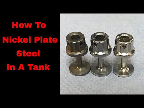

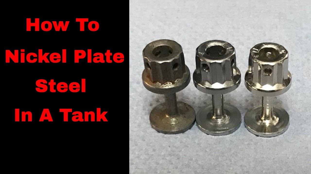

Since you mentioned electrostatic, i went all the way to electroplate⦠![]()
SO I looked it up, Believe it or not, it is possible to electroplate nickel with a 1400C melting point onto steel at home. It has to clean it down to the metal, and it needs a big enough tank to put it in (or for just the inside, it might work by filling with solution with caps over the ends), etc etc. No I donāt expect it to be done unless it is all out. Once the nickel is plated on, then it is easy to plate gold on it. Who is going to argue with someone that has a gold gasifier? ![]()
When I worked as a gunsmith we did nickel and gold plating once in a while, it is not hard to do at all. But fitting a 9āx7ā flatbed in a custom made super sized vat would be a little tricky. But since building the Toyota I think a gasifier should either be black like the tar it makes because it will inevitably get everywhere with a guy like me running it, or stainless so at least it can be cleaned and still look good. Black is my preferred color for most things anyway, it can get pretty dirty before others on the road can really tell itās dirty. Another need for me is must be able to take a pressure washing and hold paint. All my trucks get worked as hard as a truck should and looks just arenāt critical to me. Scuffs, dents and scratches tell a story of this aināt no mall crawler garage queen show rig. Here we work for a livin!
