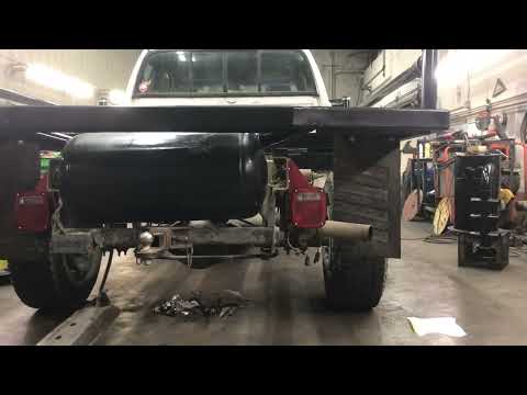

Put the drain where you planned it. The tank tipping the other way is good, it will keep the drain from plugging up. When I go to drain my tank it is always plugged up with black ash,soot, small char pieces. Yours will be clear when you go to dump it at the 2" drain cap.
Your mistake was a good one this time. I always tilt my truck to the drain side to dump it anyways. On my next build I will make my tank tilt just like the way you have it on yours. I put a water hose up the drain to clean it all out.  Good job.
Just the other day was the first time I had to flush out the rear tank on the toyota I had noticed the water coming out at a very strange angle so I stuck a finger up there and discovered about a 3/4-1" layer of sooty slush on the bottom of the tank it flushed out easily with the garden hose. Its almost dead bottom of the tank though and i only had it partially clog with char once before
I didnāt empty mine for a while one time had char back up into the back posts of the rails on both sides. Talk about high vacuum, where could it be from I was wondering.  Lol.  Yup back tank was full of ash , soot, charcoal too had too use a water hose to clean it all out. I learned not to do that again. Now I am like you clean it more often and save myself from the big clean outs problems. That reminds me it is time for another clean out on the truck. Keep it cleaned out and running good DOW.
I have my clean out at a 30° angle at the end of the tank. Easy to push the hose up into the tank and get to the 2" rubber cap.
I have taken to weekly char dumps and bi weekly full wash outs to keep things clear with my commute being so long it gets clogged up very quickly

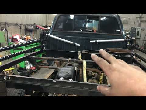

I started on my heat exchanger this morning. I need to cut in my crossover tube and my gassifier is done, minus a coat of paintš„³
I just finished another coat of paint on my cooling rails, hoping to get the bed stabbed on tonight. still need to finish lower barrel insulation before it can get all assembled and then gauge hook ups and finish decking the bed. I put on just enough boards to cover the tires so it will be road legal and ill have to ziptie the stock tail lights onto the bed for the moment until I figure a back bumper out, gotta keep it street legal even while Iām installing it all on the truck
What are you going to use for insulation? Couple layers of corigated steal? Or are you wrapping tube with some type of ceramic?
Same ol metal roofing as the toyota got, and a 55 gallon drum liner to keep it all in place. Little trick covering over the top of the crossover cutout its a thin spot so I want to keep it protected best I can. I also layed in a drum lid trimmed down in the bottom of the barrel so it has a nice smooth edge transition to the ammo dump can for char to come out of easily
